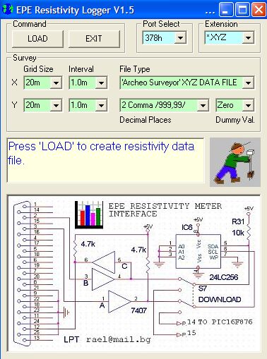

I have software working under XP using property Win95, 98 compatibility, making "Snuffler", "Archeo surveyor" format data file (read data via parallel port).Attached Files

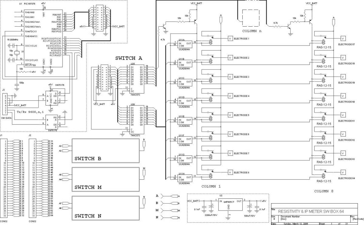

In the moment I’m working on the software for my project “IP and resistivity meter”.
I think the EPE RM is not very proper for multi-electrode resistivity meter. We need much more precise voltage and current measurement to obtain good resistivity interpretation image.
To measure a high apperent resistivity of sends, rocks, caves in large electrode area, we need high transmit voltage.
For the purpose of IP, and high conductivity soil, we need high transmit current. To achieve useful resistivity image, we need much more precise instrumental amplifier, and better ADC and DAC.
For the purpose of the RES2DINV calculations, the apperent resistivity is defined to be Rho = K * V / I, where K is a geometric factor, depending on the electrode area (Wenner, Shlumberge, Dipole-Pole...).
Note, the EPE RM has small resolution (10 bit ADC), the transmitting voltage is very low, and the transmitting current is assumed to be constant and never measured.
My project is based on produced by Analog Devices instrumental amplifier IC’s, low-pass and notch filter, and 24-bit ADC with digital filter. Transmiter is designed as current stabilized "H-bridge" giving up to 500V p-p voltage. 12 bit. DAC set output current in 4 ranges (0-1, 0-10, 0-100, 0-1000 mA) which is maesured by 16 bit ADC.
The IP-RM is connected via USB to a LAP or a Pocket PC, and specially designed software is used to control the box, to initialize the electrodes, etc.

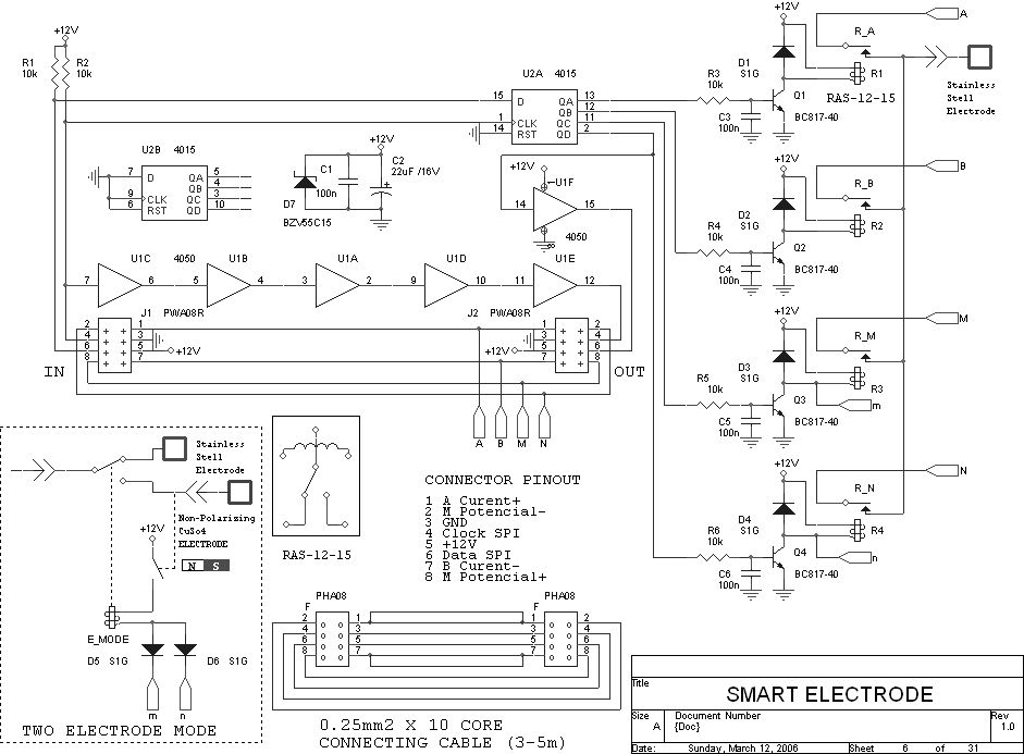

I am currently working on two variants for electrode switches -- for passive and active electrodes. Please, see bellow.

The Electrode switching system for the EPE Earth Resistivity Logger idea is oldest then EPE RM project.

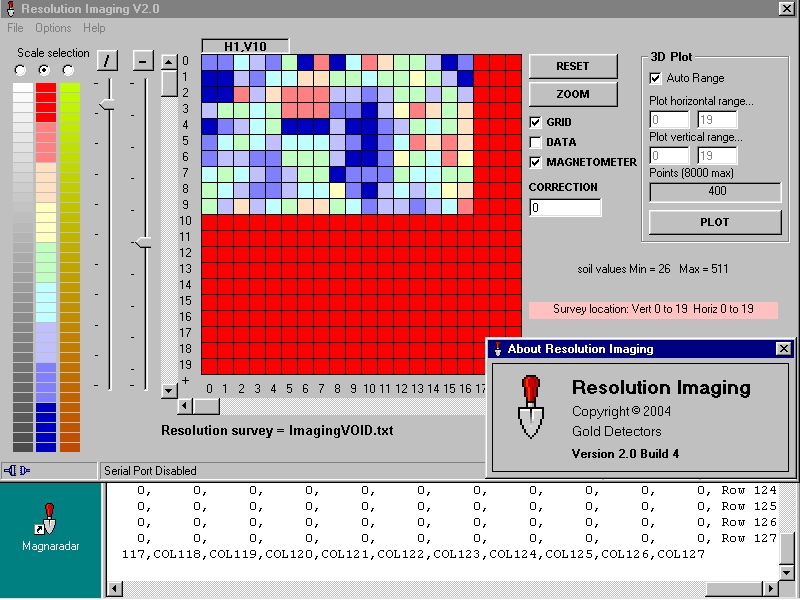

The Magnaradar have switching system with 22 electrodes. Switching sequence do measurement of 20 points per line, using Wenner-Schlumberge configuration. The Logger does not support RES2DINV as data format. The output file format is known (see below). The gradiomater or the metal detector can be connected to the analog input of the Resistivity meter.

The attached screenshoot bellow do not show new Tetris game. I make it from pirate copy of "Software specially designed for deep underground scanning".

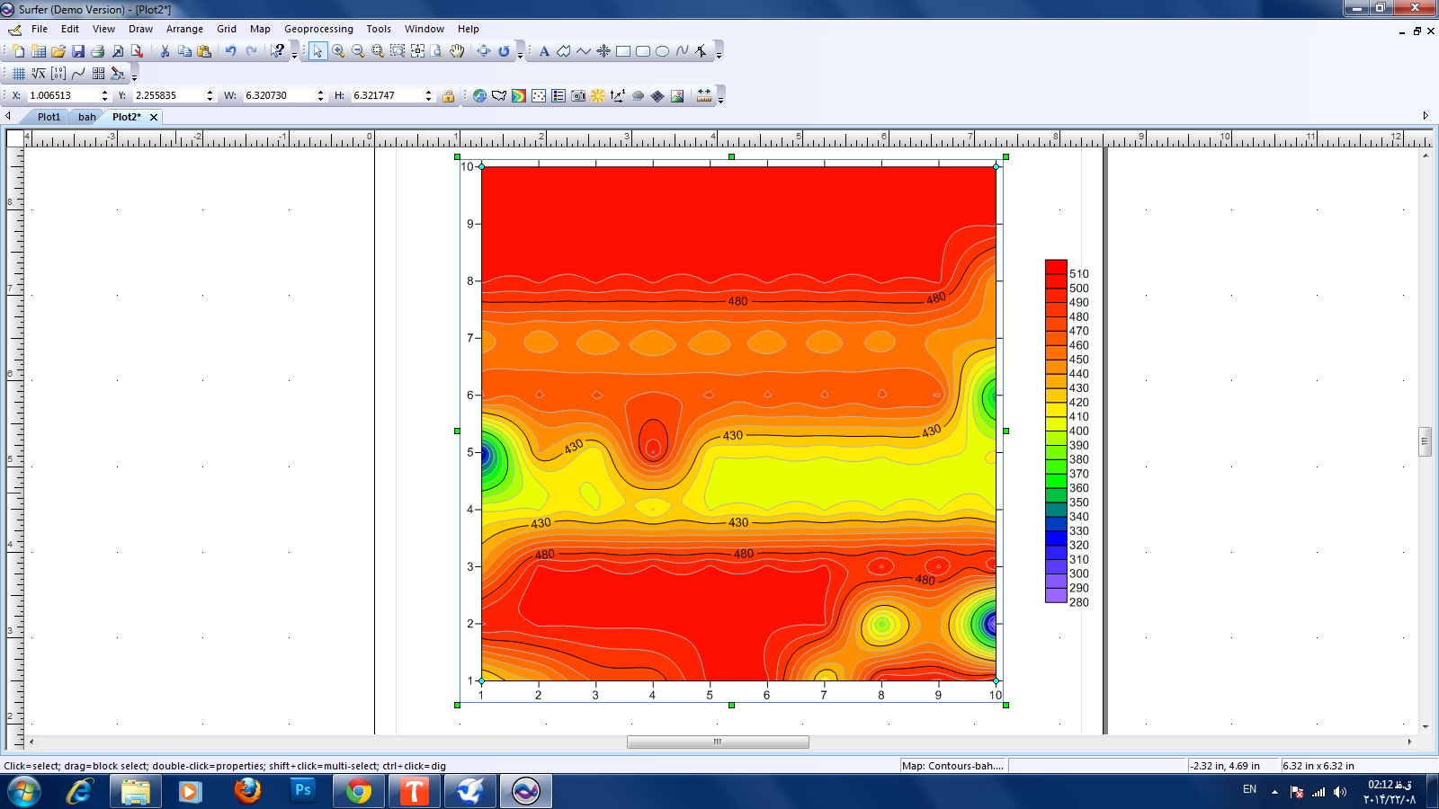

For interpretation of survey data, software should be have processing functions as "clip", "despike", "walls". Also different pattern is used for visualisation of suspected targets.
Such software is Snuffler, Wumap, MagPick, TerraSurveyor.
Then may be used Surfer for presentation.
For useful image the survey data must be have exact measured resistance, free of noise i.e. good resistivity meter.
Surfer is suitable for EPE device, but EPE device is not suitable for Surfer software.
