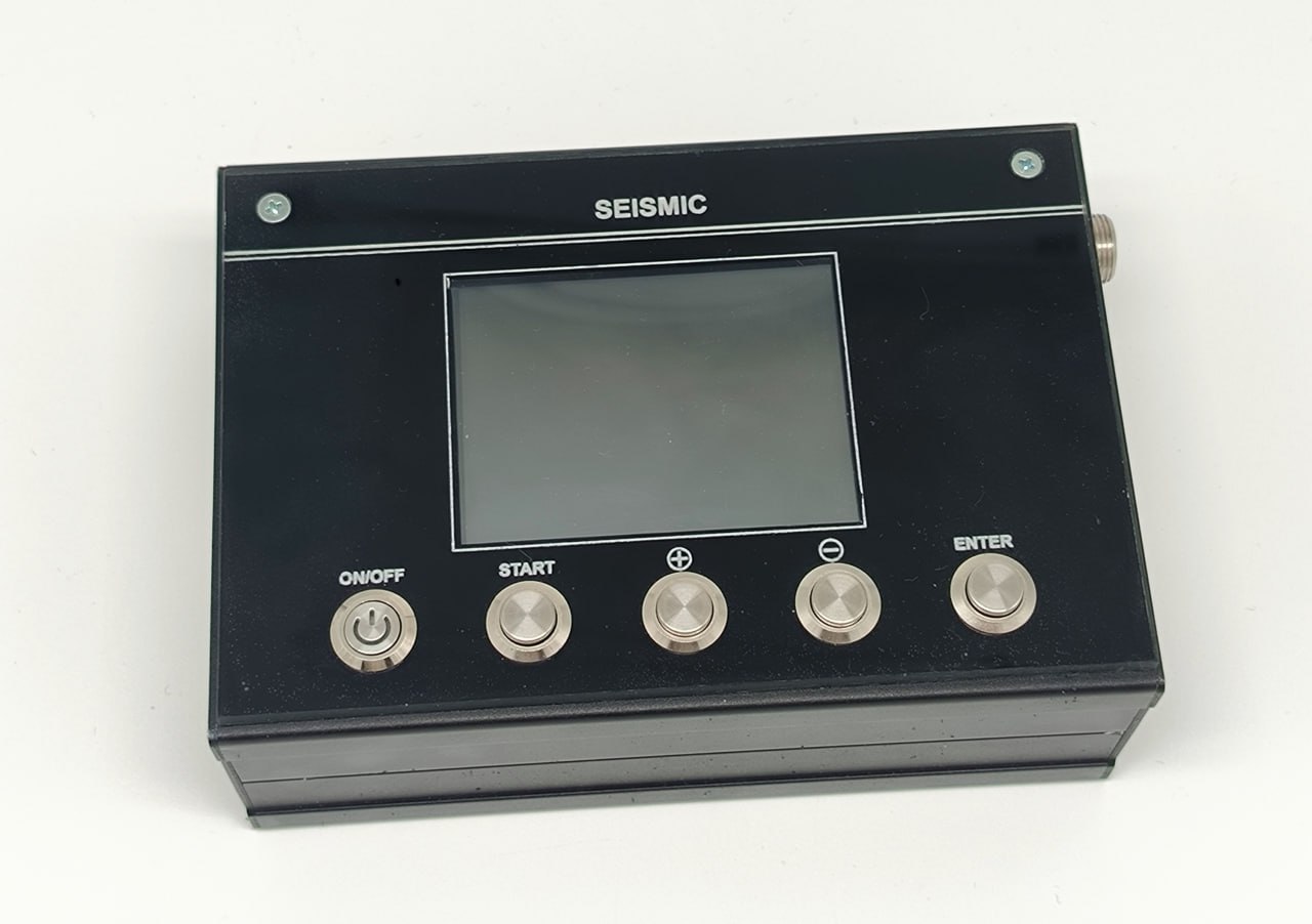

    I'd like to tell you about my project. This device uses seismic (sound) waves. It's used to detect anomalies in soil that vary in density. It's suitable for detecting voids, underground passages, and tunnels. It can also detect large metallic and non-metallic objects. The search depth can reach hundreds of meters.

        In the first version of the device, I used a hammer and a brass rod to scan depths up to 50 meters. For deeper scanning, I used small firecrackers. This allowed me to scan depths up to 300 meters.
        Working with the first version of the device.
          When working with the second version of the device, I use a special impact device. This allows me to measure depths of up to 50 meters.
            Complete set of the device.
              Thanks! Really impressing work;-). Did you build the "geophone" on your image by youself too?

                Yes. This is entirely my development.
