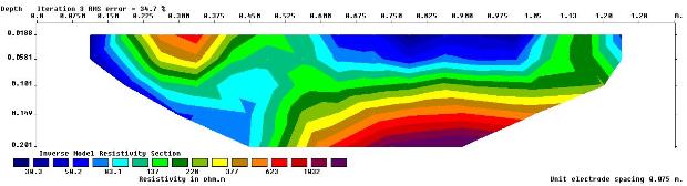

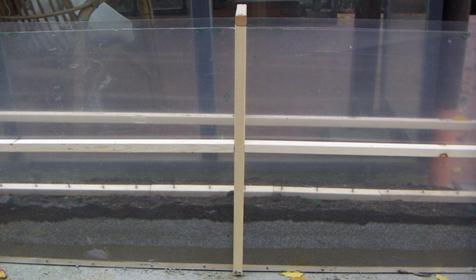

      hi, the first test i made with RM (EPE 2003) is in a model where i put 3 layer of soil and then i tried to processing with res2dinv but the error is too high and it's wrong on the left side of image, see below. Any suggest?
        Very fun . Do you think your model might be flawed as it is not a true 1/2 space? Was your model deep enough for the probe spacing? What probe array did you use? What did the apparent resistivity "raw" data look like prior to res2dinv inverse problem? Also, try doing iteration with lower error than %35.
        I don't know what to tell you but the data should not look like that. It almost looks like the left side of the res2dinv is upside down. Do you think the numbers on that side were reversed by accident?
          Yes may be, and probably i made mistake to write data in the right order. i used Wenner array with 0.1 m spacing. In the next days i'll post something else.
