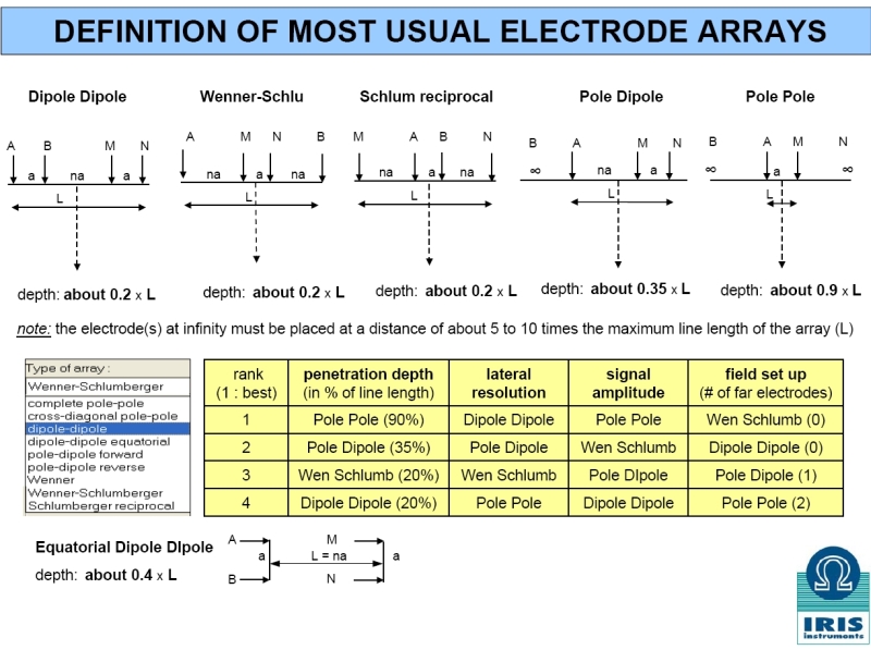

          Which one is better for treasure hunting?
          1. Twin-probe (C2 P2 remain in fixed position and C1 P1 are mobile)
          2. Pole-pole (C1 P1 remain in fixed position and C2 P2 are mobile)
          Are they the same?
          Kind regards,
          1843

              1843 yes they are the same. This method is good for seeing down about 3 feet with the probes set apart at 1 meter. If you open the probes father like 2 meters then the depth will increase.
                Are they the same?
                Kind regards,
                1843
                NO...they are not the same.
                In the twin-probe method, the fixed probes are spaced VERY CLOSE to each other. Twin probe measures "resistance" in ohms.
                In the Pole-pole method, the fixed probes are space VERY FAR from each other (infinity). Pole-pole can measure "resistivity" in Ohm/meters.
