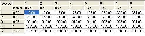

      Actually i am experimenting with a Mini logger, it is a nice piece of electronic , very compact and easy to learn (after a day o so!!! ) now i can log every time and load my grid easily and fast BUT the PROBLEM it is for the accuracy, i did not have ...
      FIRST ... I discovered that the input is AC signal not DC ( Tim do not explain nothing about input specification)
      I made many experiments to see now that my unit did not show a great dynamic range here is a simple grid: from about 150 mV (log spread Row 1 -col 3 =9.00) to 1,600 V (Row4 -col1 = 1009) (500Hz Ac ) (see the photo) I increment 50 mV every case from case 1 to 8 and return etc....to the row 5 ,col 8 final case for 2,000 Volt in this example...
      I understand that the mini logger go to the audio input of the detector but with the treshold problem etc... and a range of about 1,500 Volt it is very low range ...
      What i want it is the full range of DC input to MICRO just like 0.000 V to 5.000V for my Minilogger . please Tim tell me if it is possible???
      I really apreciate your comments thank you,

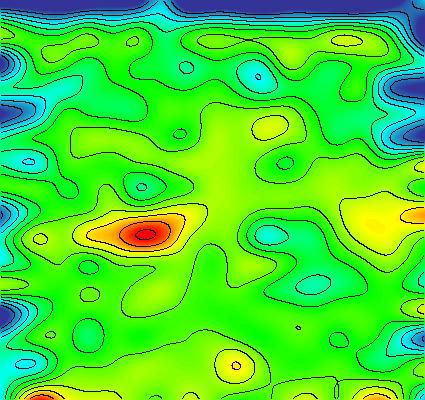

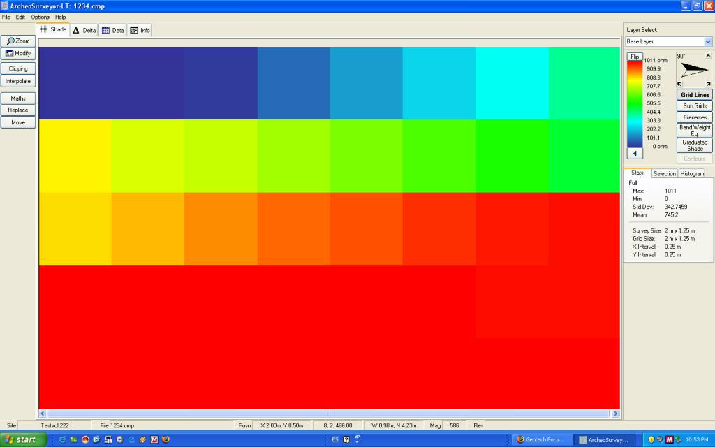

        But really you will have also NICE picture like this of a small part of my garden I luse the Minilogger where you can see some target , thank you to the archeosurveyor software ...but i will imagine with a true logger accuracy of 0.000 Volts to 5.000Volts ,it will be another STORY

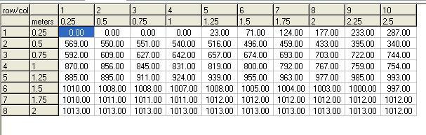

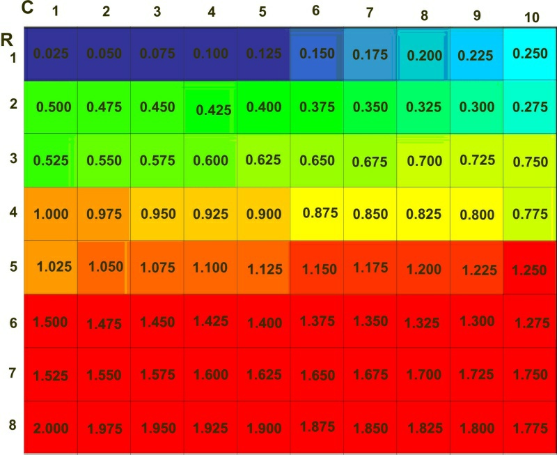

          Another test , I log every 25 mV from case R1 C1= 0.025V to R8 C1=2.000V Fcy 1000Hz, you can see very well that with the data grid when you have the data1100= 1.500V NOTHING CHANGE ,
          so the data mini logger work from 0.000V to 1.500V maximum,

          First Image it is the grid color generated by input from 25mV to 2.000V it is the black number in the case witch indicated input
          Second image it is the data generated by the minilogger
            The input to the controller is 0-5v. The unit is 10bit witch is 1024. Look at the data 1013. You can't go by the input signal. Try using pulsed dc PWM and see what you get.
