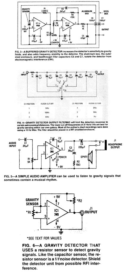

                          You can measure by gravity. This demmand a sensor build by yourself. This is a sensor extremely sensitive to weight, exceptional, a small grain of metal deflects a microamp. strongly. This acts as an extremely sensitive variable resistor. This must not exposed to air, because the air produces strong variation. Also must be not exposed at vibrations. Now, you have my very useful copper plates-conductive rubber sensor.
