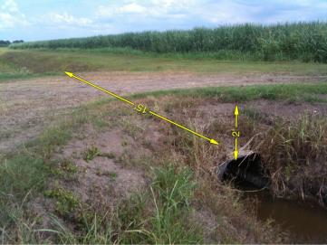

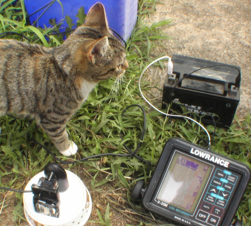

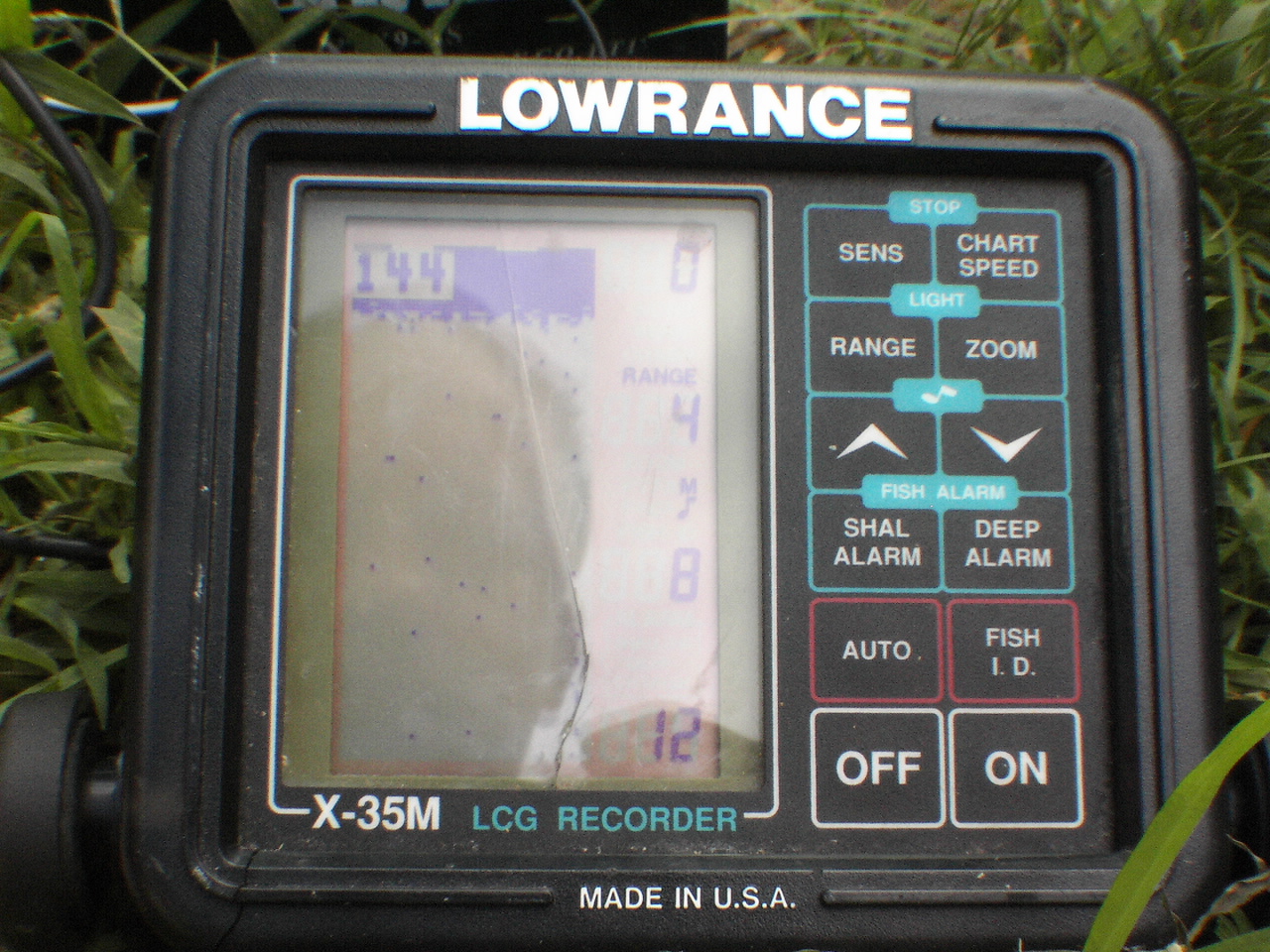

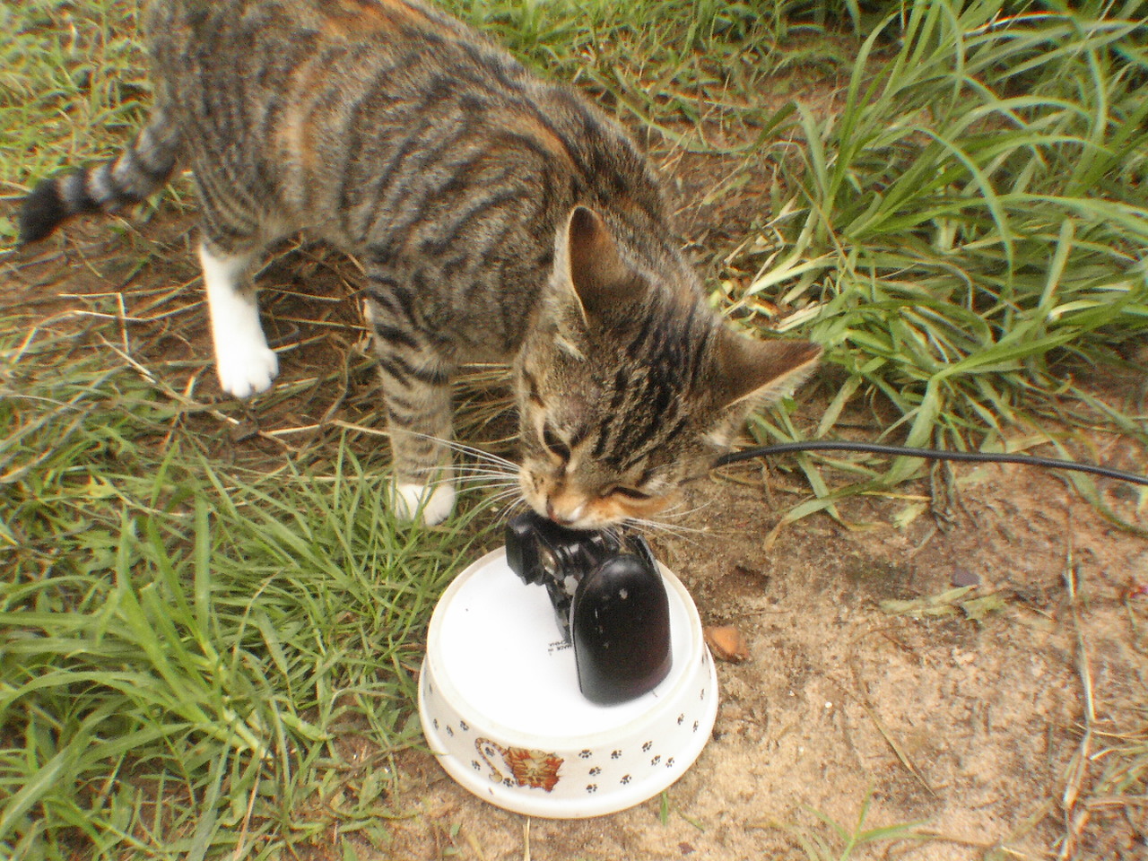

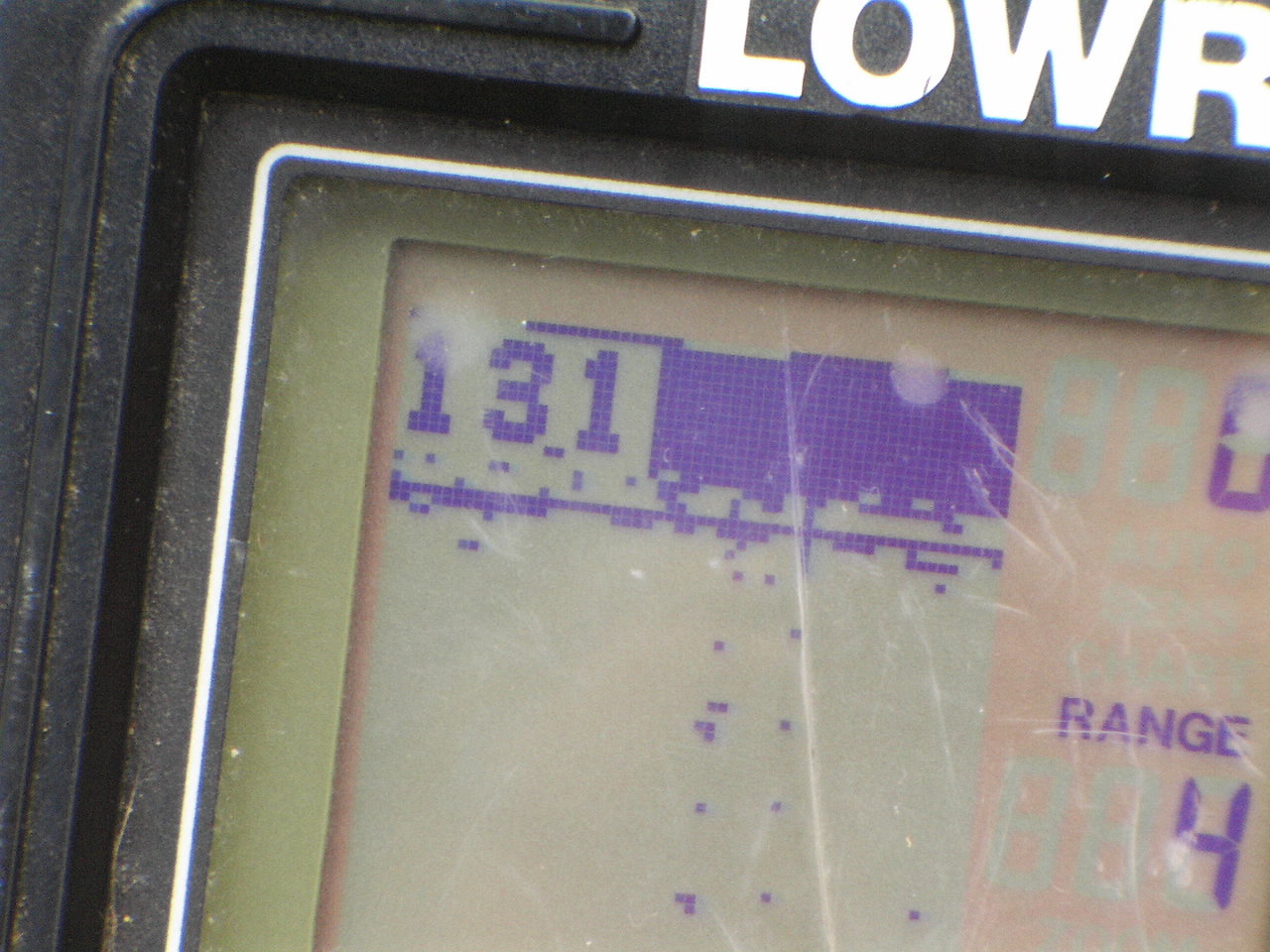

    This is how we did it
    She was insisting that it is a fish - I said that it's ceramic pipe only.
    Then she moved sensor about meter away and the sensor is showing only noise. I went to work but she decided to do some digging just in case it is a fish.
    It is not easy to have dispute with ladies.

      Hi, looks like no one get exited about my cavity Fish Finder
      idea. But may be some one can advice some tip how to open
      fish finder box. I have intension to replace broken glass but how to open
      the box? Right now I am prepared to cut it all around.
        Don't let it bother you. just put clear scotch tape over the crack to keep moisture out. Did you try you'r scheme at another location?

          Hallo Wam,
          I think in order to get excited about it you need to do some more experiments. How does your fishfinder react if you bury a heap of Newspapers in the ground? Better would be a heap of dollarbills but I guess you don`t have a big enough bundle to bury to be detected from the fishfinder??!.
          Who knows may be you've found the poor mans earth cache detector.
          A few experiments in the backyard should make it clear if that is a sort of toy gimmick or if it could be used to detect abnormalities in the ground.
          Thanks for the funny presentation with the Kitty.

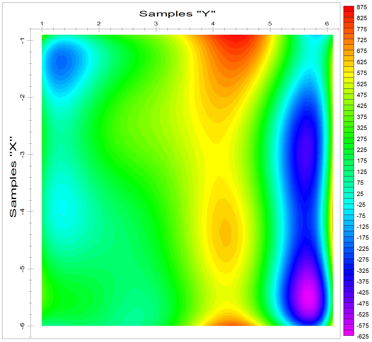

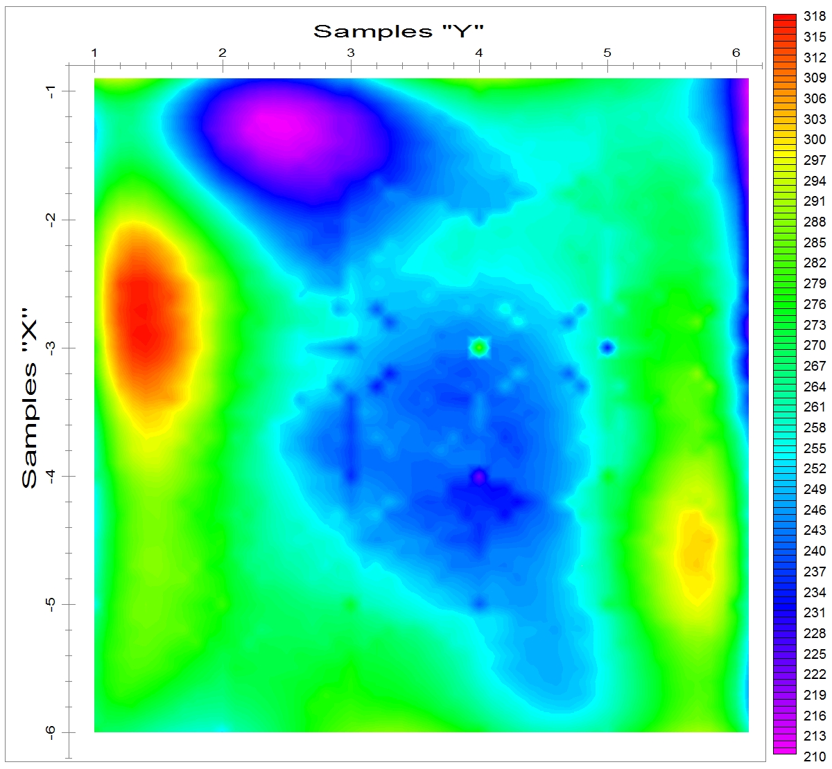

              Here's a plot showing a void and another a pipe. Both were done with the tm-808 in cave mode-auto. Of course these are not that deep but targets have been recovered to 14ft.
