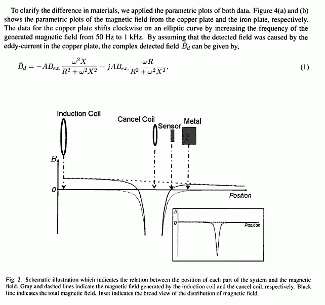

    I found this page accidently and I thought lets have a look because it is something coming from a University and I tried to read the concept but I couldn't.
    Do you have to pay for it? This is what I understood.
    May be I am wrong.
    New Detecting method
    By typing in the title on Google, I found enough of the article here via Google Books that explains the tests with a schematic and graphs of the results. Wow, very interesting and nice to have a new idea for our hobby.
    SWR take this very seriously.
    Randy
      to g-sani
      the article says:
      A new type of magnetic field detection system, which can operate at a frequency below 1 kHz, is proposed and developed. The system consists of a 40-turn-coil to generate the magnetic field and a magneto resistive sensor to detect both the amplitude and the phase signal of the magnetic field induced by eddy-current and magnetization of the samples. The magnetic field detection of ferro- and non-magnetic samples using the system is demonstrated and discussed.
      accidentaly , last days I made a receiver 100Hz-11Khz
      if you find a operator uder 1Khz , maybe I say maybe ....or if someone can give us a design????

        Hi epitopios.
        There is no circuit shematic showing components or values.
        The designers from the Okayama University gave this vital information that explains the technique to discriminate metals:
