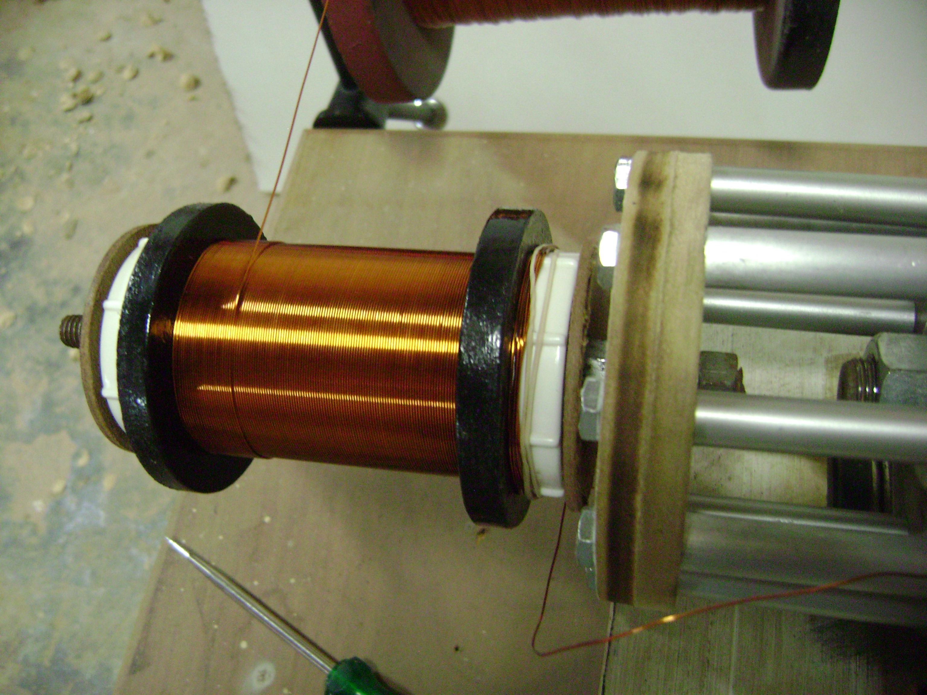

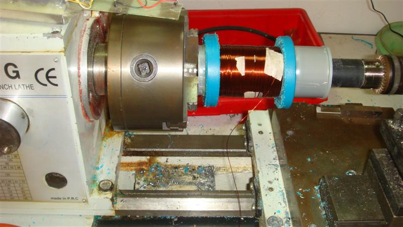

                Hello Geo, I'm at the stage of development of the PCB and coils, time is too short for me, but I must conclude in March.

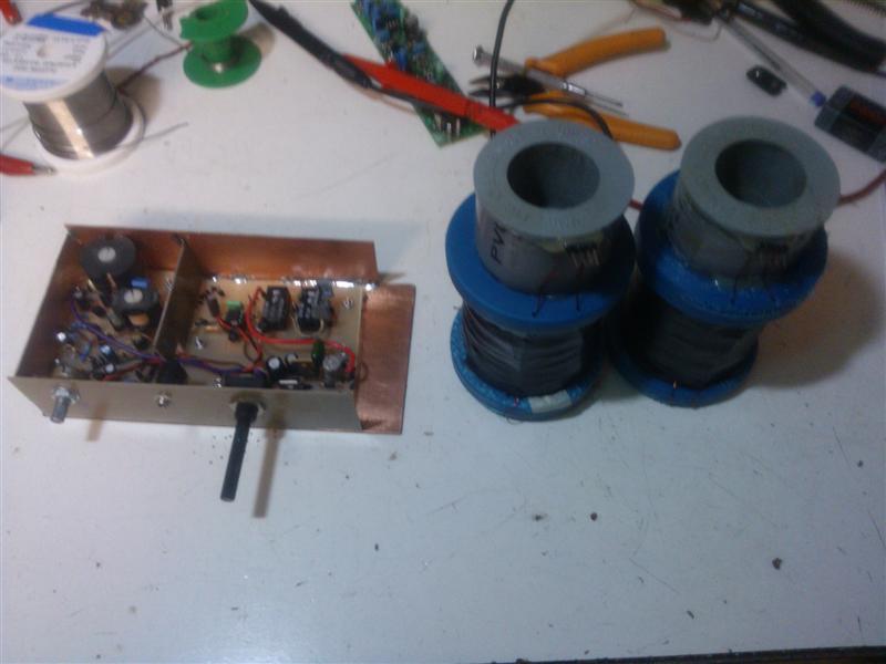

                  Thanks Baterista.
                  I also constructed it but i need to make the coils. I replaced the flip-flop with a LM555 and i connected 2 small pcb relays via a BC517. Also i made the power supply to work with a 14,4 v battery. 555 and relays will work with 12V and the main amplifier with 9V. Polarised time will be from 0.5s to 5.5 sec and the receiving time from 0.3s to 5.s sec.
                  I will wait for you news.

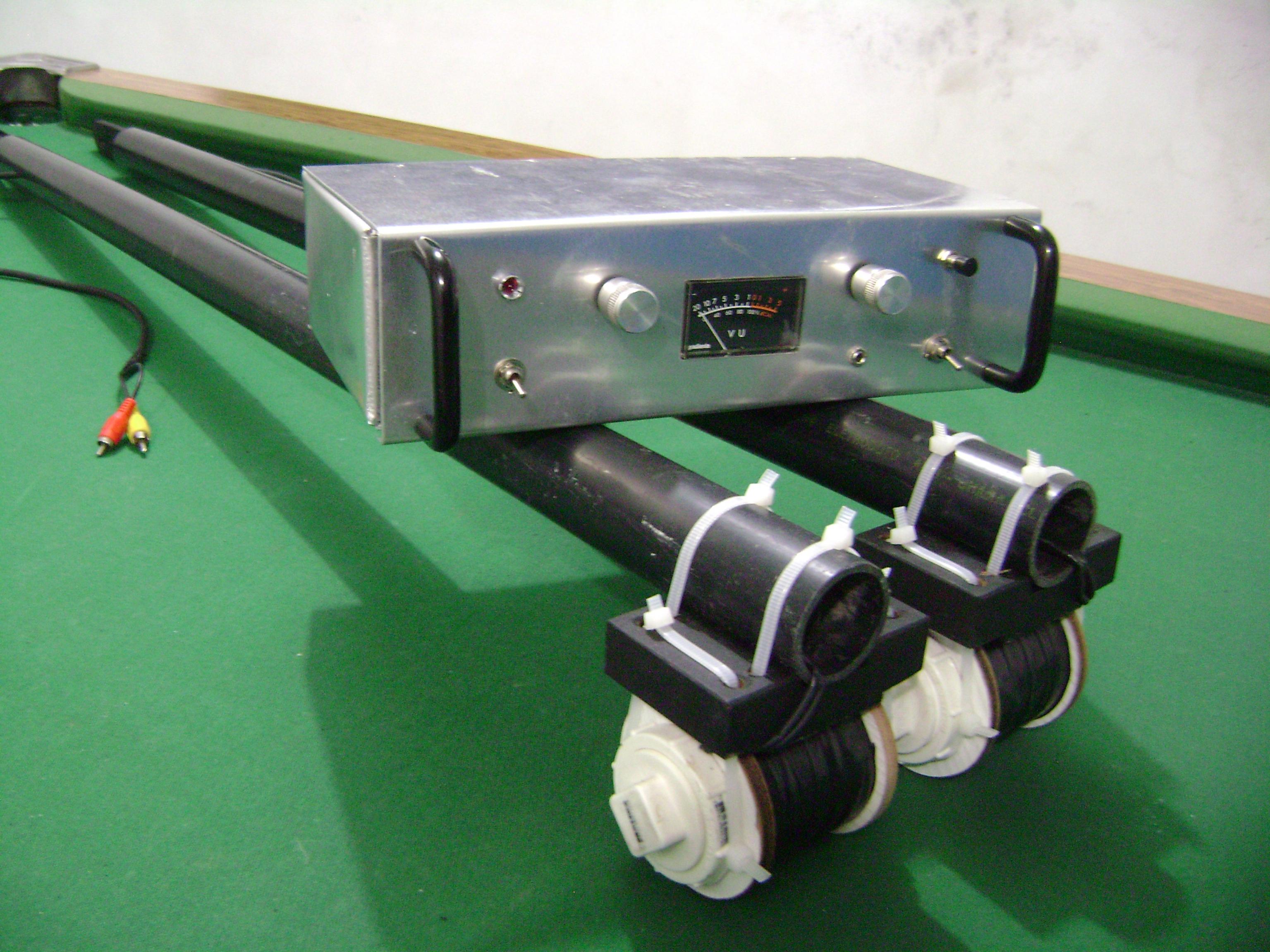

                    Hi.
                    I finished it but i did not test. Maybe next week!!!
                    RegardsClick image for larger version

                      Hi, Geo, congratulations, let's wait for the tests and also the details of the assembly.

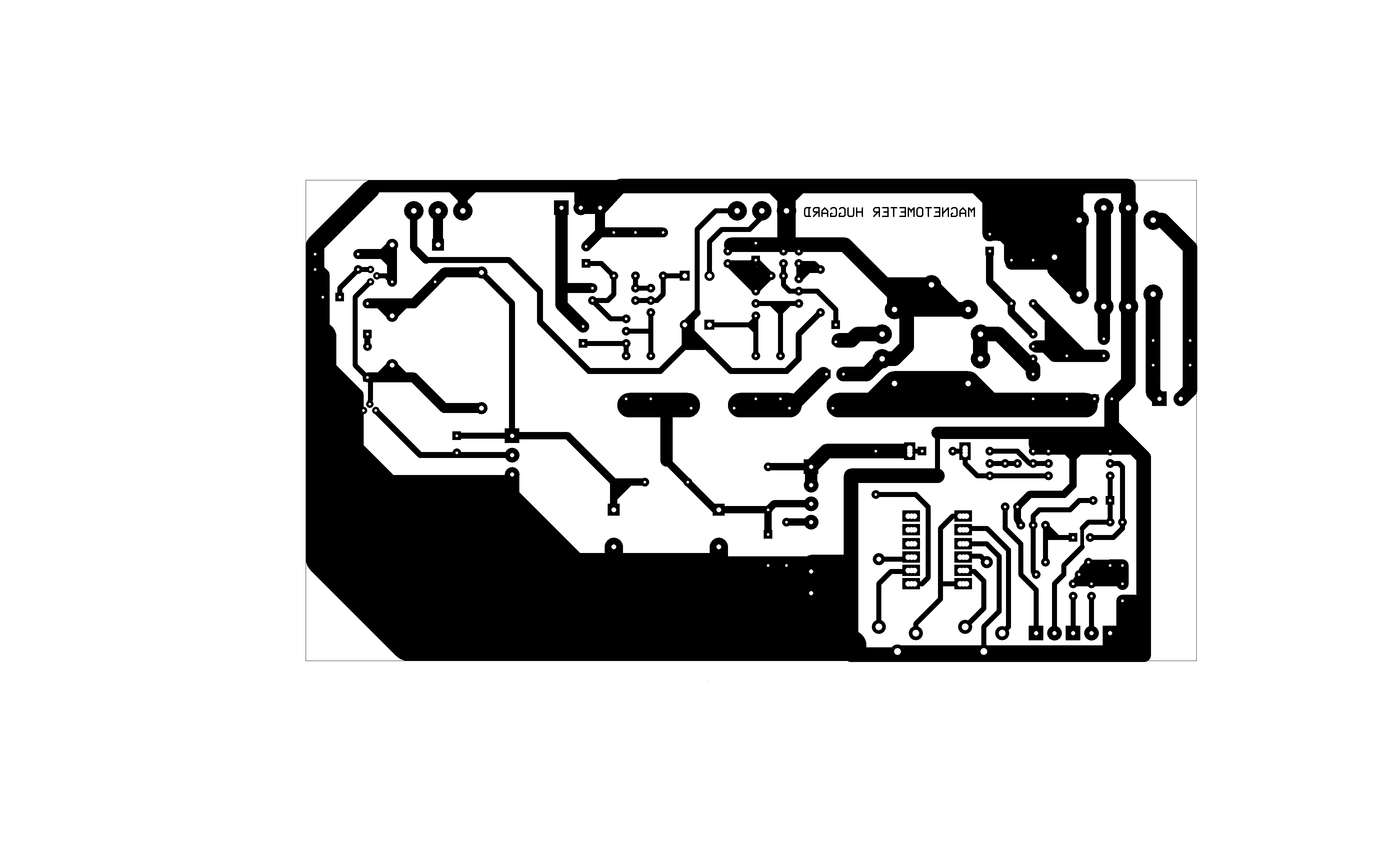

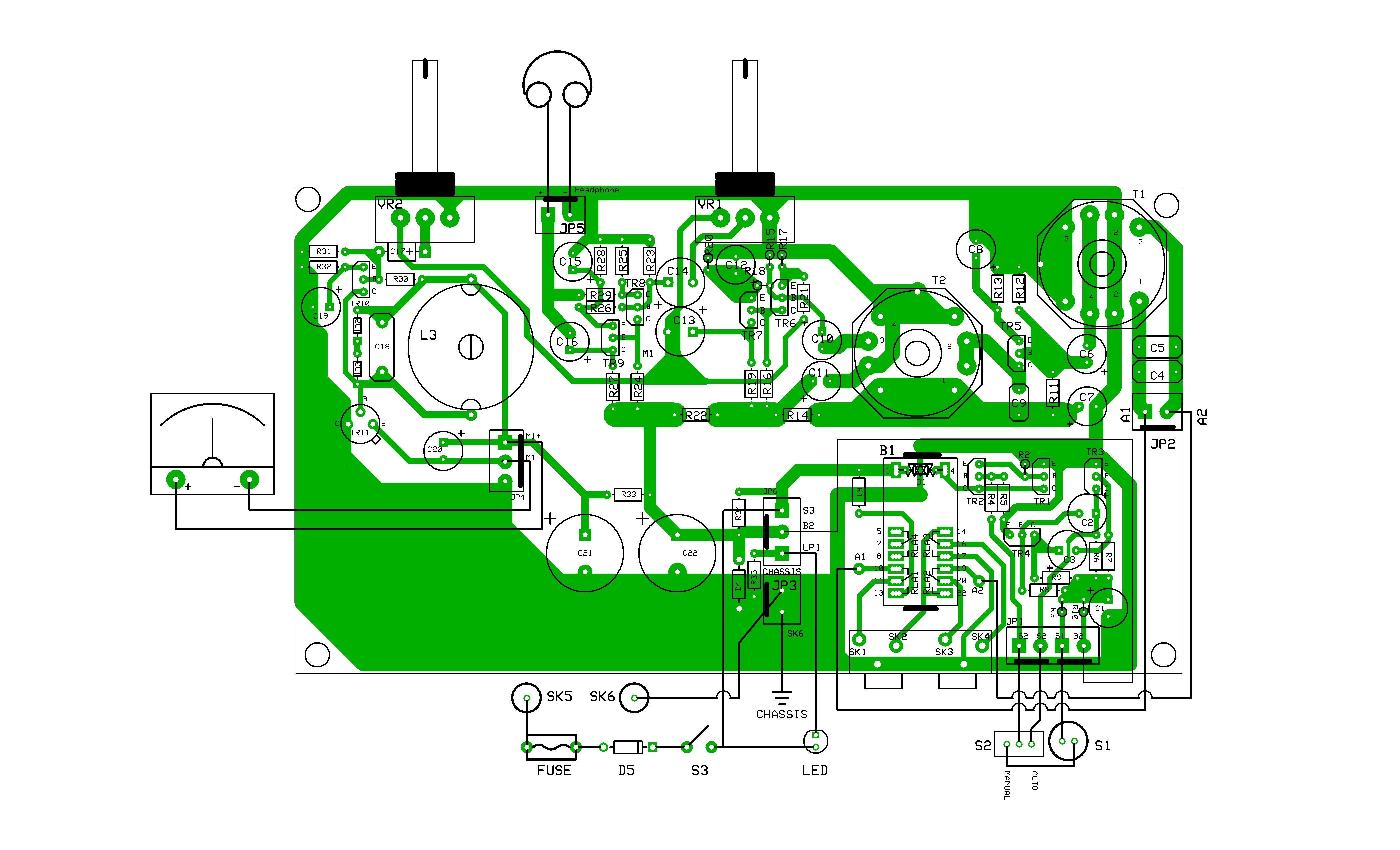

                        Hello everyone, after some problems with the supplier, the project was completed.
                        Using a single-sided PCB, has a new layout, with transistors easy to find
                        (at least here in my country) and some arrangements. Gradually I will posting more
                        details.
                            PCB 183 mm x 100 mm, solder side.
Name:	PCB Magnetometer 183 mm x 100 mm.JPG
