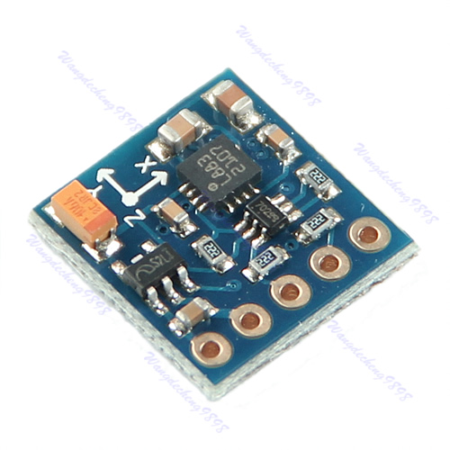

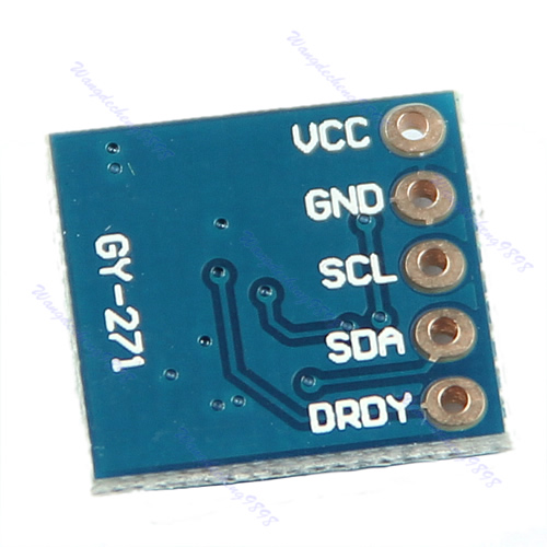

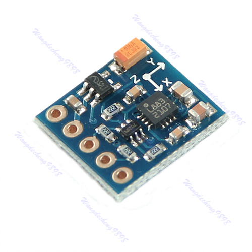

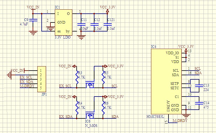

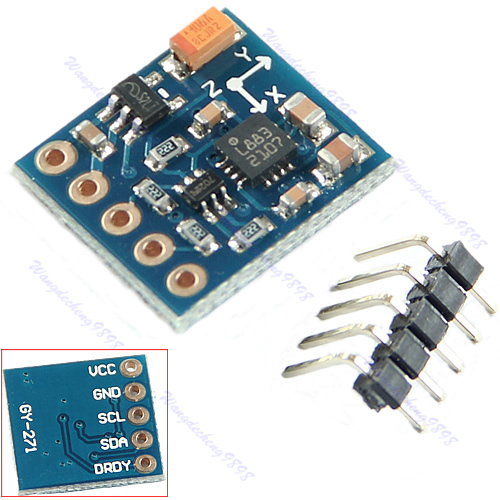

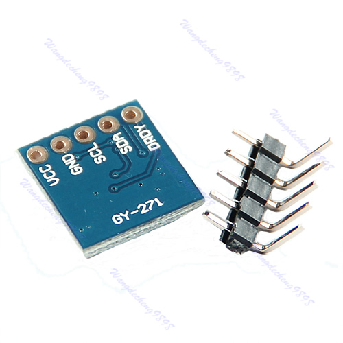

    Hi got hold of a couple of these modules
    Was thinking if I could make a Magnetometer out of them.
    Type GY-271 Using the HMC5883L chip.
    Triple axis compass magnetometer sensor module 3v-5v power supply.
    Communication mode: standard 11c protocol.
    Has anyone here used one of these modules and could give any tips on it.
