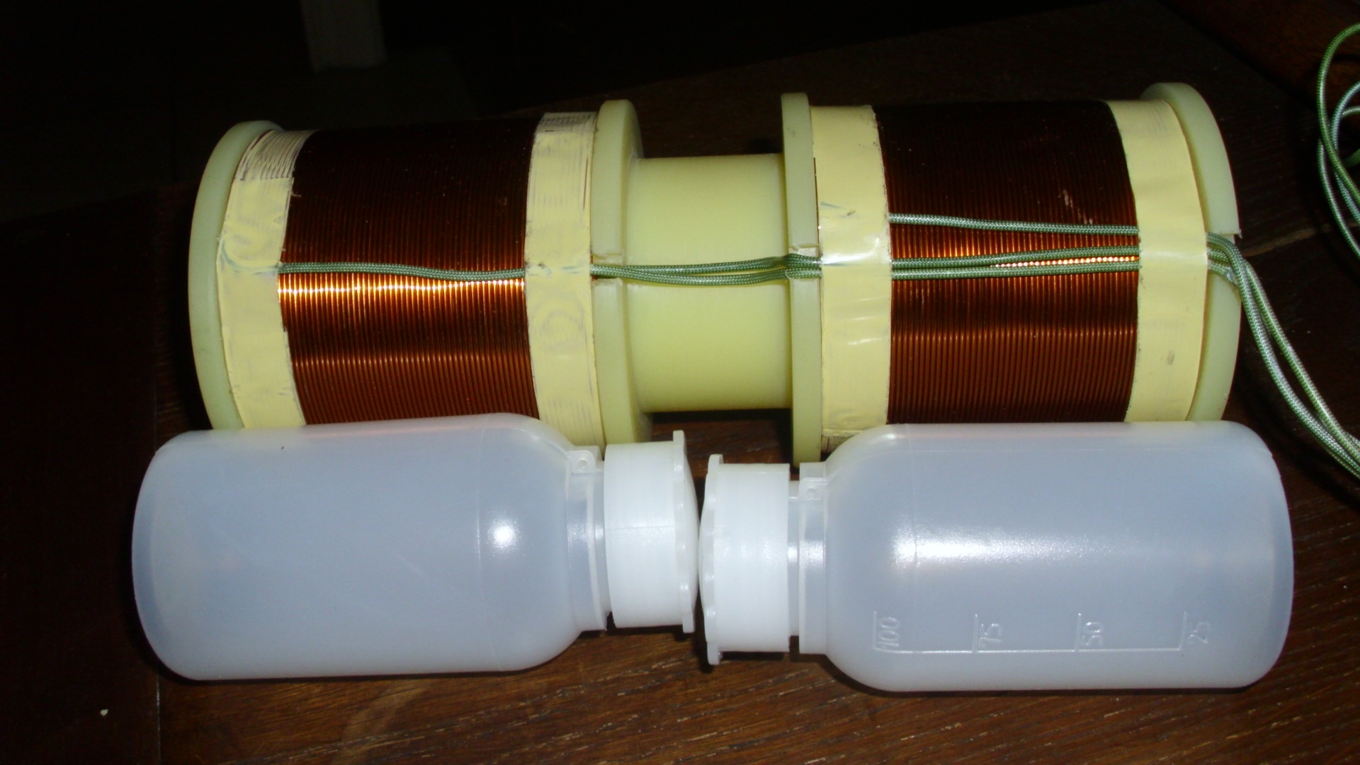

              The attached picture 1631 shows the pair of coils we provide for underground survey work. They are wound with 18AWG aluminium wire to make them lighter to carry.
              The fluid is contained in two plastic bottles inserted in their core and filled with isopropyl alcohol.
              The container for that pair of coil is simply a piece of PVC gutter tube with two caps.

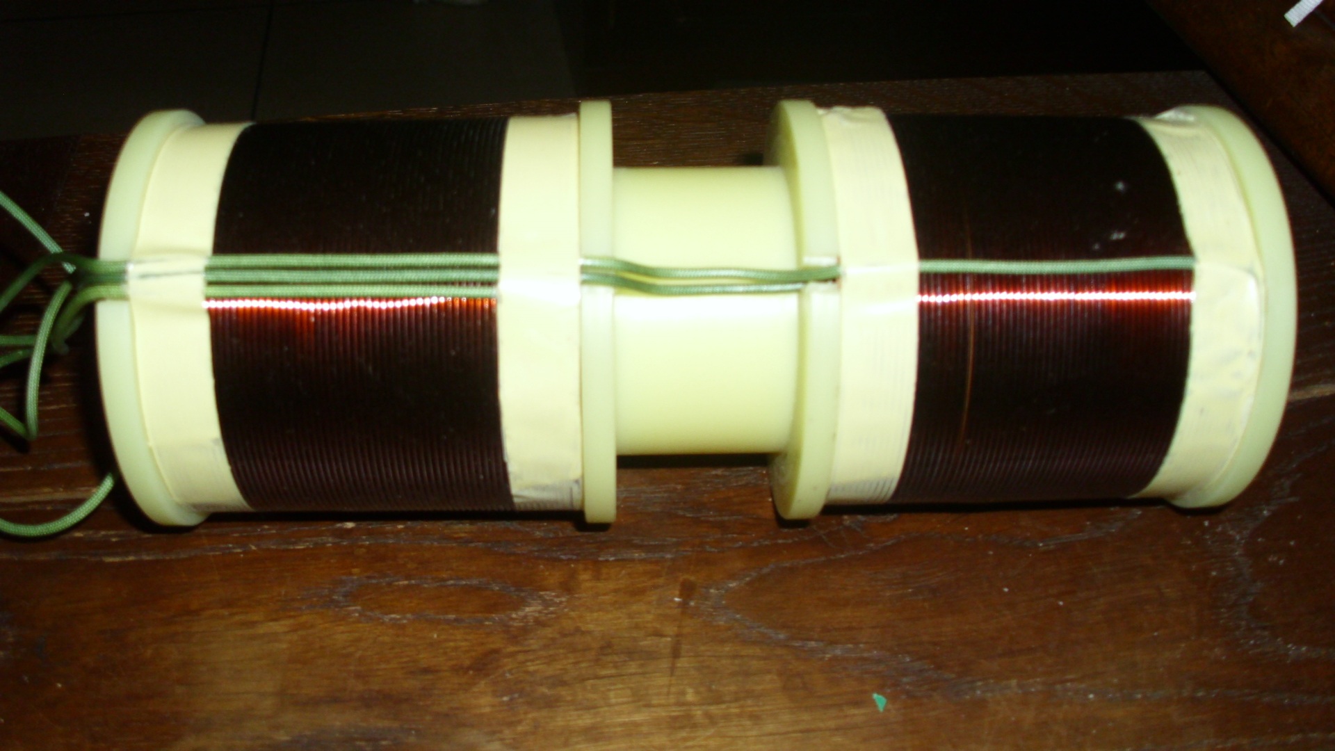

              The attached picture 1632 shows the pair of coils we provide for underwater survey work. They are wound with 18AWG copper wire to decrease the electrical resistance of the sensor and thus, give a higher polarization current.
              The fluid is also contained in two plastic bottles (shown) inserted in their core and filled with isopropyl alcohol.

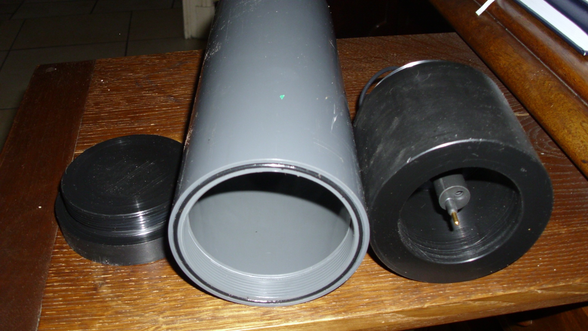

              The attached picture 1633 shows the watertight sensor container we provide for deep underwater surveys. It is rated for depth of 100+ meters (300 Ft).
              You can easily see the O-rings inserted in the thick walls of the PVC tube, the two caps screwed on the tube and the hermaphroditic connector rated for depths of 10000+ ft.
              At the beginning of our common PPM MarkIV project, James Koehler and I have made a lot of experiments with various coil types and coil arrangements, including toroids and cylindrico-toroids.
              The final conclusion of our testings was that the simple cylindrical coils configured as two coils fixed on the same main axis as it is now generalized for all our products is the best compromise in terms of cost/performance.
              In all that design, there is no reason for patent. There is no mysterious sensor configuration. The simplest, the best!!!
