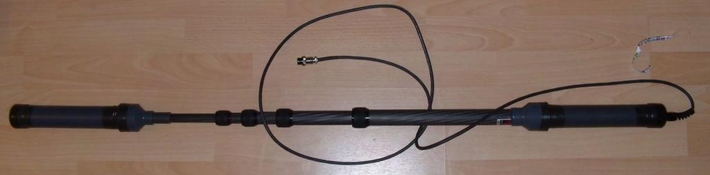

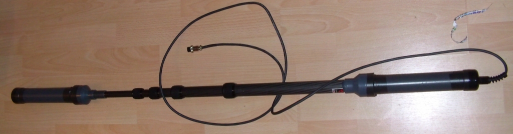

              if you use two sensors in one line (same axis) you could make a differential magnetometer
              field normal - field strenght is same in both sensors
              fe object underground de-forms earth field lines so measure the difference between the two sensors
