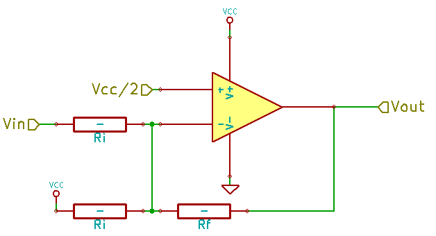

          here's a good article about a DIY sensor:
          the expected AC voltage is about 2.5Vpp for the first sensor variant - if you have a 5V tolerant arduino you could just use an op-amp to offset the DC level of the AC signal to Vcc/2.
          Source: http://www.paulmonigatti.com/2011/09...crocontroller/
          So if the signal is 2.5Vpp and Vcc=5V the voltage on the ADC pin will swing from 1.25V to 3.75V which is no problem for the arduino and you still got some headroom. Rf can be set equal to Ri so the op amp works at unity gain. Clamping diodes may be helpful too - just in case.
          The frequency could be measured with the integrated comparators, setting the threshold to mid-supply (Vcc/2) to detect the zero-crossing or use a frequency-to-voltage converter.

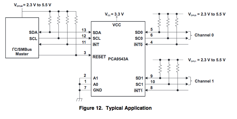

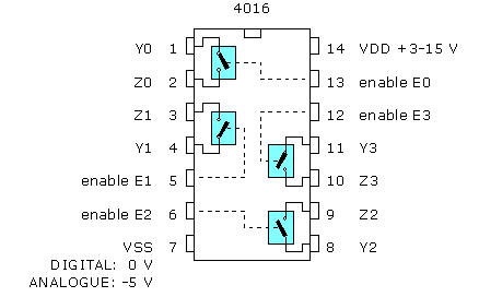

                    i made some test with hmc5883 sensor it is sensitiv enough an could act as a mag for ferrous searching (conatant reading over serail monitor)
                    problems is that the arduino can only read one hmc5883 once
                    because it is not adressable
                    so it is not possible to build a two sensor mag (differential mag)
                    No problemo, here are 3 possible solutions:
                    1. Use an I2C bus switch/multiplexer IC, like the PC9543 (there are many alternatives, I've just picked one). Costs about 1-2 Euros.
                    2. Just use a quad-bilateral switch IC like the goold old 4016 to multiplex the SDA/SCL lines, alternatively a CMOS device from the 74HCxxx family can also be used. Costs less than 1 euro but might bring some trouble if you go high-speed on the I2C bus due to capacitance issues, but it's definetly worth a try! You could even use a pair of NPN/PNP transistors to switch the SDA/SCL lines.
