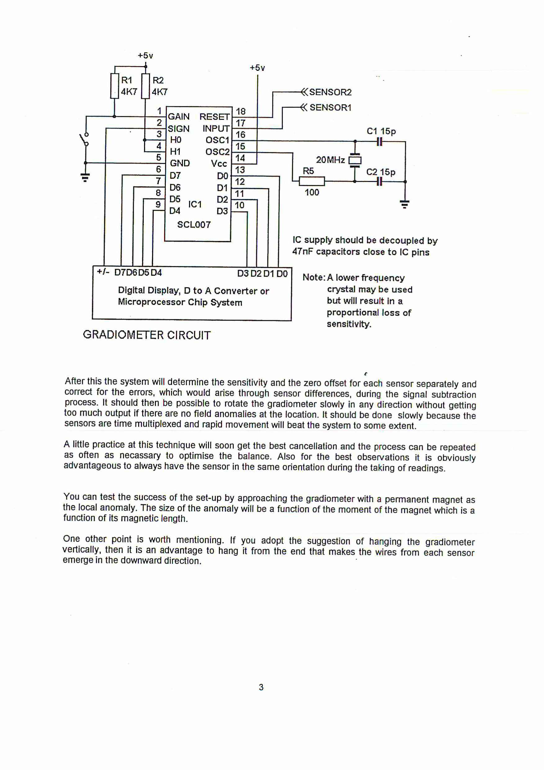

    Hey.
    I have gradiometer circuit.
    Can anyone help me abput pcb design
    sure we can do
    put the sheme here as a Picture with high Quality as ***.gif or as pdf document
      I hope it is not illegal..
      This circuit is near my FGM1 sensors documents
        this was already done by some other persons
        the scheme you Show will not work alone
        http://www.geotech1.com/cgi-bin/page...fmx1/index.dat
        would be fine to connect the Output from the scl007 to an arduino with lcd Display to Show negativ and positiv part of field on bargraph or so

          Now Lugatek is unaccessible.
          Bro I have 2 FGM1 sensor. Now I need main board schematic. I m asking that " I dont want to buy ready pcb and PIC etc. , just I want to do it myself "
          So I need mainboard schematic, pcb design and hex code.

                i have only all datas from epe magazine epe magnetometry logger which is based on the fgm3 sensor by speake and co.
                but that is not that what you search
                  No problem..
                  Im looking for a gradiometer which is I can make it myself.
                  I can buy some different sensor like flc100.
                  but I should do myself rest of sensors.
                  Just I need main board schematic and hex code connecting to sensors
