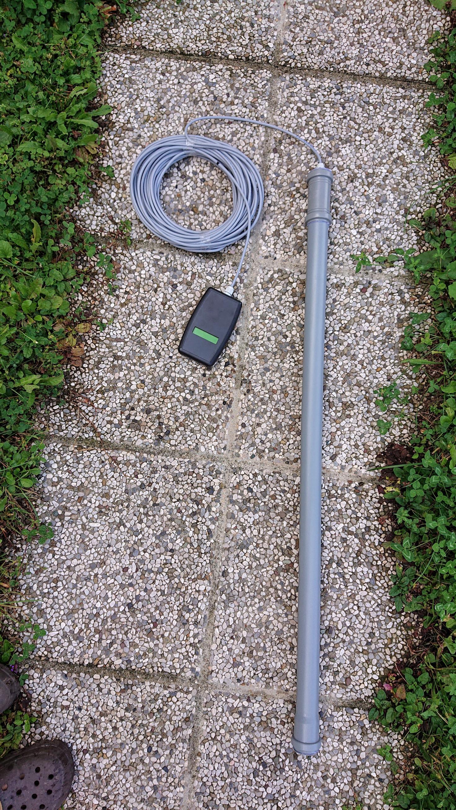

    Hi guys
    After long time I do make new easy to build DIY project call MAG-BOARD.
    You can buy kit from my site www.fgsensors.com. I think think this is cheaper way to build high quality magnetometer/gradiometer.
    I offer also open-source code, so everyone can make it as wish. MAG-BOARD use strong dual core processor with build BT and WiFi (ESP32) and SD card for recording. Also is available free arduino app for connecting with your phone.
    I also make waterproof version of gradiometer with long cable.
    Any comment are welcome. Geotech users have also special discount of 5% with code "geotech"

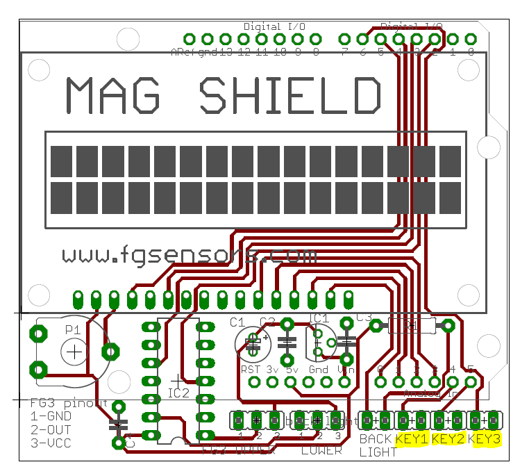

          I bought this set, but I want to know where to put the sound button, and can I connect it to a 3D application? Where do I put the Bluetooth parts, if possible?
            Hi
            This is not magra. This is old mag-shield board. This has no connectivity to phone!
              Is it possible to install the role of the buttons? It is not clear how to operate it
                It is open source and open HW project. So you can add up to 3. buttons. You can simply add in code. It is published on www.fgsensors.com site. But keep in mind that there is no speaker.

                  What can I use these 3 buttons for, and is there an audio port?
                      No, there is no audio output. Button can be used for whatever you wont. For nulling example. But you need to program it!
                      Keep in mind that mag-shield is only development board. Of course you can use it as gradiometer with included SW

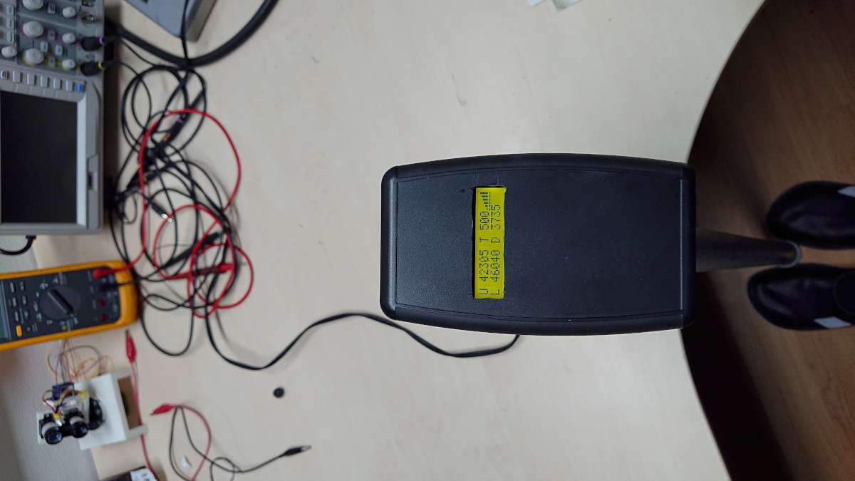

                        Hello !!! I also have this device, but it is useless without the function of keeping it. I get to connect the memory card to it for recording data. Maybe someone will explain what kind of data should be recorded so that they can be visualized? Thanks.
                          Mag-shield is old - development board for gradiometer.
                          Much better is mag-board who has phone connection, onboard buzzer and SD-card holder. SD card is not supported by currectly FW, but data can be recorded by phone app and import it Surfer or some other program.
