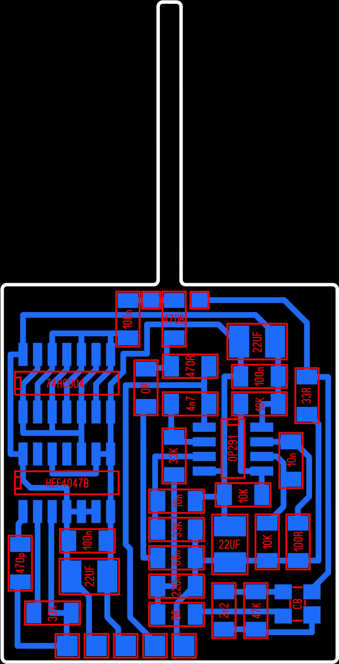

    I have schematic for flc100 and find to need a component which is left buttom side.
    CV 80 smd x4, can someone know this ?
    Dual diodes???
      Dual diodes???
      for example ?
        Maybe something like
        BAV99
        BAT54
        Do you have this circuit to measure?
        If so then a DMM is DIODE scale will tell you if this is diodes or not.
          Cv80 smd 4x olarak kodlanmış ama araştırınca sot143 kasa ?ıkıyor. Yerine bat54c-s kasaları kullanılıyor diye biliyorum. Ancak bat54c-s kasalarından diyot birisini k?pr? diyot , diğeri ise ters d?z bağlayabiliyoruz. Şemaya g?re nasıl kullanılacak bu malzeme ?

            look also a version this is optocoupler and in DIP4. not smd then. sch does not view that CV80 is sure smd.
            PS. oops. this is smd. pcb https://redshiftlabs.com.au/product/...ensor-flc-100/
              thank you.Its clear looking
              Its 2264 11FH4 what is this ?

                C8J
                  Thank you, but when I type it to google, I dont see any component.

                      tantalum capacitors. 226A - 226 - 22 000 000 pf - 22 uF
                      A is voltage, 10 V
                        Thank you very much.
