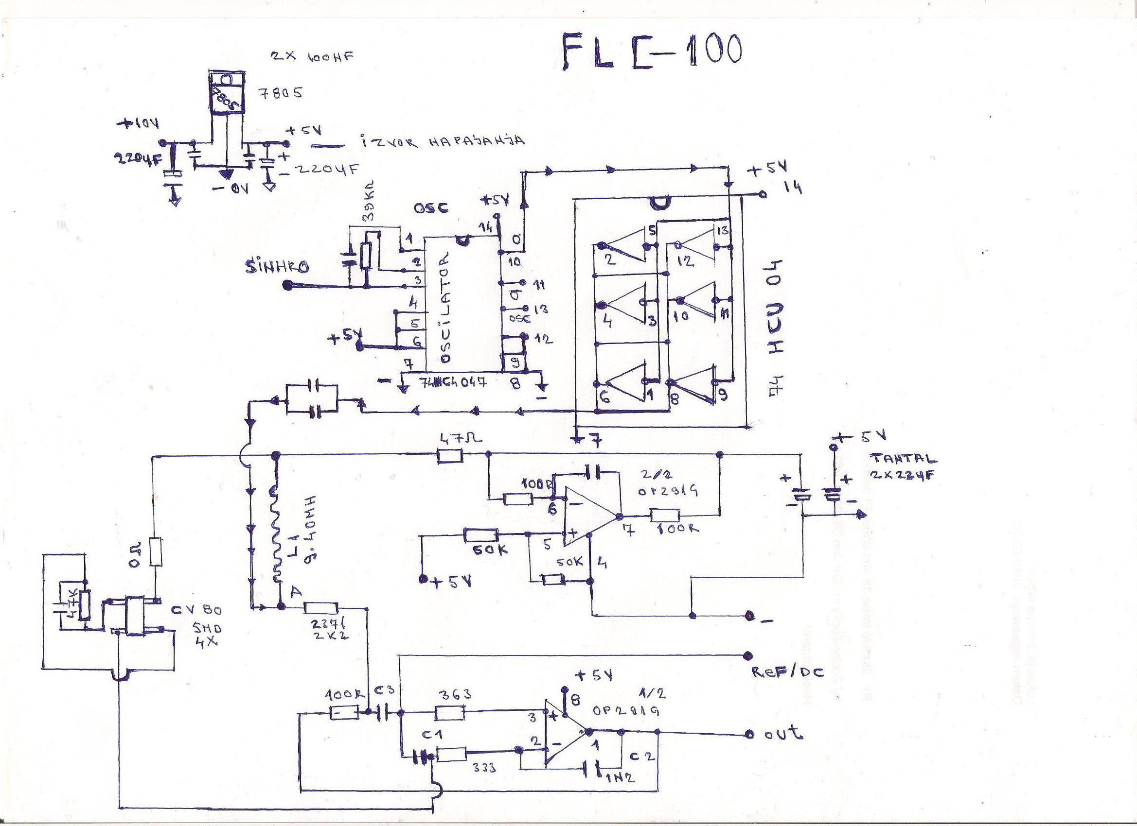

Name:	elektricna sema flc100.jpg

          Also interested in practical gradiometer circuits with FLC 100 and wondering if two gradiometer sensors of this type needs to be synchronized (excitation frequencies)?

            Hi, what is CV 80 smd part on FLC 100 diagram?
              Cv 80.... sotki diodes
