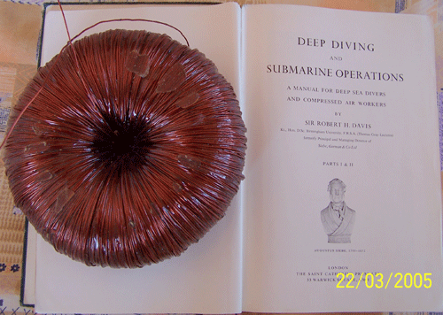

                  Would this toroid serve? 2000 turns, #20 wire
                  treasurediver
