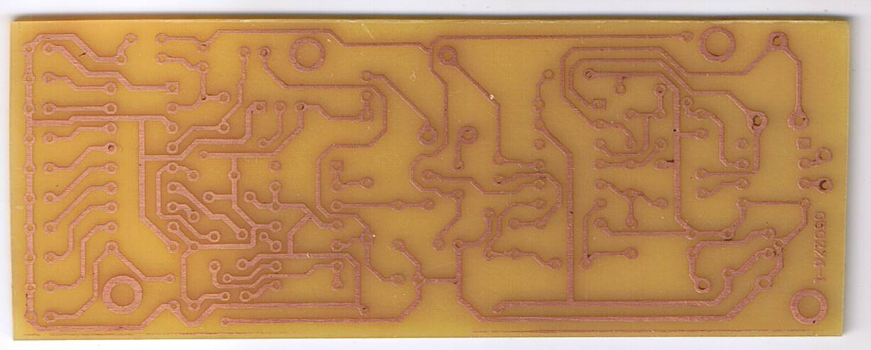

                Hi Rael,
                PCB that i made from your schematic diagram.
                many thanks!!!
                ikumi5
                  Hi İKUMİ5
                  did you completed this magnetometer.
                  is it suitaable for metal and cavity search.
                  did you try it with polar anttenas
                  best regards
                  okantex

                    Hello
                    Pictures can not be read. install a large clean image.
                    If you install it, or epe magazine 1995 issue.
                    Thank you.
