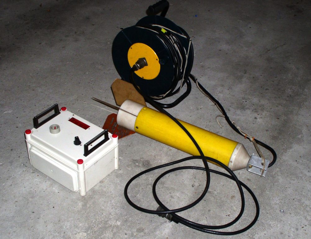

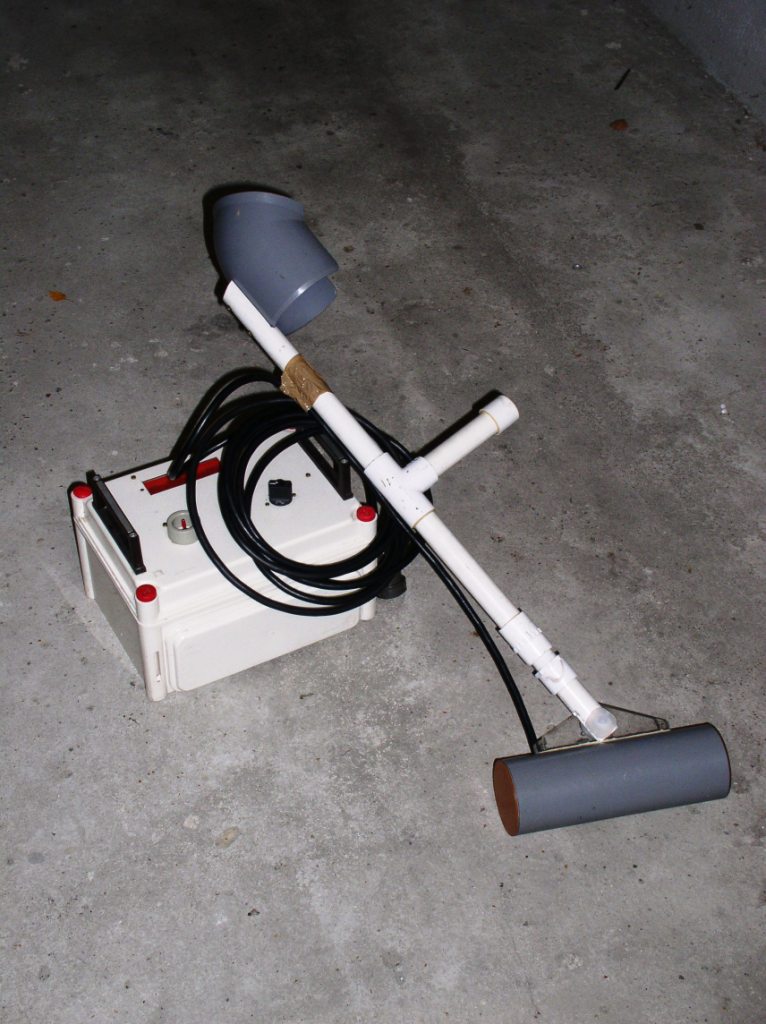

    I have two basic sensors: one for land and another for sea.
    I want present here as many details as it will be possible to help anybody who will dare to spend a bit of money and a lot of time to build his own mag. Using this magnetometer I have found many shipwreck (not only steel, but also wooden!) and a lot of war trash (mainly od land).
    I want apologize irregular style of future messages. Now we have heavy western gale sweeping our seashore, but when the wather will improve I am going to continue my activity.
    Two photos of my magnetometer one with the sea sensor and another with the land version.

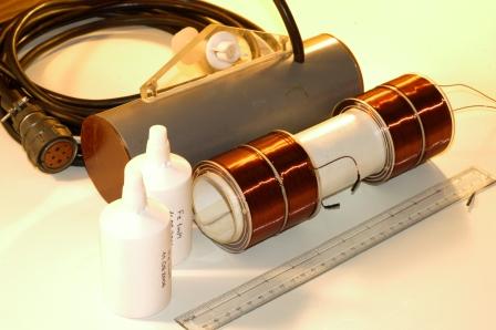

                    Winter storms are coming. So, I will continue. The most important thing is the sensor. Coil is divided for four sections. Every section has its length 32 mm. Outer diameter is 70 mm, inner 52 mm. distance between coils is 70 mm. Coils are wound using copper wire with 0,7 mm diameter. every section has 11 layers of wire, cartoon sheet is put every 3 layers to obtain well ordered winding and to lower the capacitance of the coil. Inside two plastic bottles are inserted. Diameter of bottles is 47 mm, volume about 110 ml. Bottles are located neck to neck. Both coils are wound in opposite direction. Inductances of coils are 22 mH and 22,3 mH. Inductance of sensor is 43,6 mH. This value is lower than the sum of two inductances as the result of negative coupling of coils.
                    Opposite wound coils can suppress environmental noise. In the first version, and in marine sensor, coils are wound in one direction, all sections have no gaps between them, but all other parameters are the same as described. Bottles are located bottom to bottom. This configuration is not immune to noise, but marine environment is so low noise that this fact does not increase signal to noise ratio.

                        Mike, when you say there is no gap between coils , the result is equivalent to only one single coil that fills all the lenght of the plastic tube, right?
                        In that case is-it necessary to have 2 bottles?
                        Thank you!
                        Fred.
                          There are actually four coils, two pairs of two. The ones which have no gap are probably just there to make their winding easier. The important noise cancellation is coming from the distance of 70mm between the two pairs of coils.
                          I also think that a single (long) bottle could be used instead of two. The main problem is to find such a slender bottle. I do not think that exists as such except if you built one from a long tube and two glued caps at their ends. I think two separate bottles is the most practical solution indeed.

                              Hello Fred
                              The exact explanation of coil structure is such: Sensor is divided for two coils separated 7 cm one from another. Coils are wound in opposite directions. Every coil is divided for two sections. Sections side are turned from acrylic plate 3 mm thick. Two sections are for lowering of coil intrinsic capacitance. Coil capacitance is strongly dependent on the distance between turns. More compact coil - greater capacitance - lower frequency of resonance. To lower capacitance of well ordered coil where every two turns are in tight contact you must divide coil for sections and increase distance between wire layers using paper for example. This is not so important if you have one section for every coil or two. For shorter sections it is easier to wind such coil and also shorter wire layers result in lower internal capacitance.
                              Noise cancelling is coming from opposite winding directions for both coils. Voltage induced in one coil is nulled with the same voltage but with the opposite polarisation induced in another coil. So, to have excellent noise suppresion you must have exactly the same diameter for both coils and the same number of turns. Precession signal are summed and send by coaxial cable to the input of amplifier.
