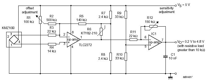

        This is requested shematic.
          Thank You
          I appreciate you posting the schematic.
          Thank you,
          Randy
            I favor KMZ51 from Philips rather!
            Typ: KMZ-51
            Company: SO 8
            Pagage: SO 8
            Voltage:
            5 V/DC
            Sensitivity: 16 (mV/v/kA/m)
            Offset:
            ±1 mV
            Measuring range:
            ±0.2 kA m
            Source: Fa. Conrad Germany
            This magnetic-field-sensor is
            more sensitively as KMZ10
            It´s my opinion!
            But, if exist more sensitively mf-sensors as KMZ51 - use the search-function from this board.
