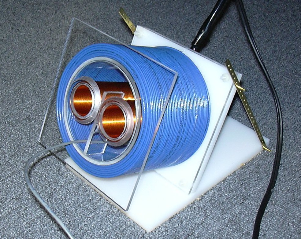

          JPG from coils
          .....the foto from the coils is not made by me, but from the website... see the first mail.
          Ap
            Beautifull coil,

              If you check Atmel's website it describes the '2313 as "mature" and "not recommended for new designs. The tiny2313 is available in a 20 pin DIP and at a quick glance the pinout looks the same.
              What is the advantage of that style of coil over a simple solenoid style?
              Rick

                  It almost sounds as though I am offending you and that is not my intent. I am only suggesting that you might not be able to buy the 90S2313 micro and you will have to use the Tiny2313. That would only mean a bit of their code might need to be changed but nothing significant. It (the Tiny2313) probably would not work any better than the 90S2313. I just had a look at Digikeys website and the 90S2313 has "call" under availability which usually means it is unavailable but an upgrade is listed. I have a working mag that uses the 90S2313 micro. I would like to compare the code they are using to mine when it is posted.
                  Right now I am working on a Gradiometer that will use a Mega162. The basic measurement principle is the same as the 90S2313. I still have a few bugs to get fixed yet.
                  I am using a simple solenoid type coil. I am sure there must be some advantage to their style and if there is an advantage to using that style they are I would probably make one.

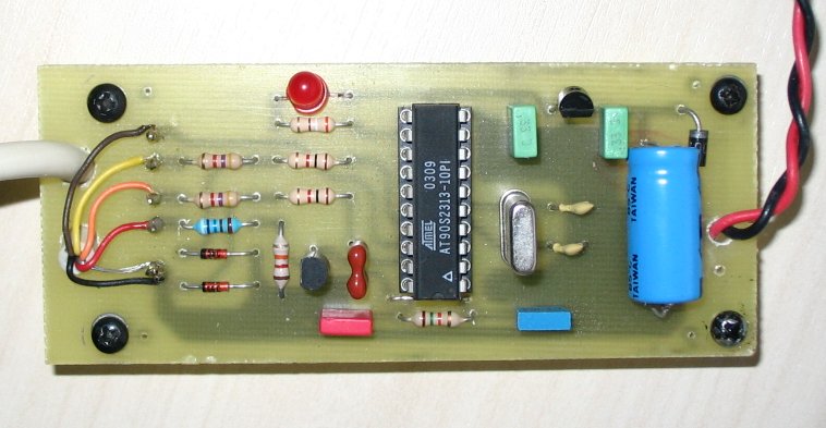

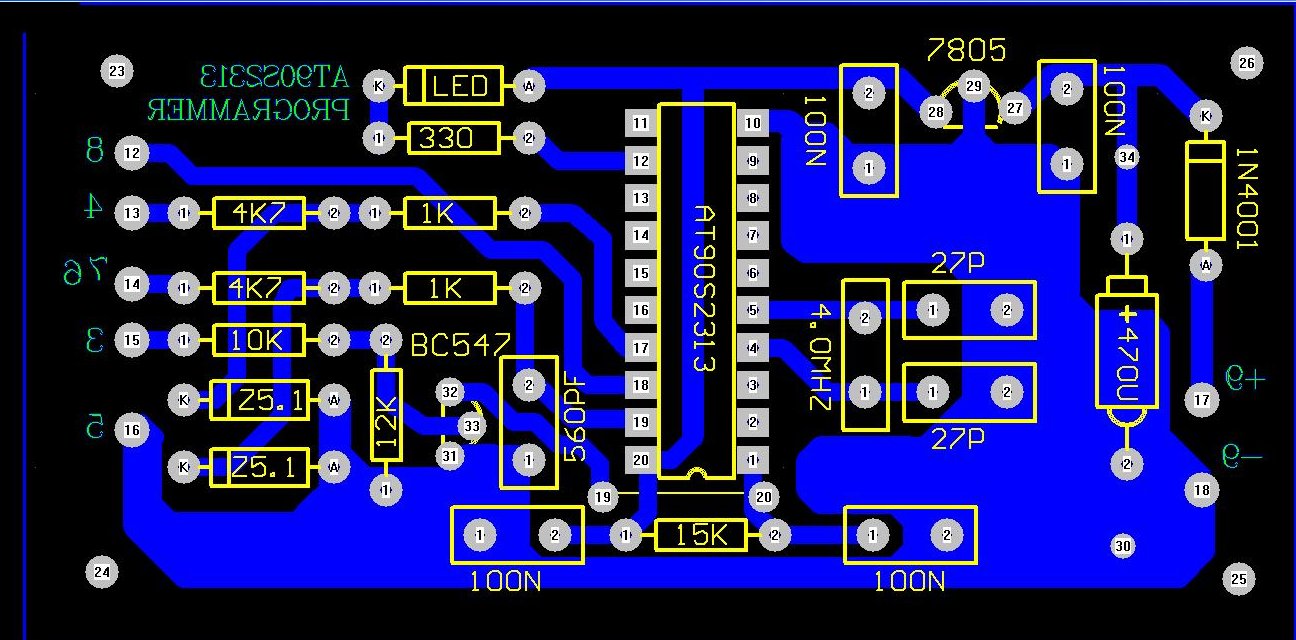

                            Progy
                            Hello Rich.
                            Some years ago I made a little pcb for programming the 90S2313, it is some sort ISP programming. The info for it I found on internet.( can not find it now..) Connect it to the com port from a pc and use ponyprog as software. As power a 9 volt batt. is used. There can be better ways.... but it works.
                            If you have some files for programming .. ?( sourse code ?) I like to tray it !
                            I am not a expert in programming but like to experiment with it in the time to come.
                              I checked on this computer and I do not have the source code for the 90S2313 on it. I stopped working on it a couple of years ago and moved to the mega162. I will have it on a cd or on my old computer. I will find it and send it, hopefully tomorrow.
                              It is done in Codevision and I have no idea how it will work with any other program. There are 3 versions of Codevision. I use the Evaluation version and it is free so you may be better off to download it to your computer. Your programmer sounds like it is setup similar to STK500. I have a power supply that my son built instead of a battery.
                              Give me a day or two to find the code and I will try to post it as an attachment. I don't know if you can do that or not but I will try. You will be able to open it in Notepad or similar program and then just copy and paste it to Codevision. You will have to start a new project in Codevision first. It has good help files so it should not be difficult. Even I managed.
