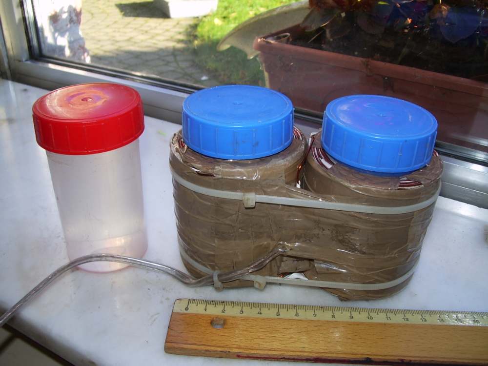

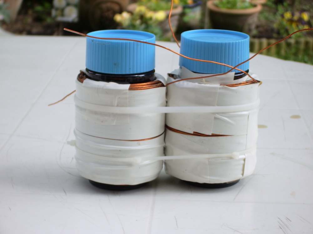

            There is no fixed type nor parameters for sensors to work with this PPM front-end design. It all depends on the usage you want to make of it. It is however true that there are some minimum specs to be defined in order to get acceptable results in terms of SNR.
            Jim and I have published two different Excel calculators to be used to experiment 'What-If' scenarii and calculating the expected SNR, Signal Magnitude, Weight, Current,...
            We first have built and experimented toroid sensors of various sizes (and weight) assuming that those were the best in terms of noise resilience and lack of directional behaviour.
            Now, we are routinely using two-coil solenoid sensors which are much easier to build and accept interchangable fluid bottles. Finally, and most importantly for mobile surveys, they are reasonably multi-directional when used in our latitudes where the vertical field vector is, by far, the most powerful. It means that, provided you keep your coils horizontal, they can be put in any direction without too much influence on the signal magnitude. During my surveys, I do not care any longer about the direction of my sensor while I walk the rows of the survey grid.
            Now, to be precise, my own sensors are built around plastic lab sample bottles of about 125ml (useful winding area = 75x50mm). The coils are made of around ten layers of 1mm wire and the polarization current is around 1.2Amps. We are using Isopropyl alcohol which is the one giving the best results (i.e. the highest signal with the shortest polarization duration) in our experiments.
            The two coils can be fixed side-by-side for the noise cancellation but it is also possible to choose a common axial configuration which is more favourable to be mounted inside a fish for underwater surveys.
            See the attached pix.
            I hope these few comments will help you.
