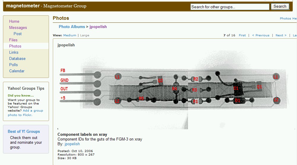

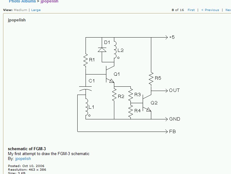

    Hello Ivica.
    On the Yahoo magnetometer site is more info, look at the photo's from jpopelish.
      Wow! This gives some picture!
      Thanks much!
      I can not approach to files there, i am not a member. Are there any more interesting files?
      How to distinguish component values?
      Anyway Thank you very much!
      Any further information is more than welcome!
      I was thinking to make my own sensor but to take FGM3 as starting point and further to experiment with EPE project. Also i do have my own ideas, but will discuss those later when experiment a bit more...
      Regards!
        Looks like the sensor is exactly like what is described in Don's article. The oscillator seems to be using the core in feedback mode.

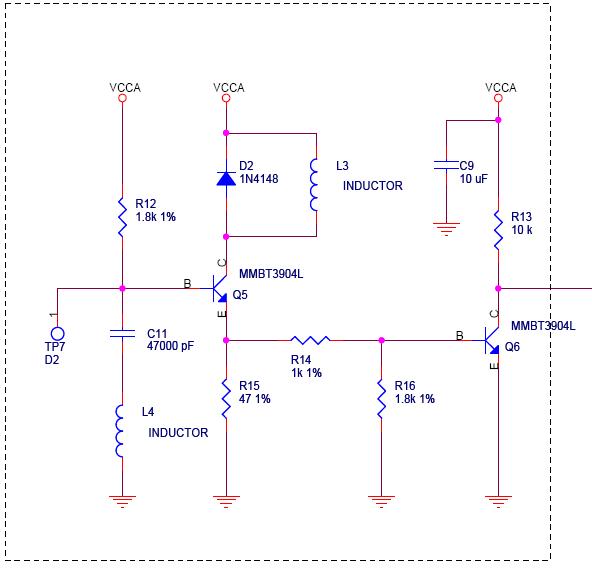

          Hello ivonic here FGM3 the circuit with component values
            Hi;
            can make the value of coil will be great.
            best regards.
              Well, the 2 schematics are not quite the same. Cap C9 is no big deal, just a large decoupling cap for the 5V supply coming over a line of indeterminate length an location. The placement of FB or TP, depending, is important if we want to reverse engineer the device. In Korrigan's drawing, TP taps the junction of Q1's base and C1. In the other, FB taps the junction between C1 and L2. If the latter were true, FB could be used to bias L2, perhaps adjust the balance between the 2 coils for zeroing out stray fields, improving linearity, correcting for temperature, whatever. I can see no use for TP other than a test point; for what purpose, I know not.
              Otherwise, it seems that most of the circuit is an oscillator. Using the former schematic, I'd say that C1 is charged until the voltage at the base of Q1 switches the transistor on. Then, current flows through L1 to ground through R2,R3, and R4. The base of Q2 goes high, and it switches on, bringing Vout to ground (0). Presumably, C1 is also discharged through Q1 bringing down the potential at its base, and starting the cycle over again since this turns Q1 & Q2 off, bringing Vout up again. This creates an oscillating field around L1. I'm not sure what happens with L2. Presumably, current flows through it while C1 is charging and in the reverse direction when it is discharging? The x-ray seems to show that L1 and L2 are wound coaxially, which presumably allows the ambient magnetic field to be sensed, and perhaps couples them together like coils in a transformer. I really don't know. Any help would be much appreciated.
