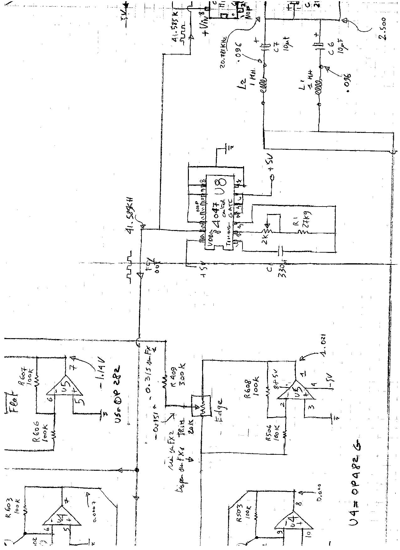

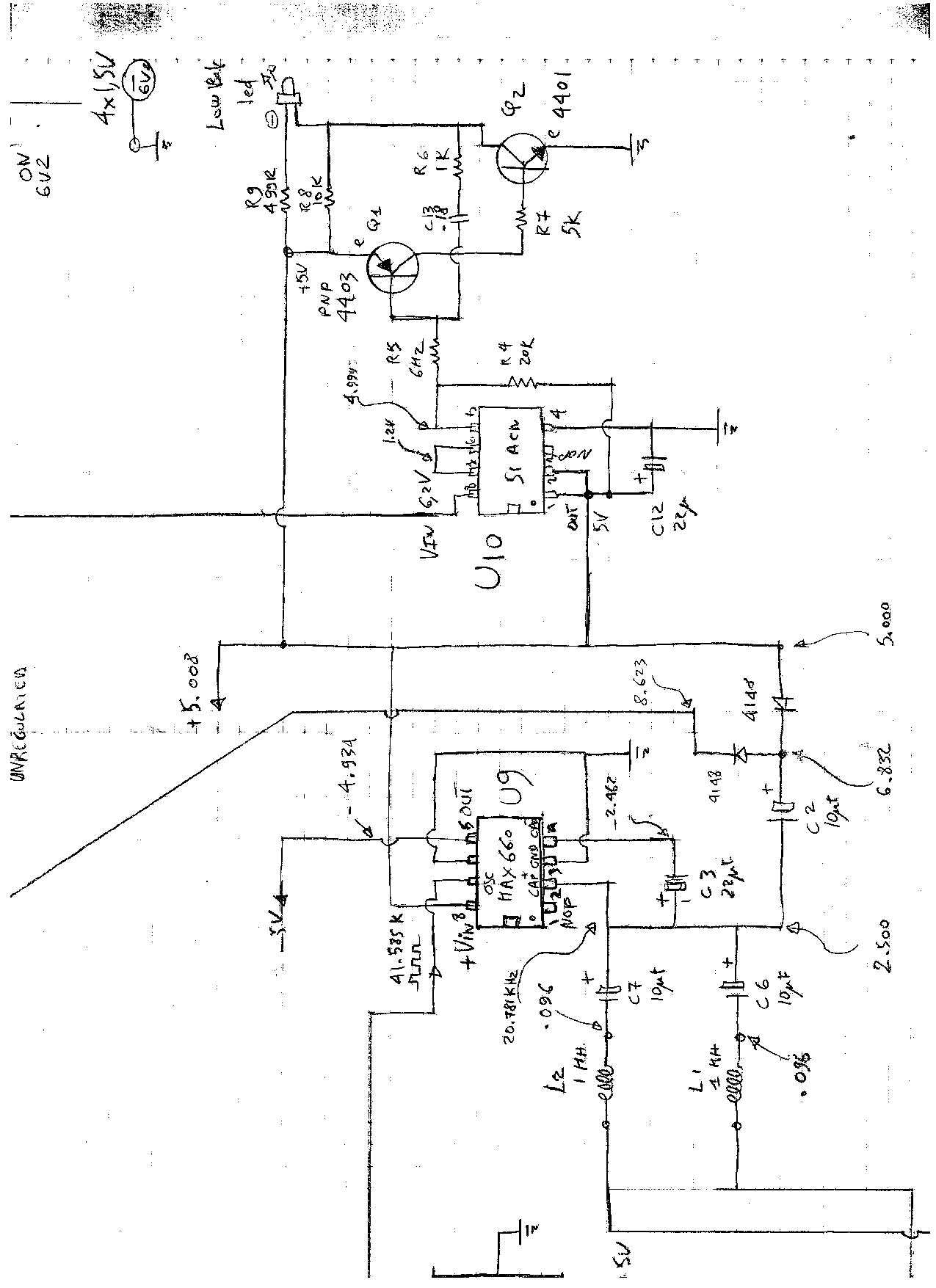

    I'm Curious, Does anyone have a Schematic for these types of devices?
    Apparently they can detect Survery Pins and other objects that made of steel, cobalt and nickel, up to 4 feet deep.

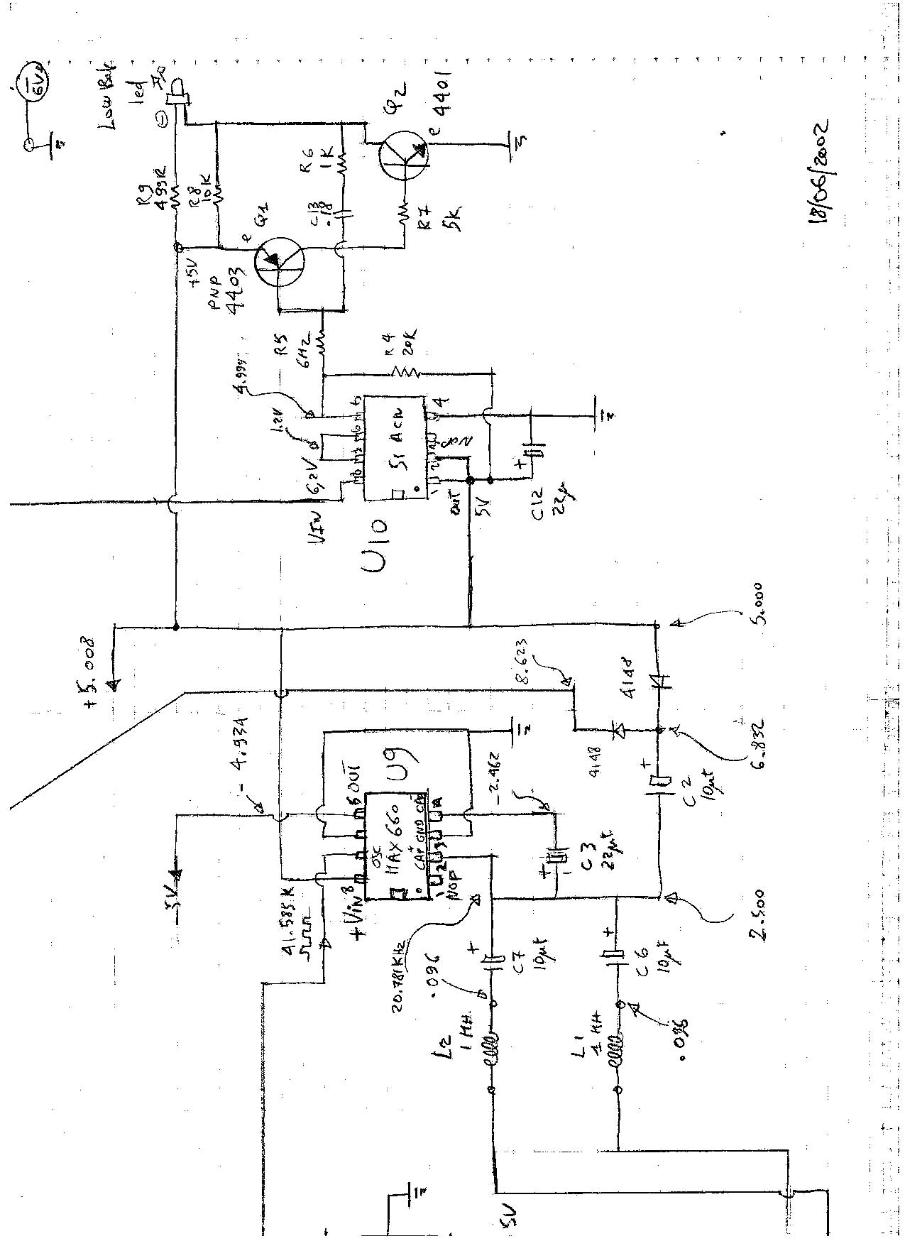

    Hello Chemelec,

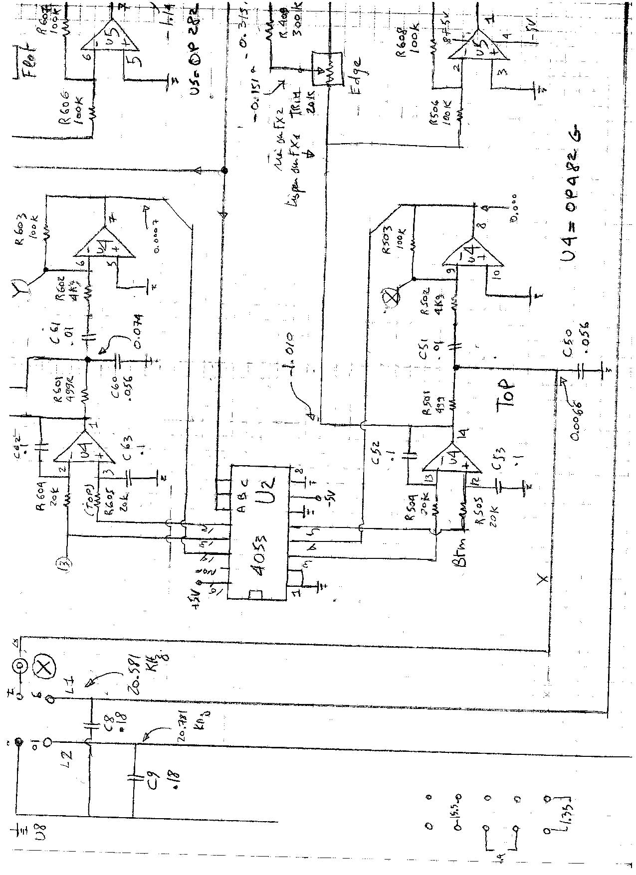

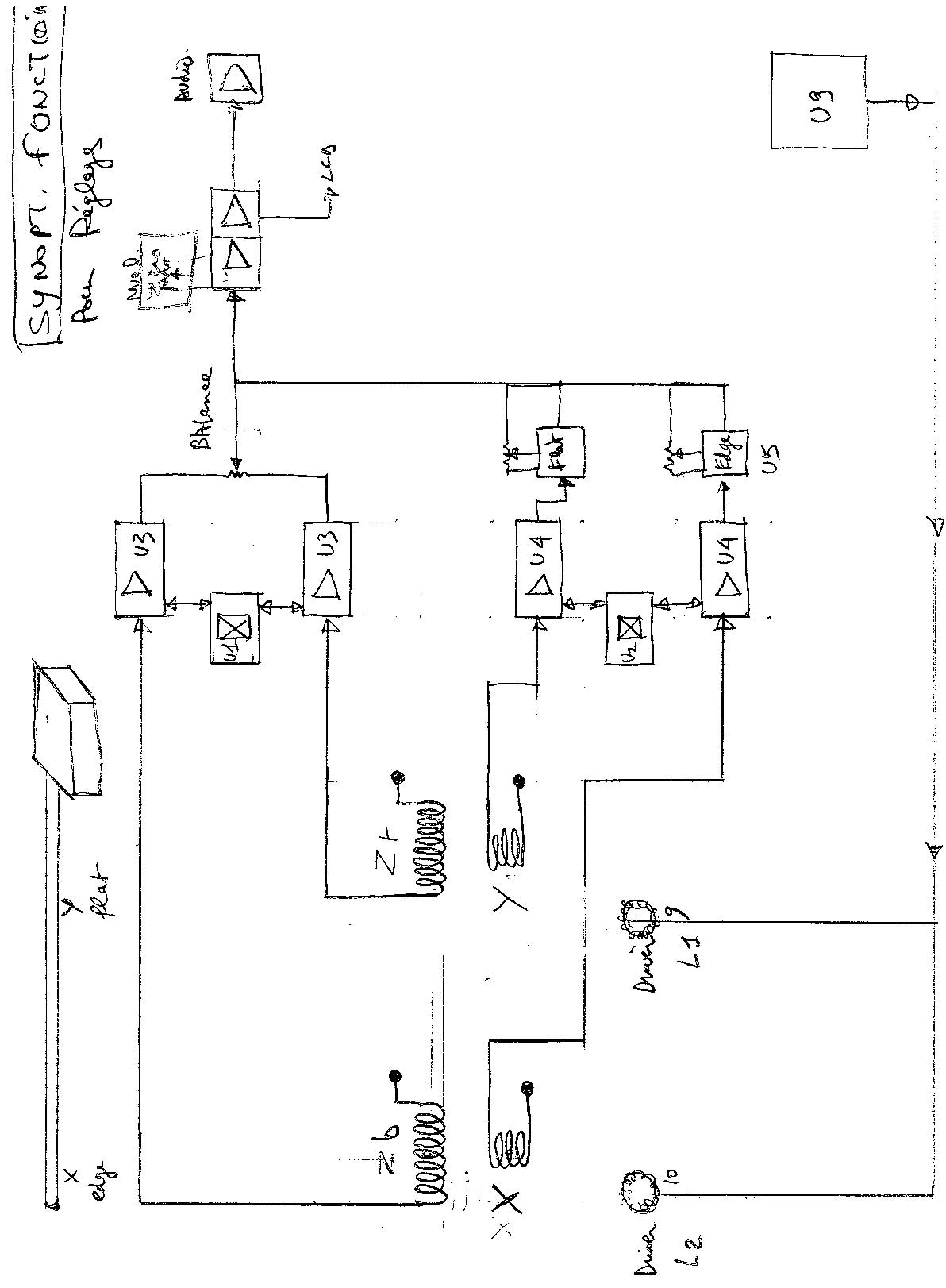

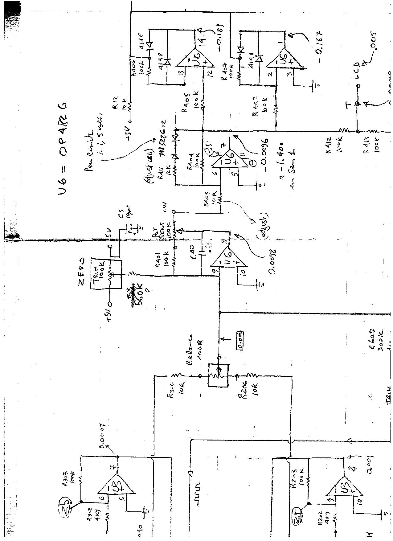

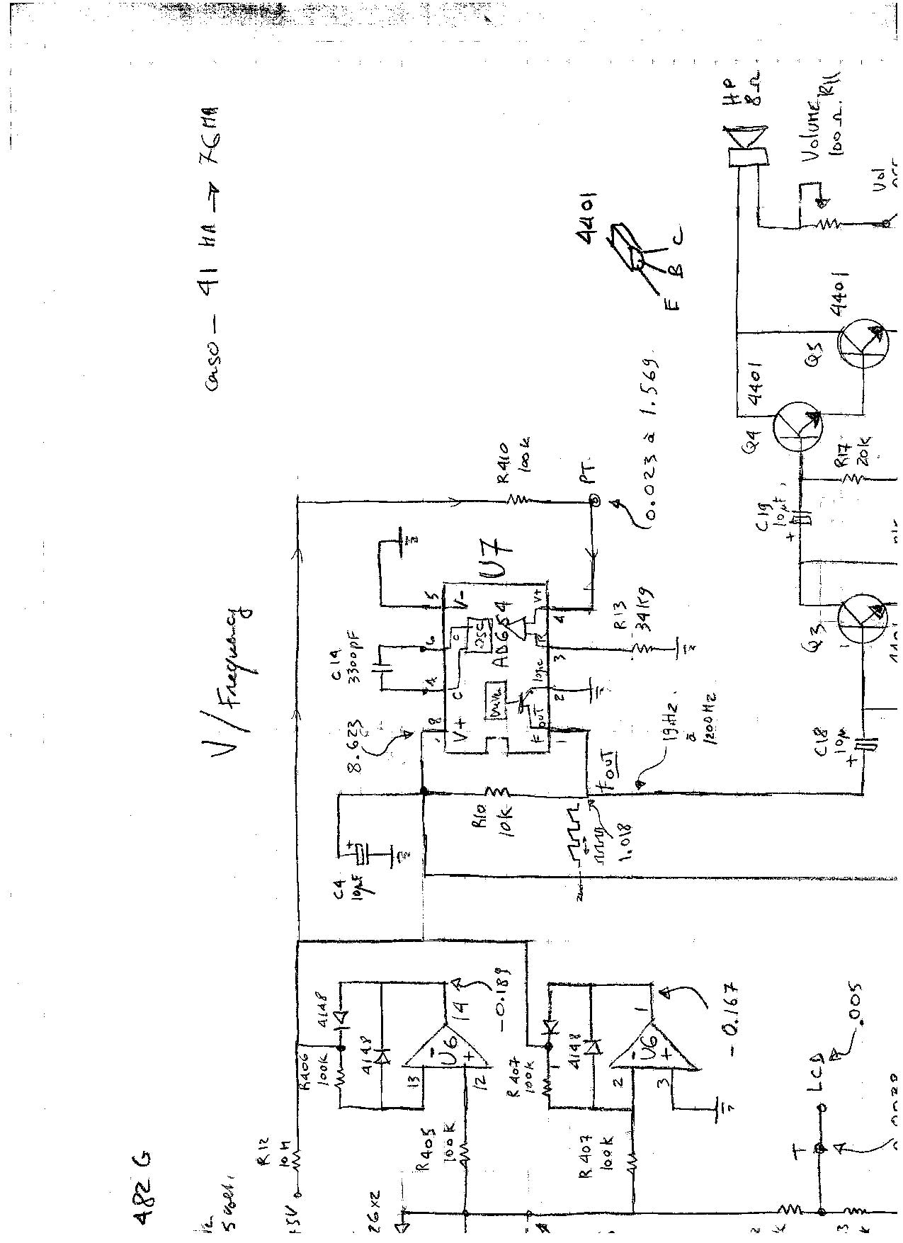

    Many years ago i reverse a very good magnetic locator
    http://www.magneticlocator.com/
    I make it but the problem it is the sensor : special ferrite with special permeability for it size, very difficult to have perhaps military for submarine use , This guys of Magnetic locator have access to it ...but i can say you it is very well made , and very sensitive if you want i can send here my HAND SCHEMATIC a little difficult to read but you can see and evaluate the complexity of it...

                Hi Alex and Gary,
                Alex thanks for the diagrams, I bought one of these on ebay and wanted to reverse it.
                Gary, Alex is right the sensor is complex. It is a helically wound mu metal tape, about a perfectly straight ceramic rod. There are two sensor which create gadiometer and operates as a fluxgate magnetometer. Schonstedt has three or four patents which give a good explainations of these sensors. Sorry I don't have the patent numbers. A Google search "Schonstedt" should find them.
                I plan on updating the electronics in my unit. The design looks to be 1970's. I am also playing with some High mu tape wound torroids and have functioning ring-core sensor and bread boarded flux gate circuit. The problem in all the gradiometer designs, is sensor allignment.

                    I Joined all those Pic's together and Changed it to a 1 Bit file.
                    (True Black and White)
                    This now prints on an 8.5 by 14 inch paper.
                    Its Quite Small But Clear and Readable.
                    EDIT: I Tried to upload it Numerous times and it said it did it, But the picture would not come up on screen. (OH WELL.)
                    Maybe This will work:
                    http://www3.telus.net/chemelec/Temp/Mag.png
                    And not that it Matters much, but Some of the Circuitry is Missing.

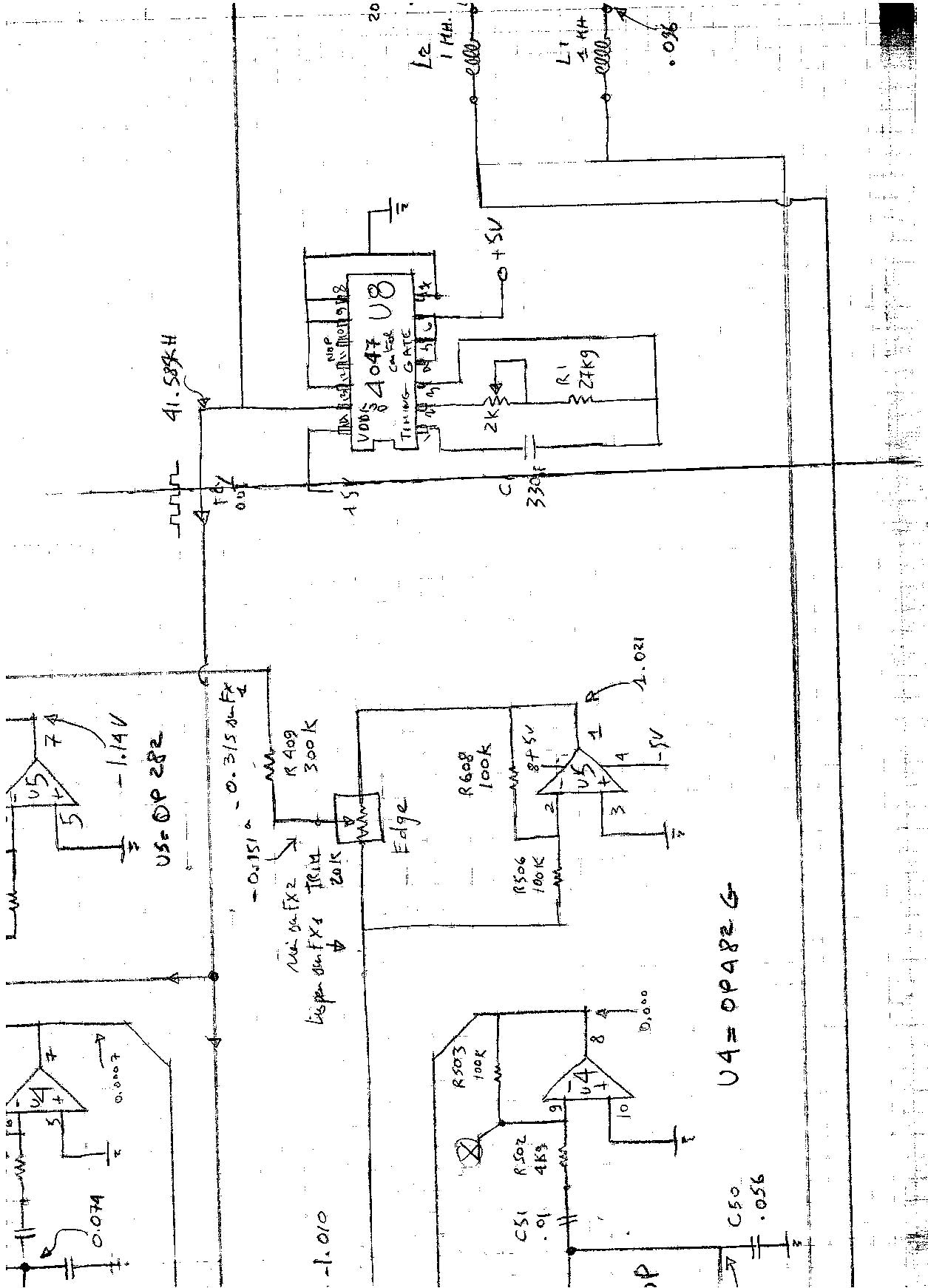

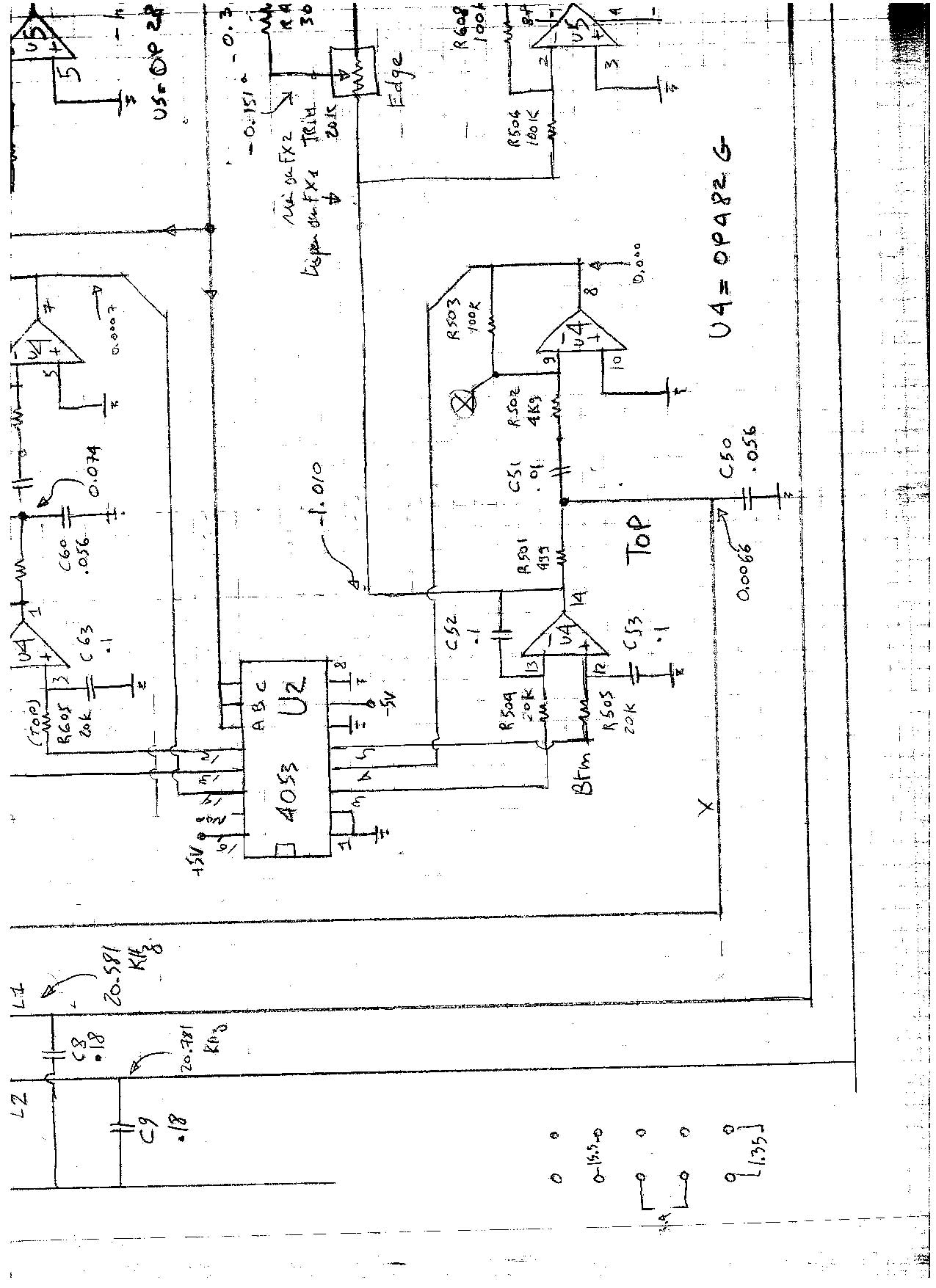

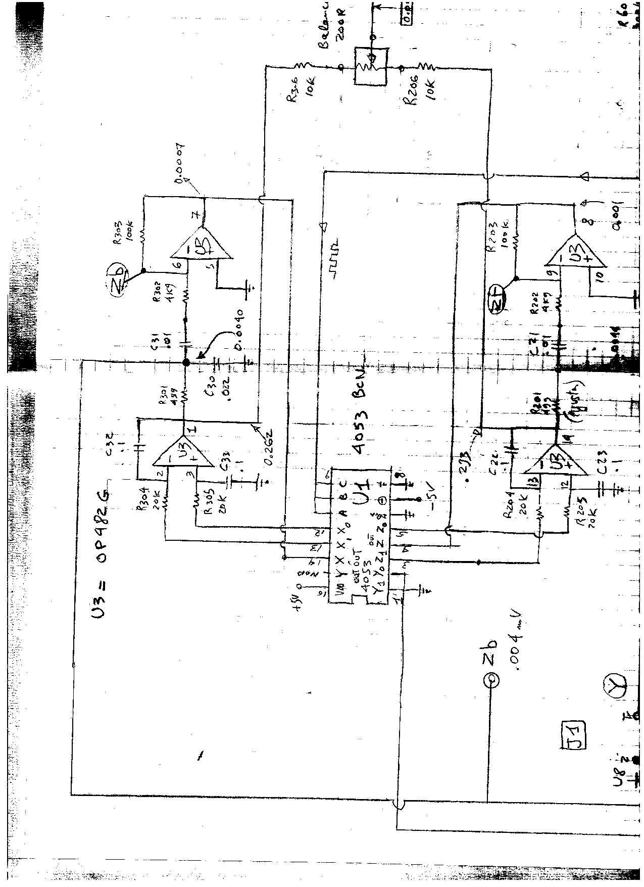

                        this is the map to joint the schematic use Mag 1,2,3,4,5,6
                        I repeat 7,8,9 because 2 lines in the bottom of the schematic are not visible in the copy 4,5,6 sorry
                          Alexis......1, 2 and 3 are chopped off at the bottom.
                          Gary
