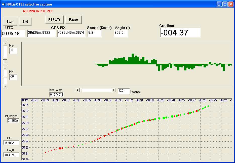

    a. The PPM supports a new feature: 'Journal Option' which generates one line of text on its serial line per PPM reading in parallel to its storage on a grid file on SD Card.
    b. We have written a Windows-based PPM/GPS multiplexing program which receives the PPM data stream from one of its COM port, receives the GPS NMEA0183 data stream from any external GPS device through another COM port, merges the two streams into one single survey line per second and stores it into a file on the laptop. As a further option, the program can also re-emit the NMEA stream to a third COM port to feed a GPS-supported GIS program to show the boat survey path on a geographical map. As the current laptops do not support any RS232 port any longer, the COM ports are simulated by small (and cheap) USB/RS232 converter boxes.

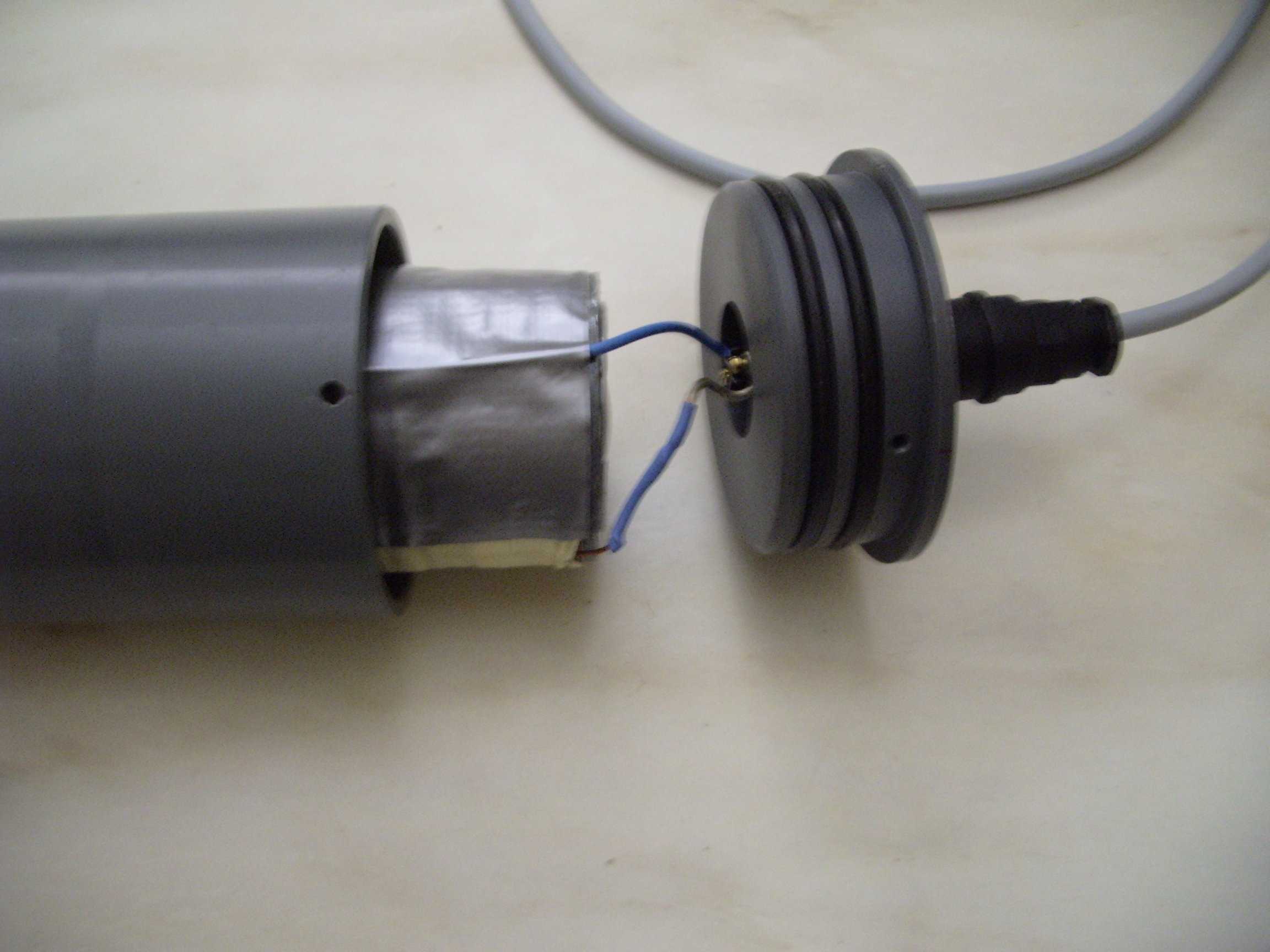

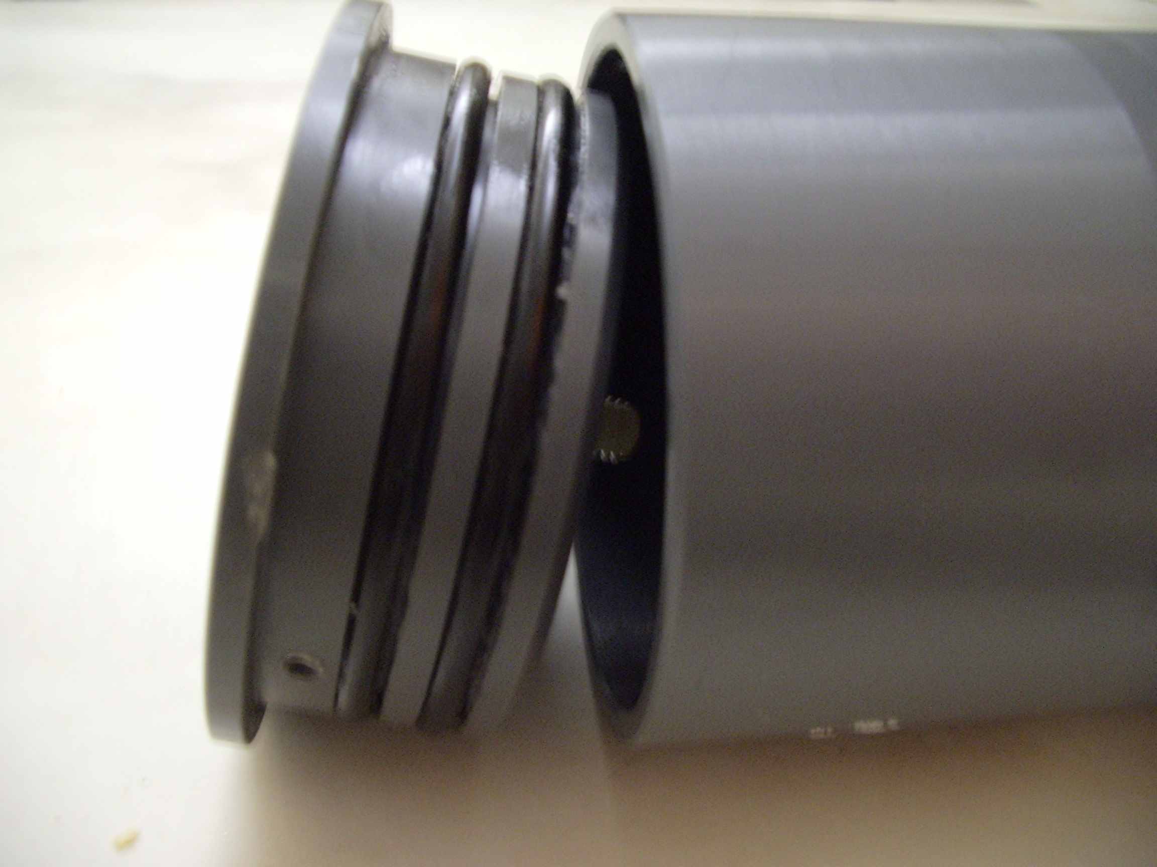

    3. The sensor has to be inserted into a towing fish under a pressure-protected ccntainer.
    We have found that it is not really necessary to make the complete fish as a pressure-protected ccntainer. We are designing a small container with its dimensions selected to fit our sensor coils in in-line configuration. It is built from a section of high-pressure PVC pipe (90mm outside diameter, 7mm thick walls) closed with two machined caps each with double O-rings. The cable goes through an IP68-rated connector guaranteed to support 100m depth for several hours. The sensor container just needs to be inserted inside a fish made of simple PVC pipe with a nose and fins on which the lead weights and the towing cable have to be fixed.
    This is a work-in-progress which is being built as a first prototytpe. The sensor container will be depth-tested first on a deep lake here in Belgium and then, the whole system will be experimented first on the lake,then, at sea..
    Any comment or remark is very welcome.
    Willy
    underwater sensor container
    This is two pictures of the pressure container we'll use for submarine work.
    Willy

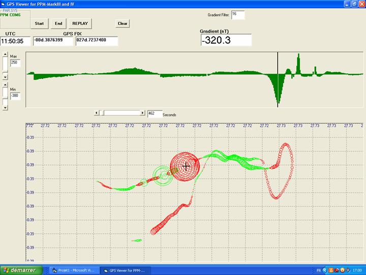

      PPM GPS Mixer
      This is a screen dump of the PPM/GPS mixer program.
      This shows an example of replaying a data file captured before in real-time.
      Willy

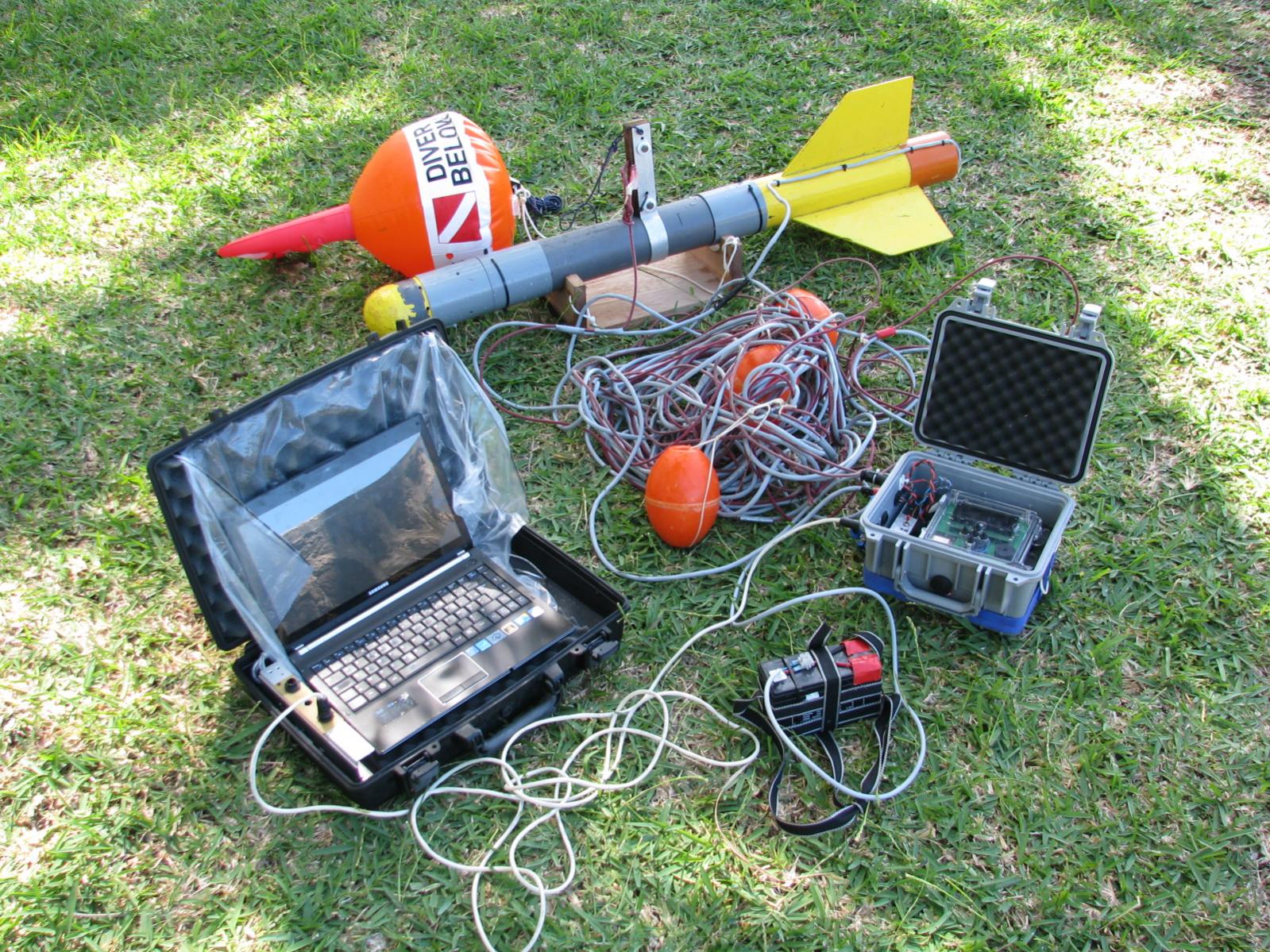

        PPM-MarkIII for submarine work
        Our first prototype of PPM for underwater surveys is now completed and system-tested 'in the air' with a length of shielded cable of 50m. The pressure container has been tested for water tightness (though not very deep).
        The real-time PPM/GPS data mixer program is also operational.
        The whole system is going to travel to Mauritius Island at the end of this week to get baptised in sea water.
        Willy
          It will be intresting to see the test result.

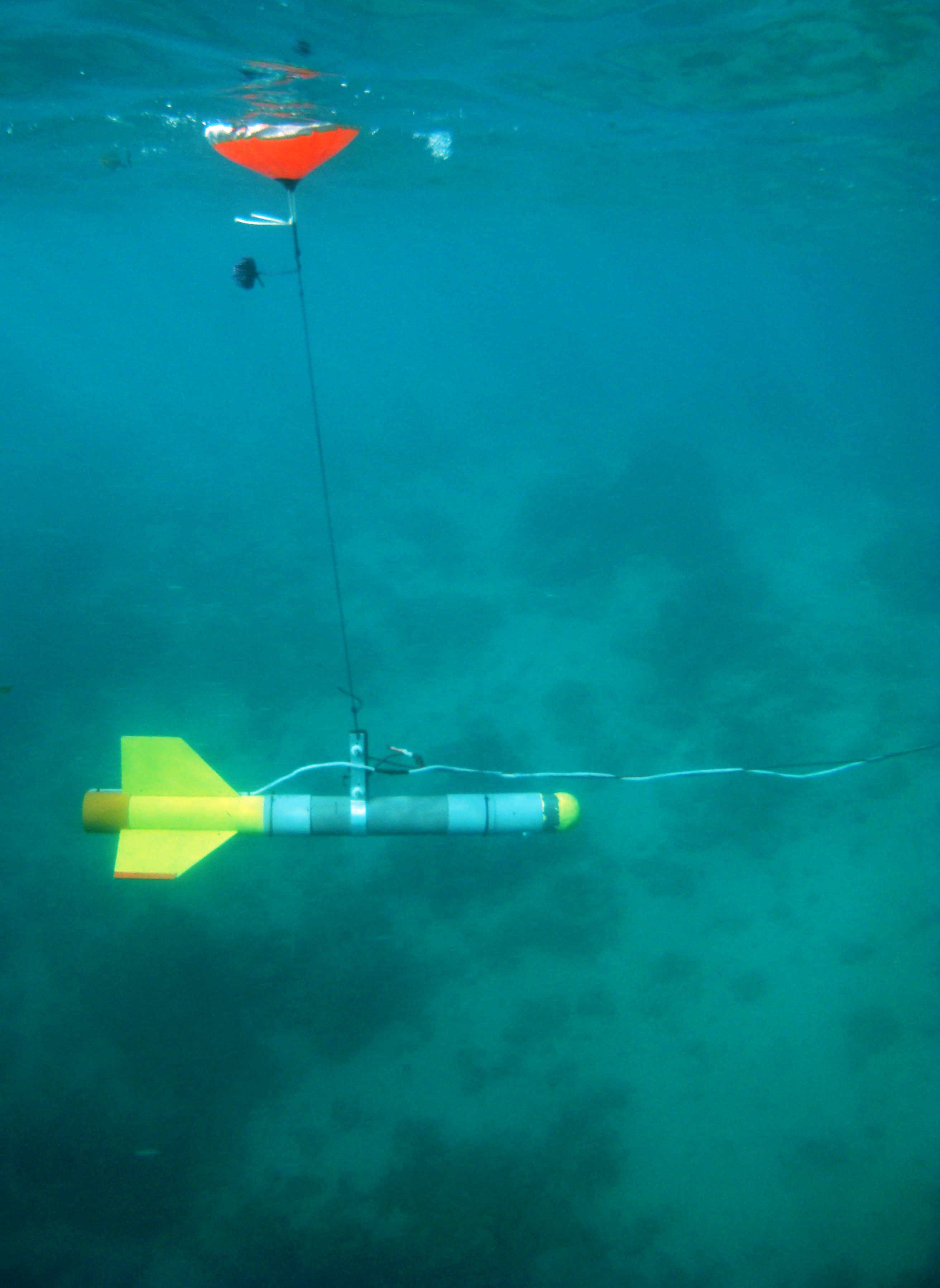

            Marine PPM pictures
            This is two pictures of the fully assembled MarkIII system being tested in Mauritius Island by one of our clients.
            Willy

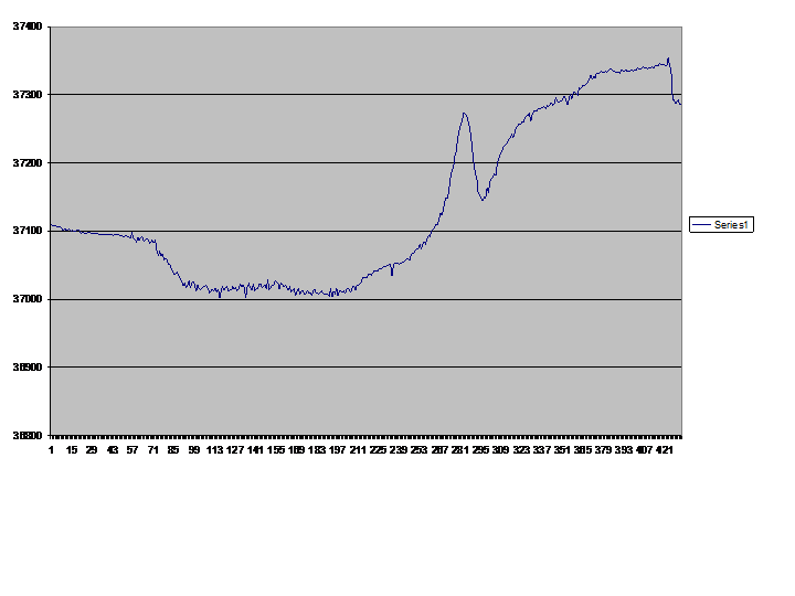

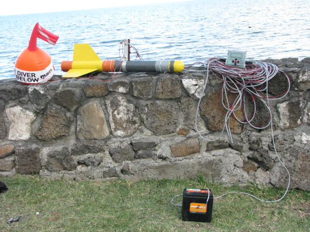

                Results of a first survey track at Mauritius Island
                This is a first experimental survey in Mauritius over a known shipwreck sitting at a depth of 10meters. It is an old wooden boat but still with its cannons nearby.
                The fish was flying at 1.5meter deep.
                You can see the slow but large filed gradients due to the variations of volcanic ground composition and then, the very recognizable double peaks made by the cannons seen by the PPM as a magnetic dipole.
                This survey has been made with a separate GPS logger and the data from the PPM has been mixed with the GPS log using a PC program.
                The next experiments will be made with a GPS device integrated in the control box to directly mix the PPM data and the corresponding GPS fixes.
                Willy

                    Results of a shipwreck survey at Mauritius Island

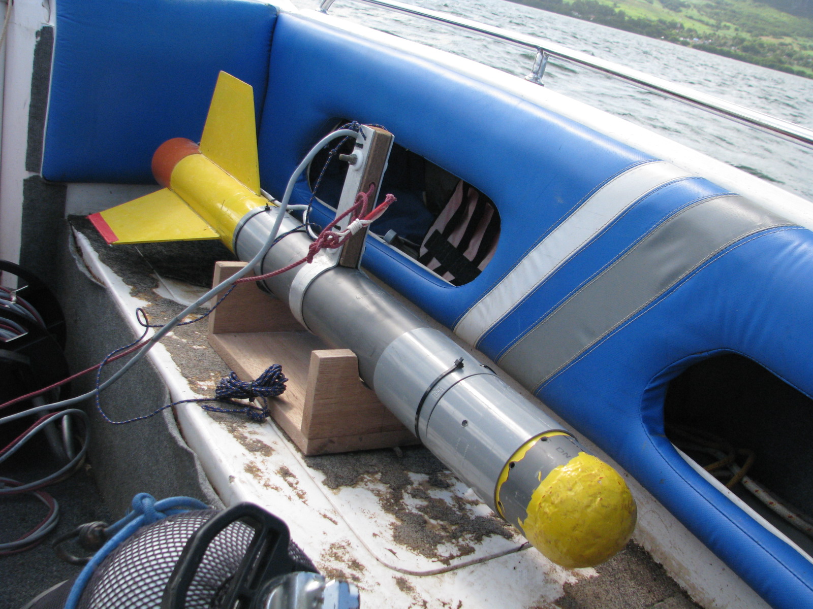

                    Hi all,
                    I have received a report of a part of the latest surveys at Mauritius from one of our clients together with a few pictures of his PPM MarkIV equipment.
                    Here it is.
                    The large field gradient on the plot is the spot of an old wooden ship sunken 10m deep. The actual target is quite certainly a bunch of cannons and, possibly, its anchor.
                    It is obvious that the GPS fixes have been converted to avoid any 'curiosity'.
                    The fish is kept at a given depth by a buoy. Its hydrodynamic behaviour is perfect at the normal speed of the boat.
                    Willy

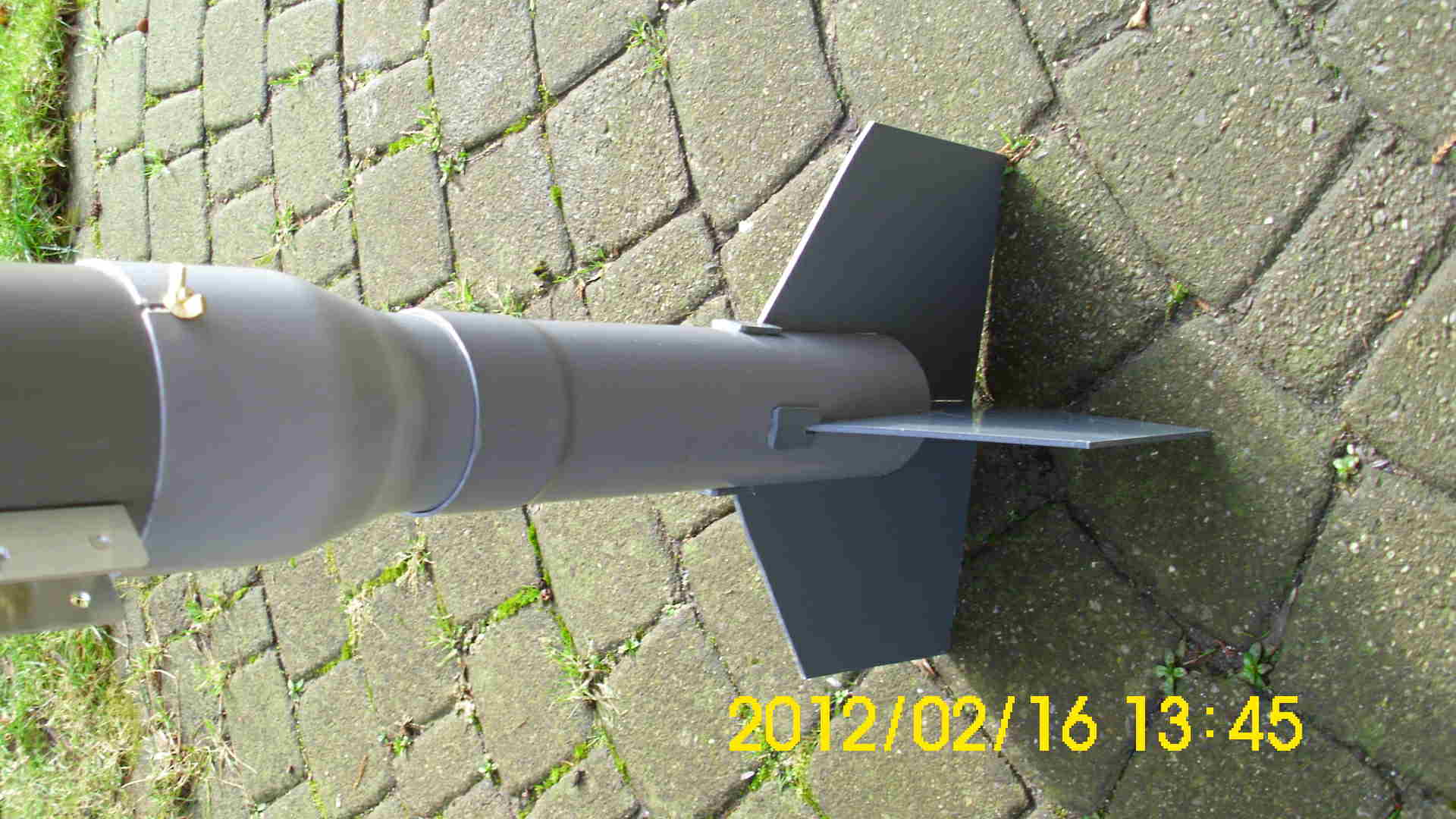

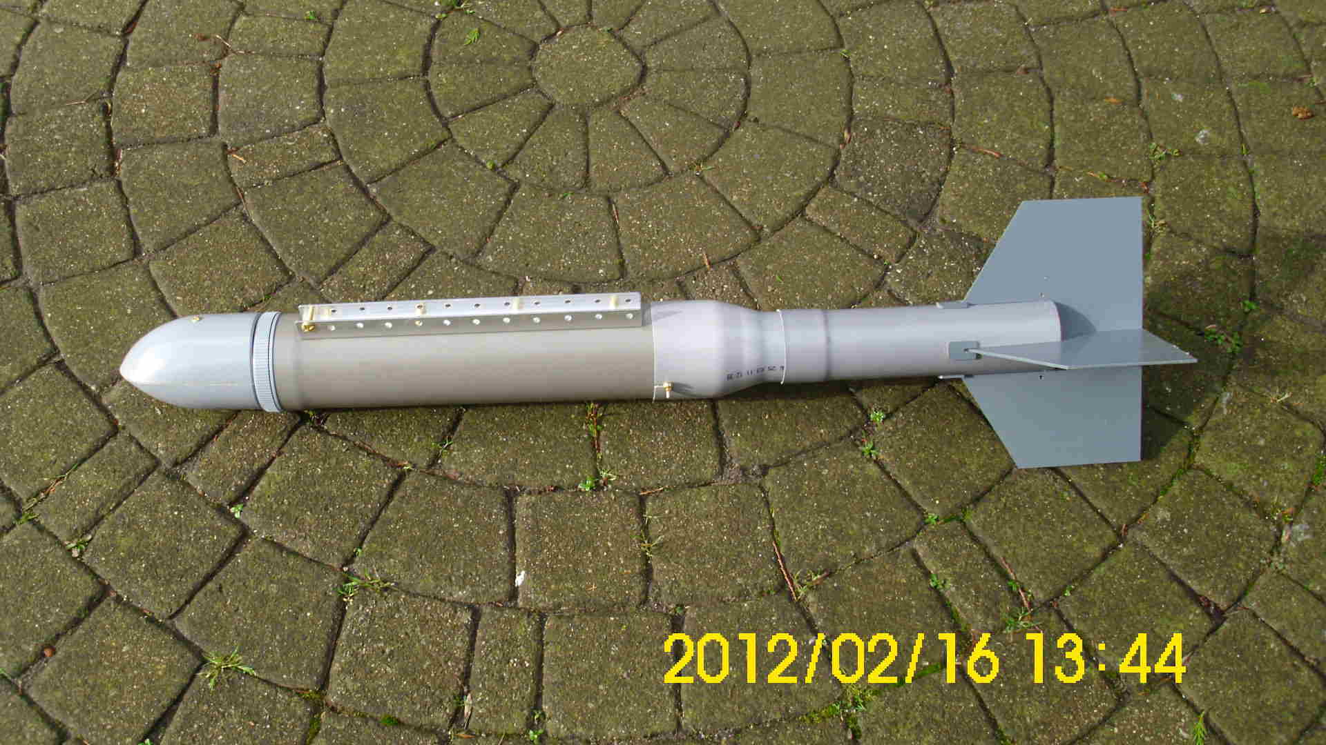

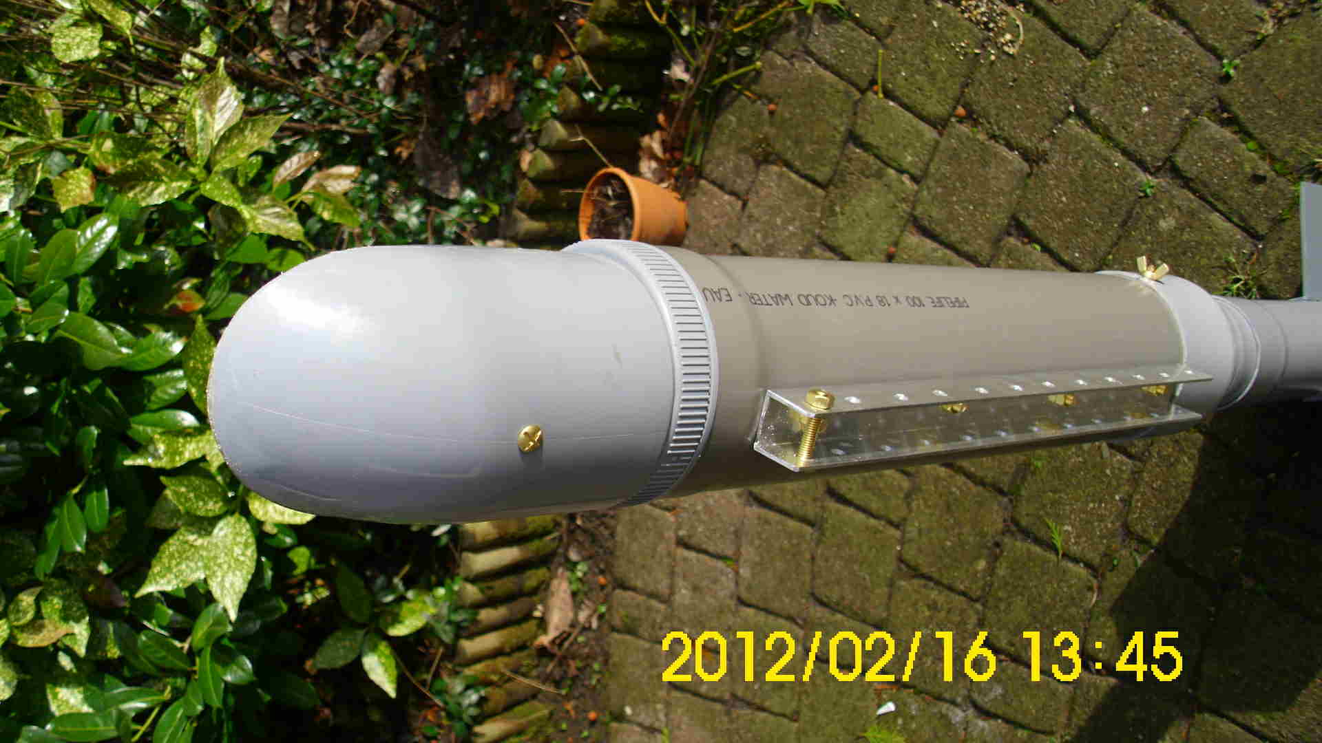

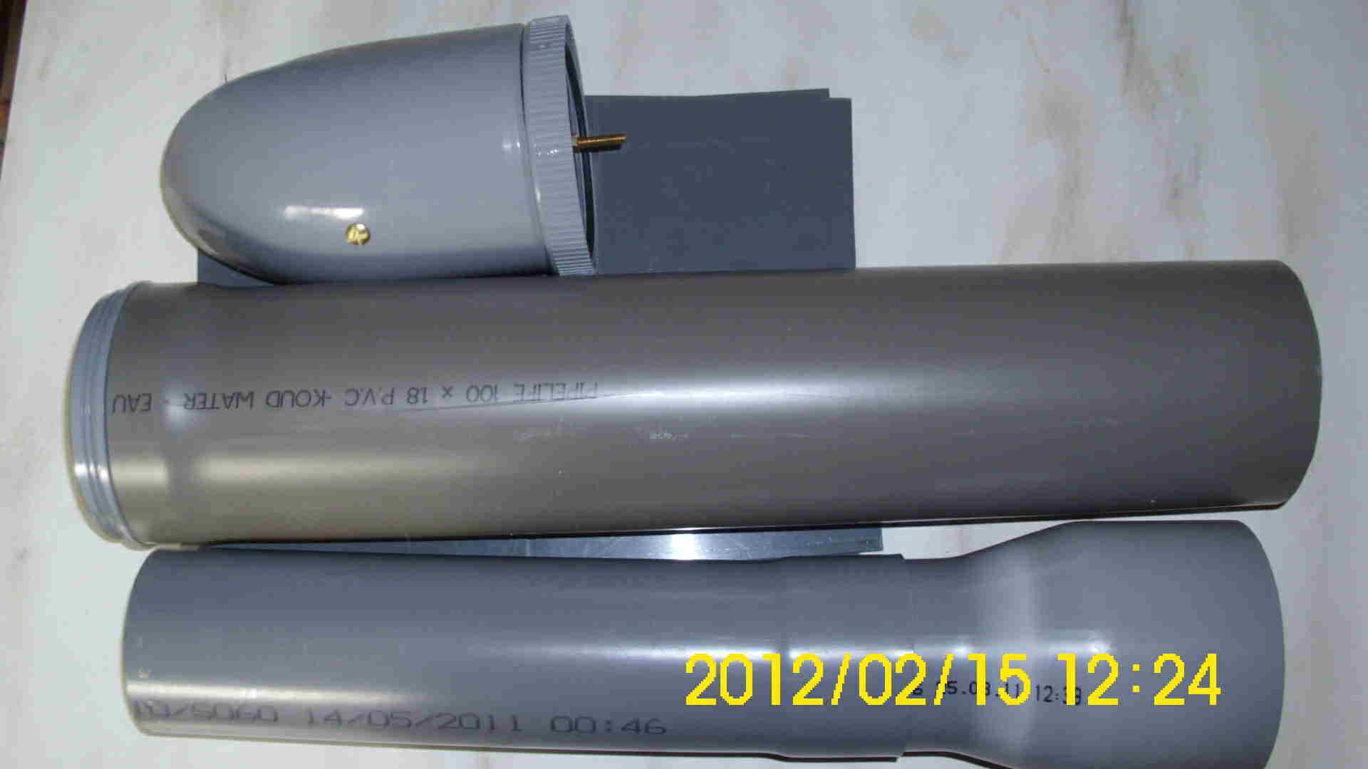

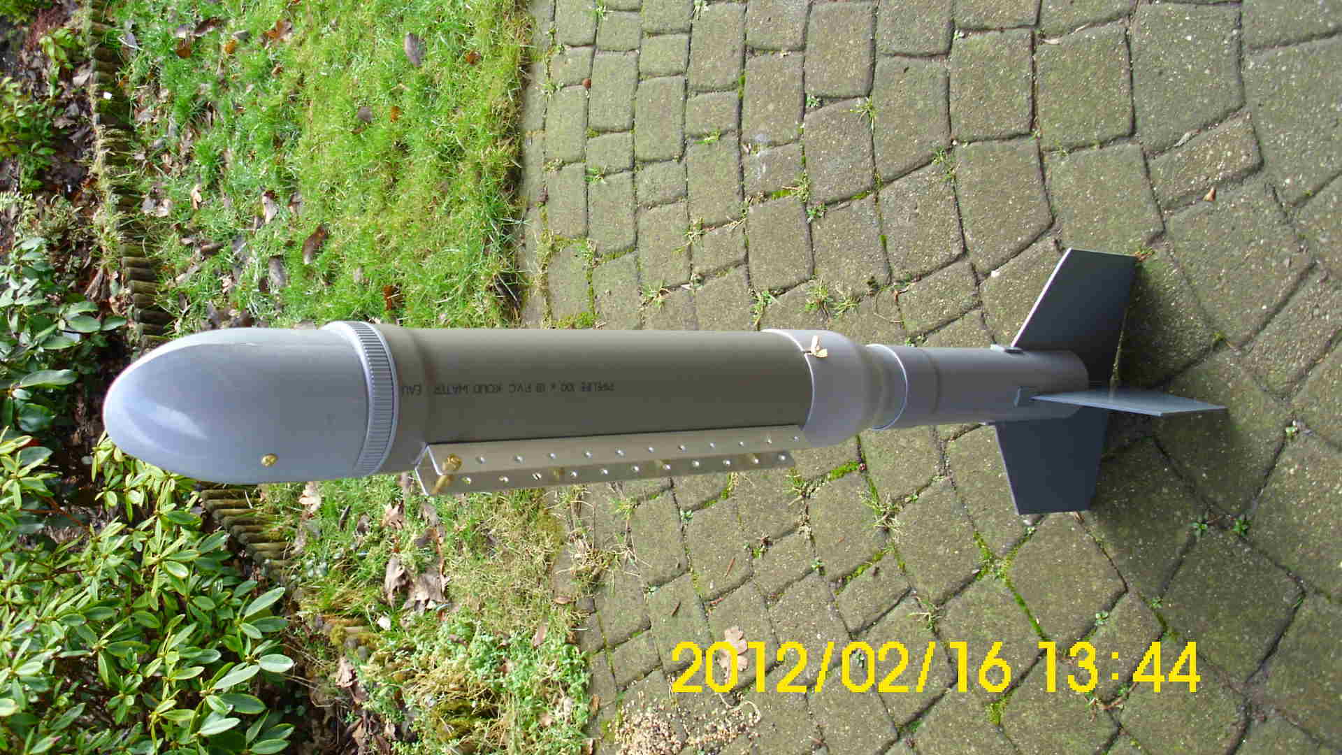

                            This is a few pix of our first fish.
                            Note that this version has a slightly different design than the design drawings published before. It is now simplified and it has been specifically modified to be easily removable and re-assembled without any special tool.
                            The nose has been designed with a large compartment to contain an adjustable number of lead weights to balance the fish together with the selection of the hole on the cable attachment 'U' rail.
                            The overall length of the fish is 1100mm.
                            Willy

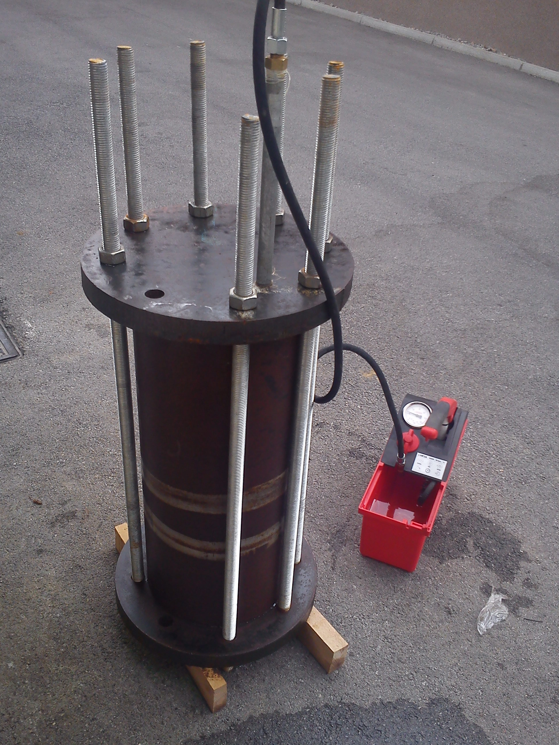

                              Hi all,
                              The production version of our watertight sensor container has passed with success a depth test of 5 hours at 11 Bars (110m deep) using this pressure testing machine.
                              Willy
