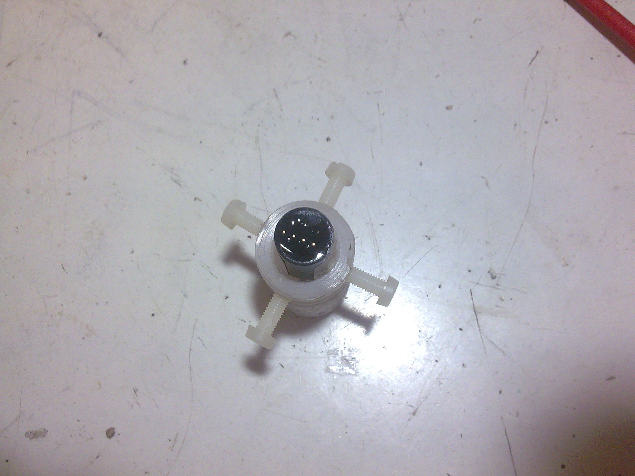

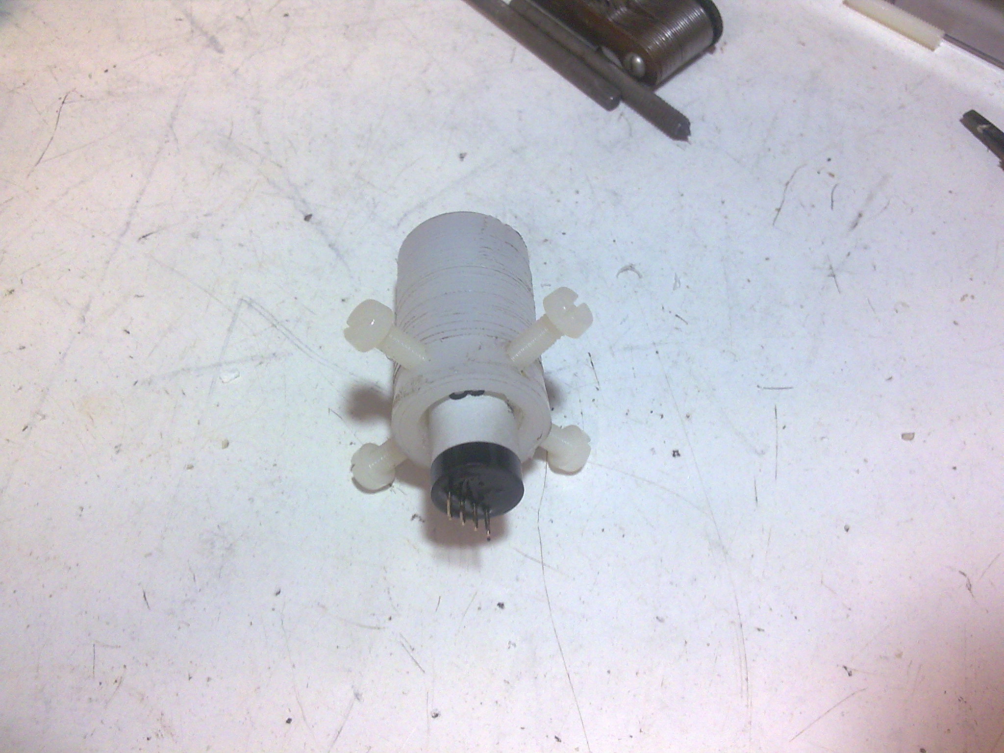

    I add here 2 photos of the teflon with screws that help to regulate my Gradiometer.
    My friend Epitopios wanted to see it!!!!
    Πανο μελετατο......
    Hi Geo
    1. I think these pads are not bolts from the metal!
    2. Do some shorter screws will not clog.
    3. You screw me do not give anything, struggled in the sensor teflonie tight, then I turned round in a Teflon housing for a minimum differential signal.
    Of course, the gradiometer measurement in free space (EMI), directed east-west, 1.5 m above the ground.
    No ticks or mobile phones in the area.
    Best regards Chris.

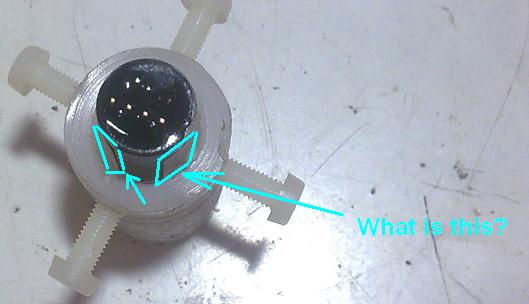

      What is this? From what of material is this thing around the sensor?
        It's sensor label
          Originally posted by Crowbar View Post
          It's sensor label
          Thank you. If so, then probably need some lining under screw to easily regulate position of sensor.
              I don't think that it need something more!!!. You do the regulation only one time!!!!
