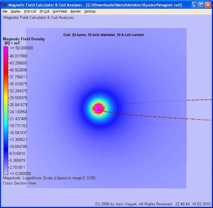

            Hi Michael,
            I want to encourage you with the following rough calculations again. Some other guys should be surprised about it though.
            Again a comparision between a PI coil and magnet coil:
            PI coil:
            Number of turns: 22
            Coil diameter: 10 inch
            Coil current: 10 A (we use a strong PI machine)
            Inductivity: approx. 300 µH
            Target is nearby the coil wires, magnetic field is changing in the time domain
            The coil will induce a magnetic field density of approx. 30 mT (see below graphics) at the coil wires (we need 5 mm minimum distance to the coil wires and let saturate the coil current to 10 A). We let damp the magnetic field in about 5µs and get a dB/dt = 30 mT/5µs = 6000 T/s (dB/dt = magnetic field change, that is really huge).
            Now let us make the calculation for a magnet coil if we can get a 6000 T/s slope for equivalent eddy current stimulation.
            Magnet coil:
            Magnet field density: 1 T (neodym type, easily achieveable)
            Magnetic field is stationary (not changing in the time domain), but the target is moving
            Lets assume, we have still 1 m/s coil sweep and the target is small (1 cm) and is passed over the magnet coil. As we know, the magnetic field is rapidly diminishing, if the distance to the magnet gets larger. Lets assume, that the target is sensing almost the whole magnetic field within 5 cm distance. The target takes 5cm/100cm/s = 1/20 s or 50 ms during this time and we have a magnetic field change of approx. 1T/50ms = 20 T/s.
            Bad comparison?
            The PI coil is 6000 T/s / 20 T/s = 300 times better.

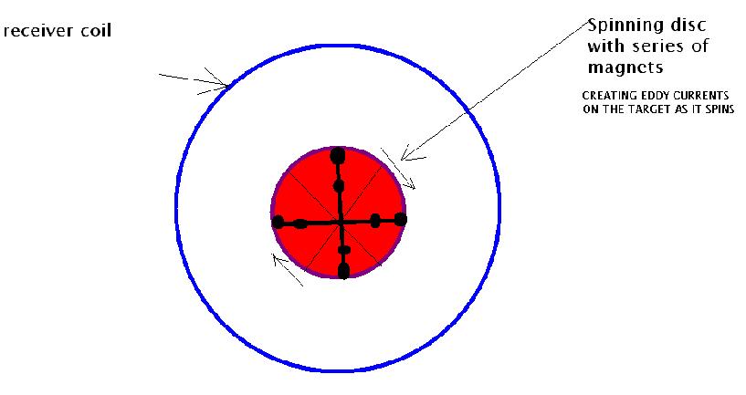

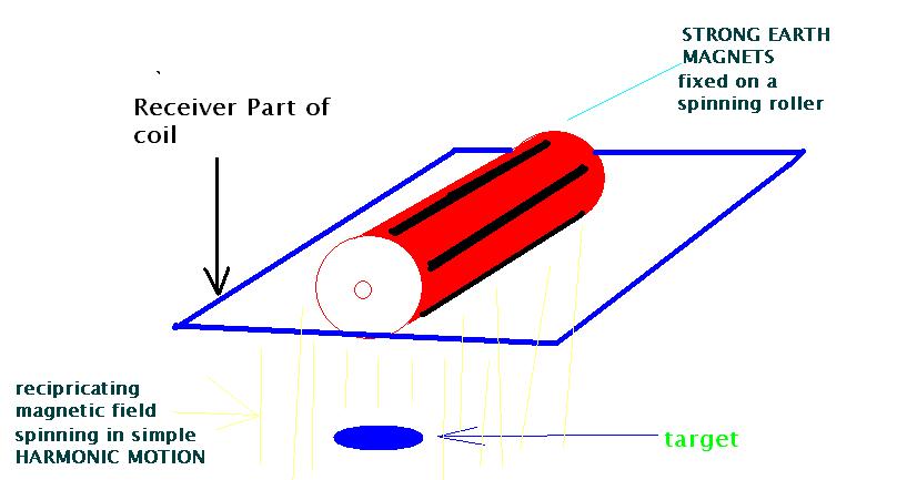

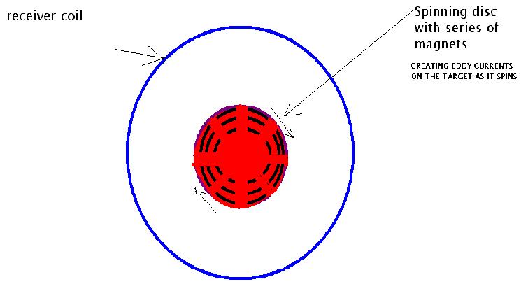

                  thank you aziz and freinds even the one that says trash the idea...
                  ok the magnetic feild and the edyy current are emitted in different frequencies so it shouldnt be too hard to make a reciever to detect the eddy current emitted and eliminate the magnets field.....
                  I am thinking along the lines of aziz ,that the magnets be spinning which can be made to spin also using magnets thus eliminating the need for power to spin the magnets....I will put a diagram of an idea ...
                  the other magnets I am think are the circle magnets used in large P.A speakers 30cm diametre.
                  Yes I the whole idea is whacky but I am just trying to come up with something new rather than follow the traditional methods to make detectors ...and I think its worth discussion...
                    here some very basic ideas of what Im thinking
                      this another idea
                        So you're planning to make a permanent magnet motor?
                        You do realize that such a device is known as a perpetual motion machine?
