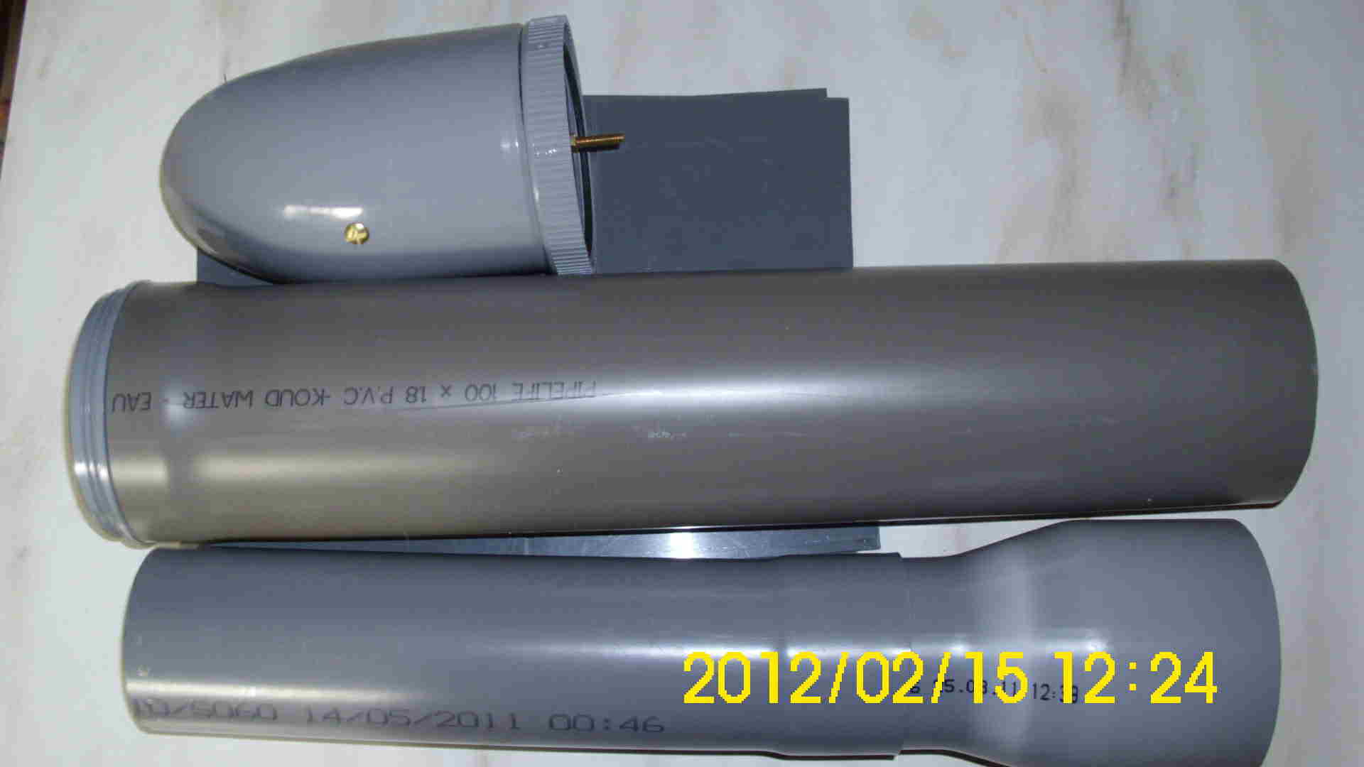

    3. The sensor has to be inserted into a towing fish under a pressure-protected ccntainer.
    We have found that it is not really necessary to make the complete fish as a pressure-protected ccntainer. We are designing a small container with its dimensions selected to fit our sensor coils in in-line configuration. It is built from a section of high-pressure PVC pipe (90mm outside diameter, 7mm thick walls) closed with two machined caps each with double O-rings. The cable goes through an IP68-rated connector guaranteed to support 100m depth for several hours. The sensor container just needs to be inserted inside a fish made of simple PVC pipe with a nose and fins on which the lead weights and the towing cable have to be fixed.
    This is a work-in-progress which is being built as a first prototytpe. The sensor container will be depth-tested first on a deep lake here in Belgium and then, the whole system will be experimented first on the lake,then, at sea..

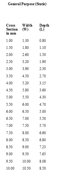

            General Purpose
            (Static)

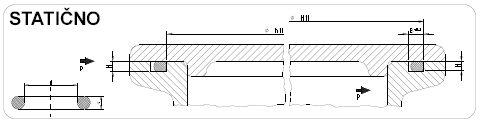

            o ring can do the job with no problem for 70 bars ( 700 meters depth)
            I have experiance with static design for 30 bars without any leak, where cover is mounted on pipe wall with screw and between is oring.
            You just have to do the proper groove acording o ring diameter ( see atachment)
            there are also o ring lubricants that protect o ring from cemicals....
              Thanks.

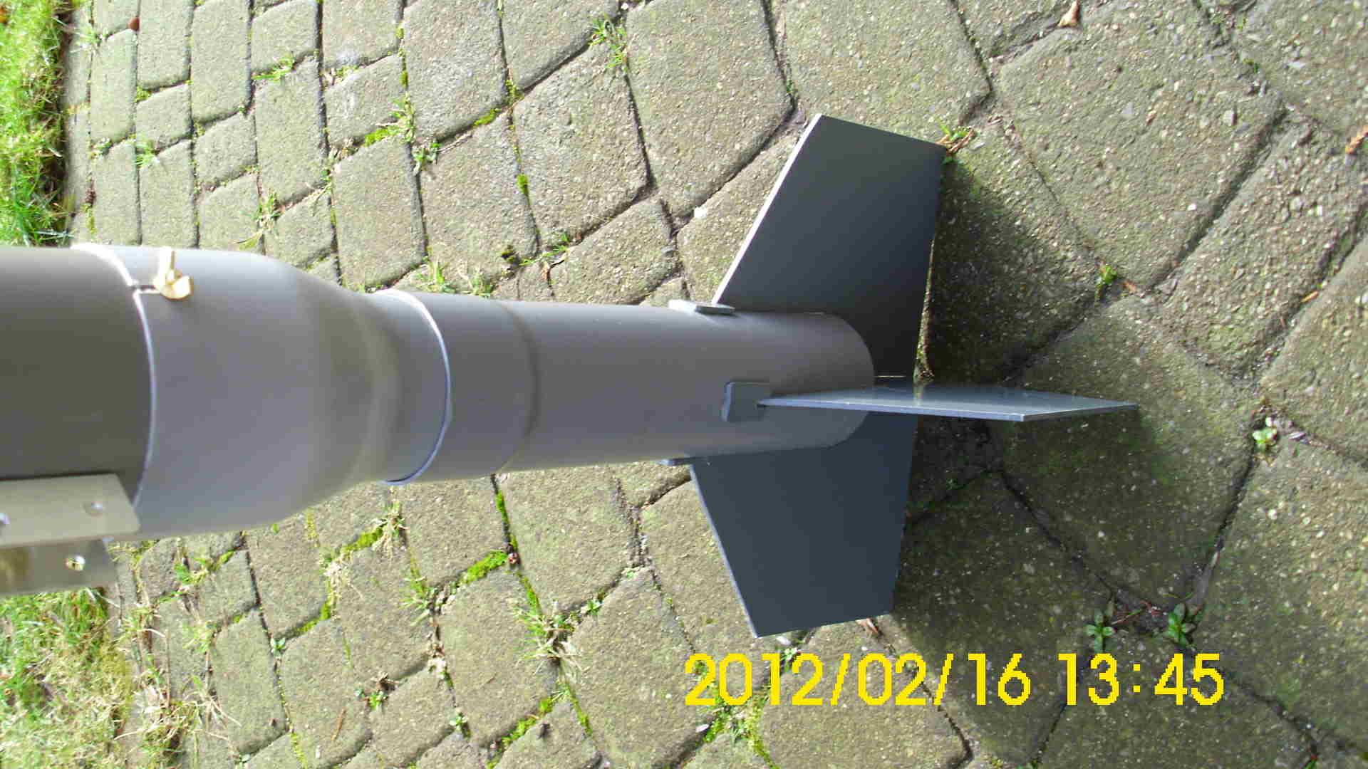

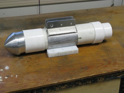

                  towing fish for PPM MarkIVb

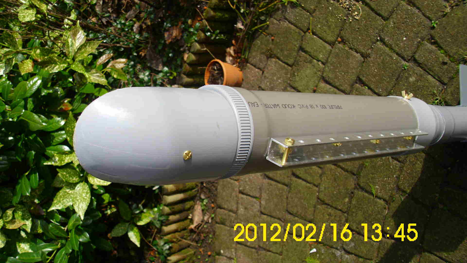

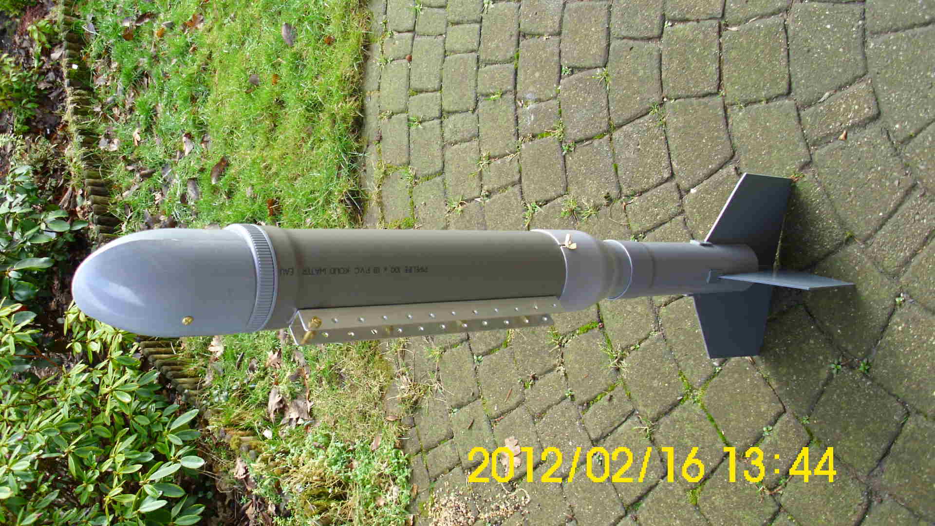

                  This is a few pix of our first fish prototype.
                  Note that this version has a slightly different design than the design drawings published before. It is now simplified and it has been specifically modified to be easily removable and re-assembled without any special tool.
                  The nose has been designed with a large compartment to contain an adjustable number of lead weights to balance the fish together with the selection of the hole on the cable attachment 'U' rail.
                  The overall length of the fish is 1100mm.
                  This is currently being tested at sea in Australia and it looks like it correctly behave in the water.

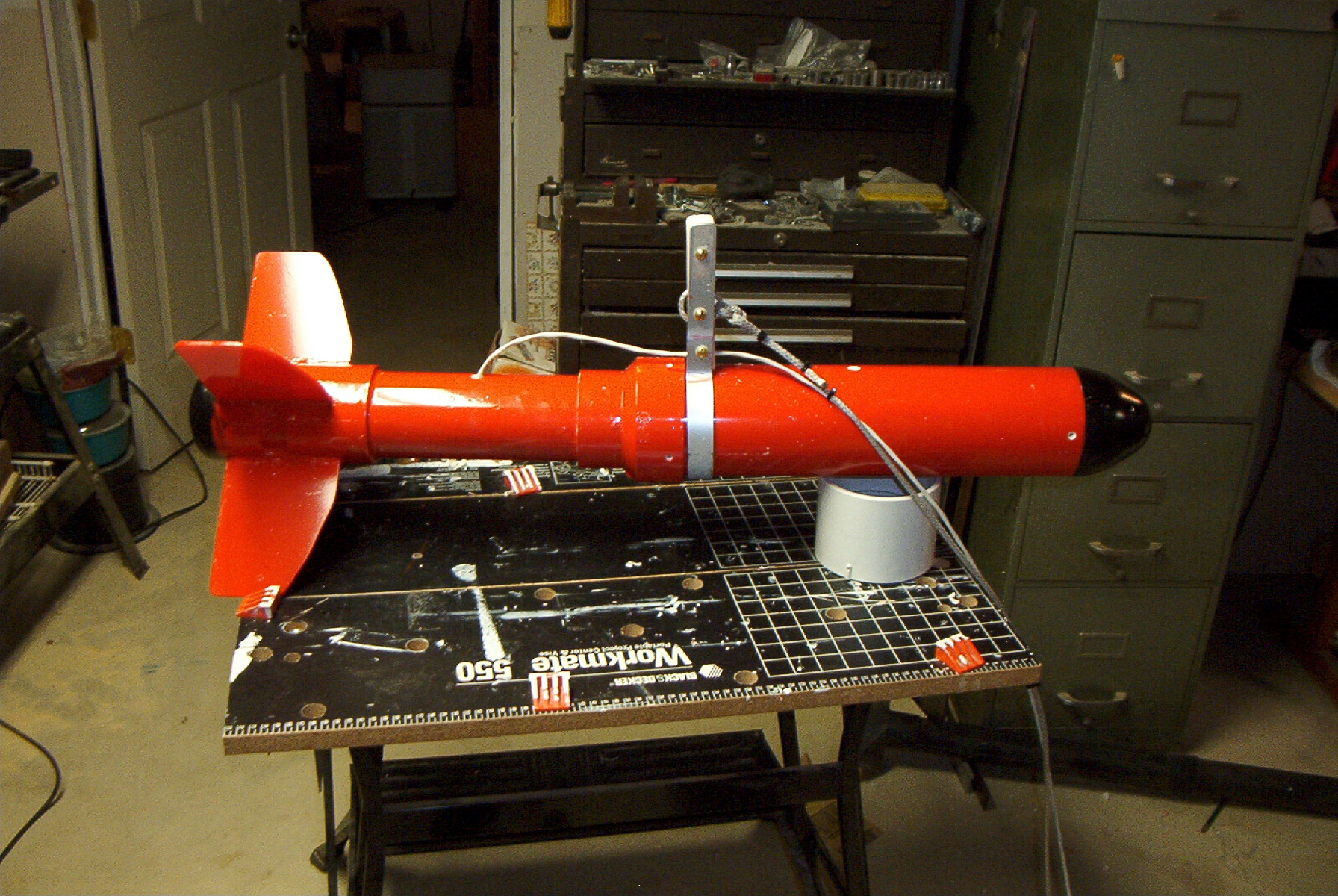

                  The last pictures are showing :
                  1. Our last prototype version. It has a cone made of solid aluminum and a VERY solid but adjustable cable attachment. It just needs a pair of fins to be attached to its tail.
                  2. A fish built by one of our American client based on our design.
                  Note that all these fishes are designed to carry our sealed sensor container, they are not themselves water-tight.
                  Willy

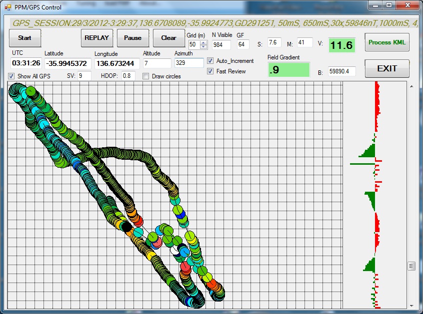

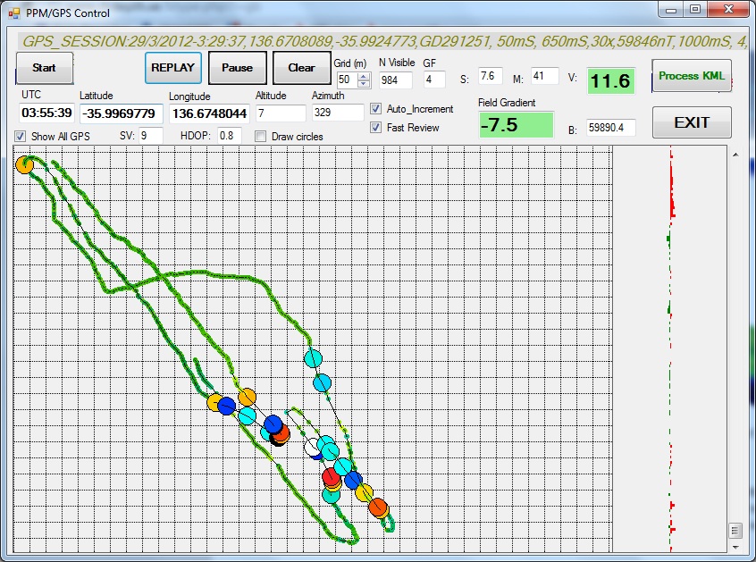

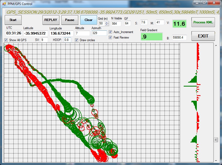

                    We have now implemented a new mode of GPS plot in our PPM Utility program.
                    Look at these two alternate methods.
                    The GPS fixes are plotted in XYZ mode using one of two possible options according to the checkmark 'Draw Circles':
                    1. Hollow circles whose diameter depends on the field gradient and color depends on the sign of the gradient, Green for positive, red for negative values.
                    2. Circles of constant diameter filled with a rainbow-type color scale. Hot colors correspond to positive field gradients, cold colors correspond to negative field gradients. Light green shows field gradients close to 0.
                    In both cases, field gradients with absolute value is less than the Gradient Threshold parameter ($TG) will be displayed with very small circles. See the last picture and compare with the previous ones.
                    The GPS plot is drawn by default with the maximum scale ratio and panning to completely enclose the full survey grid but, the operator can override this by manually panning and zooming.
