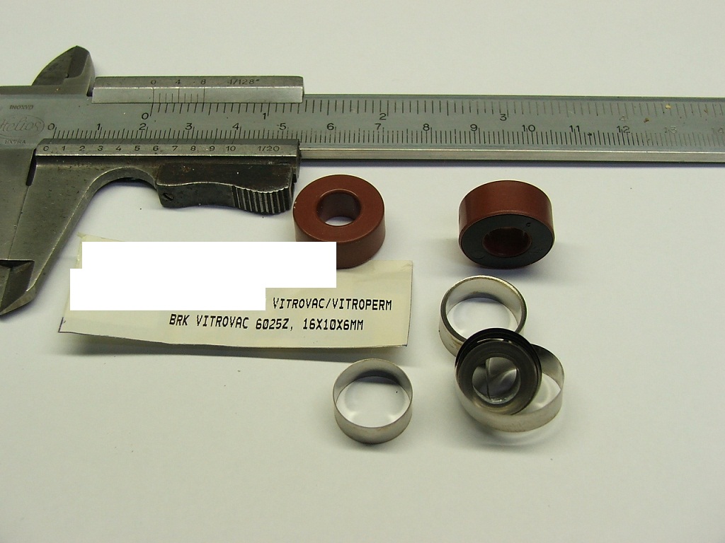

          Best is some vitrovac metal. You can find this metal in protection strips used in shops and books. I have found some good Vitrovac Mu metal in a toroid .It is not so easy to recover it from the toroid, the metal is very hard so it breaks fast. After heating it (red glow) it is better to handle. http://www.vacuumschmelze.com/index.php?id=292

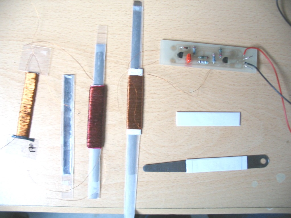

            Excellent experiment! Ap Berg thank you ! Do you tell me how you thread wires rolled up and is thickness of the wire which you in this fast-core?

                  Hello Geo & Orbit,
                  The experiment with the ferrite coils I made last week, the tests with the vitrovac I made some 4-5 years ago ( how time flies..) If I remember well I used some 0.10 and 0.14 mm isolated copperwire, 2 coilwindings ,some 150 - 200 windings, bifilar wound Never made inductance measurements.. so do not now. Look at the schematic for the start/finish from the coils. The coils I wound on a papertube that I had fixed with some waterbased glue on a metal strip, after winding easy to remove.. look at the photo's. The vitrovac strip can then placed in the paper tube.
                  The most difficult was to make 2 the same..
                  If you look at Internet ...sears for the Armstrong oscillator, as Ivica told me this is the oscillator used ..
                  Best regards.
                  Ap

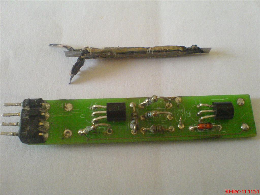

                            fgm3 original sensor resin removed - and vitrovac !!
                              L1 and L2 inductance 763mh!
