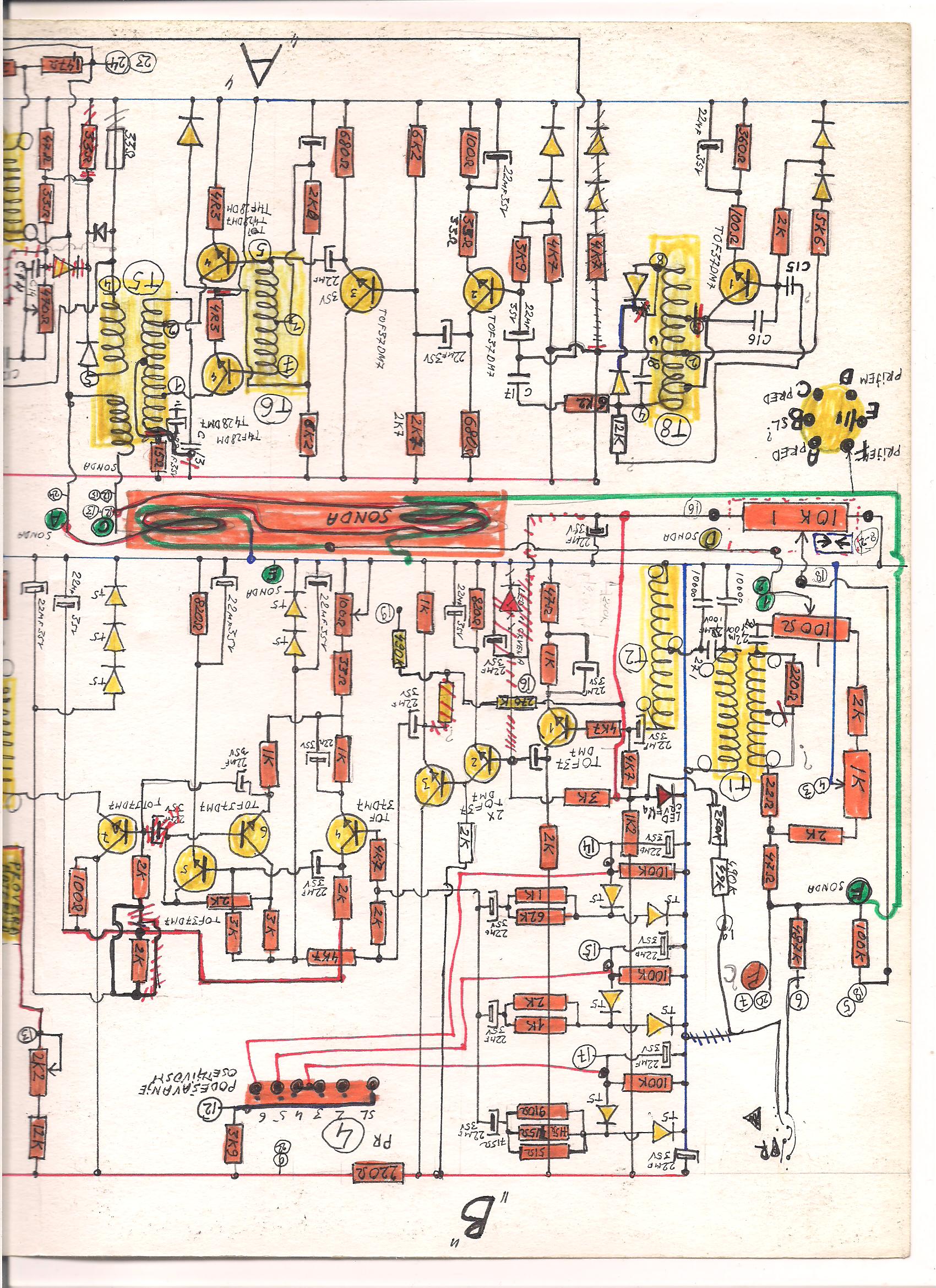

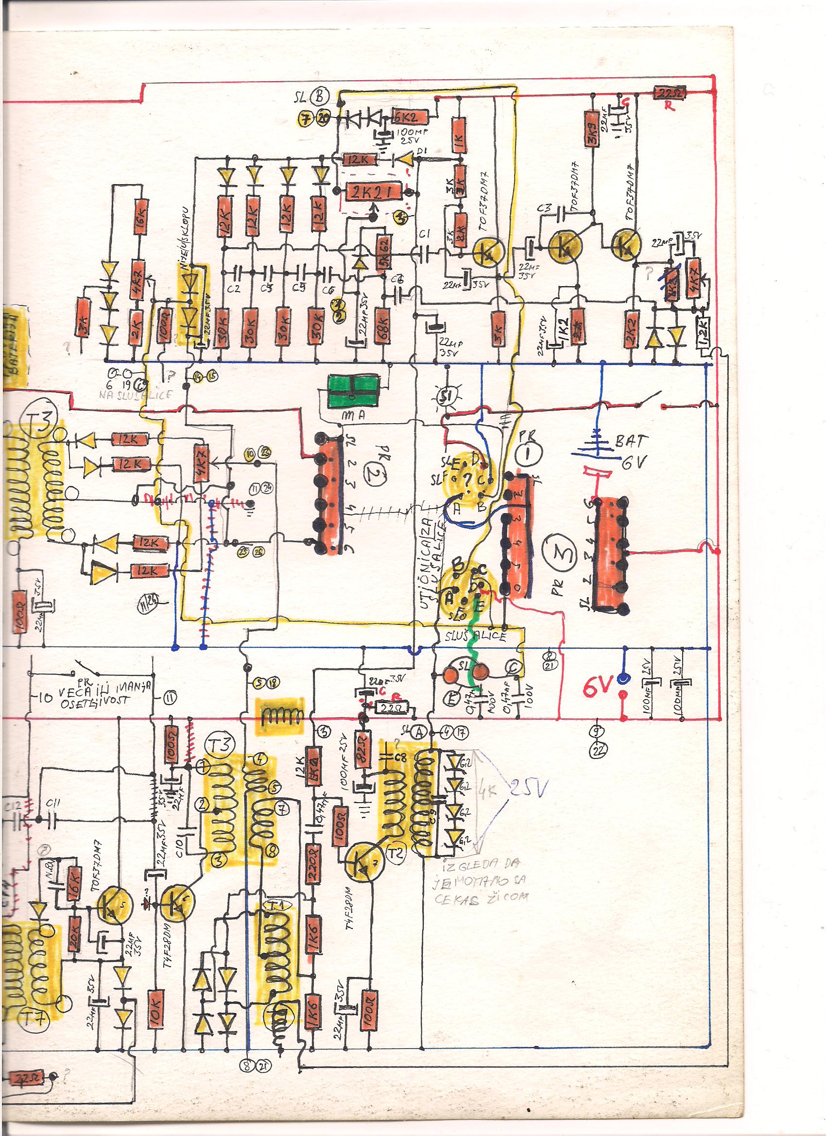

    _ MILITARY magnetometer ,,tremendous sensitivity !!!!! iron 1gr iron !!!!! 3 meters hand-drawn diagram ,,gave a which recognizes the the device to ? which model???

        hhee and not just !!This is the Soviet Union and East Germany !!and if you have drawn as a fitting place /scheme given me friend scheme is not cartoon aesthetic ,but the device it works perfectly for present time ,I'm could I see this a few times looks stupid ,but it perfectly !i wonder why it I do not understand the model maybe someone knows what it is otherwise this ,the device is purchased in Germany after the fall the great wall of military waste Eastern Germany !!!

              not we intend just to dropped guru,, drawing scheme again I was so received from friends and my intention was to known of which is the model for magnetometer to set realistic scheme which is a nice cartoon ! who knows Russian label transistors and who was opening the magnetometer on the I knew that even if the model (quote Einstein ) I know I do not know anything !!! //I do not have for some to draw a nice scheme to me that appreciated as a Guru especially with someone who obviously has a problem with himself !!

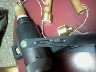

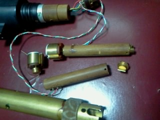

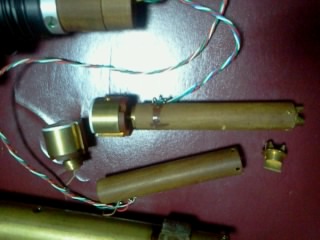

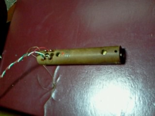

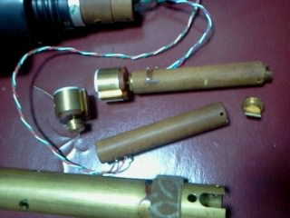

                      Hello Orbit . Do you have photo of device or the link to the article ? What is T1-T8 [coils]?
                      You still have lots of work to do on this Military Magnetometer !!!
                      Best Regards..................Eugene
                        t1 - t8 are rolled bifilar toroidal transformers ,,I have somewhere pictures of the device I will put them these days see all
                          Sensor!
                            Its a OGF_W (Water) but is (more or less) identical to OGF-L (Land). Its a copy of a foerster flux magnetometer. Calibration is very time consuming.
                            It is for mines/cars/tank/ammo boxes detection and not for detecting 1 gr iron in 3 m depth. Never seen schematics of it and never opened mine, except the sensor for calibration.
