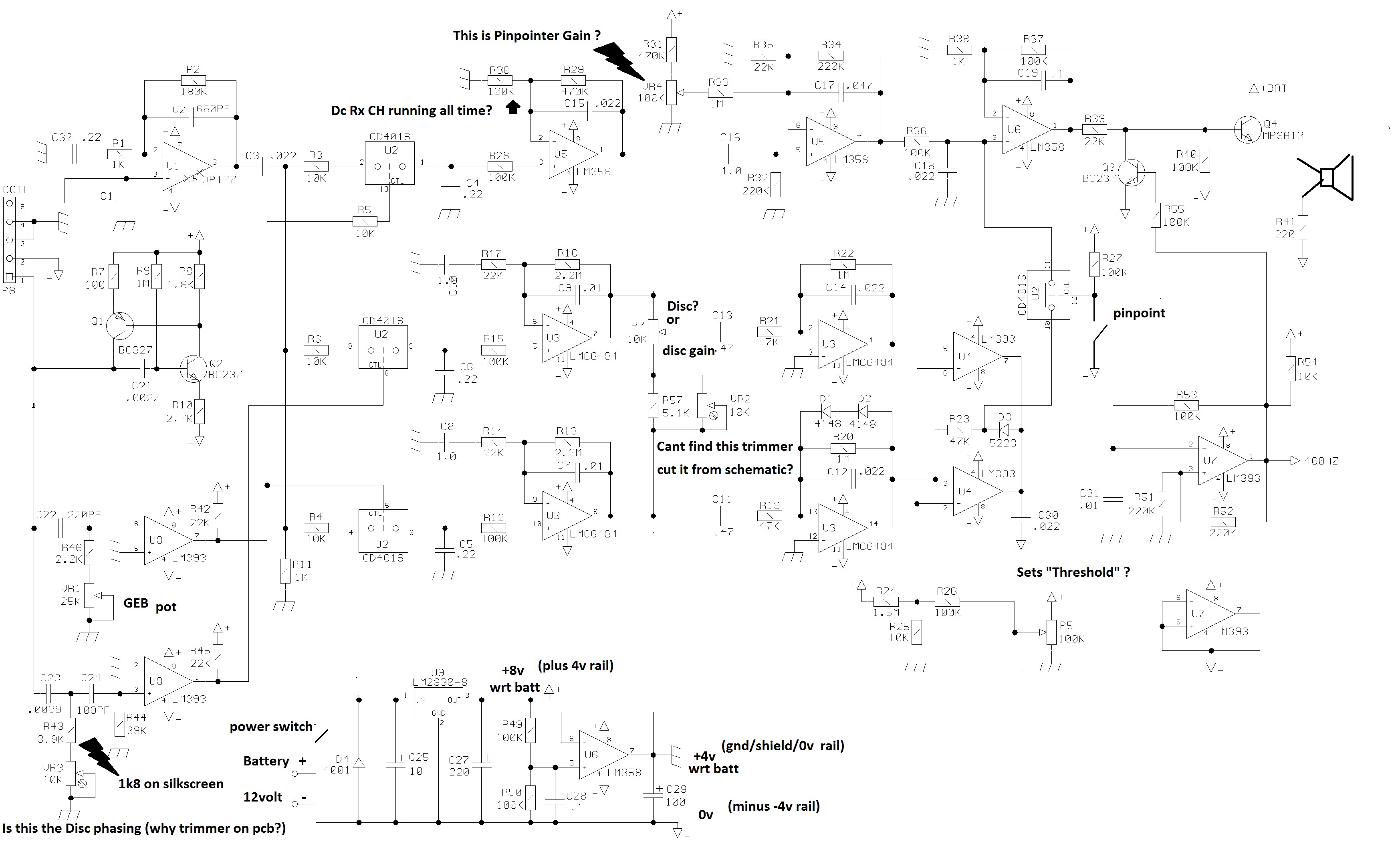

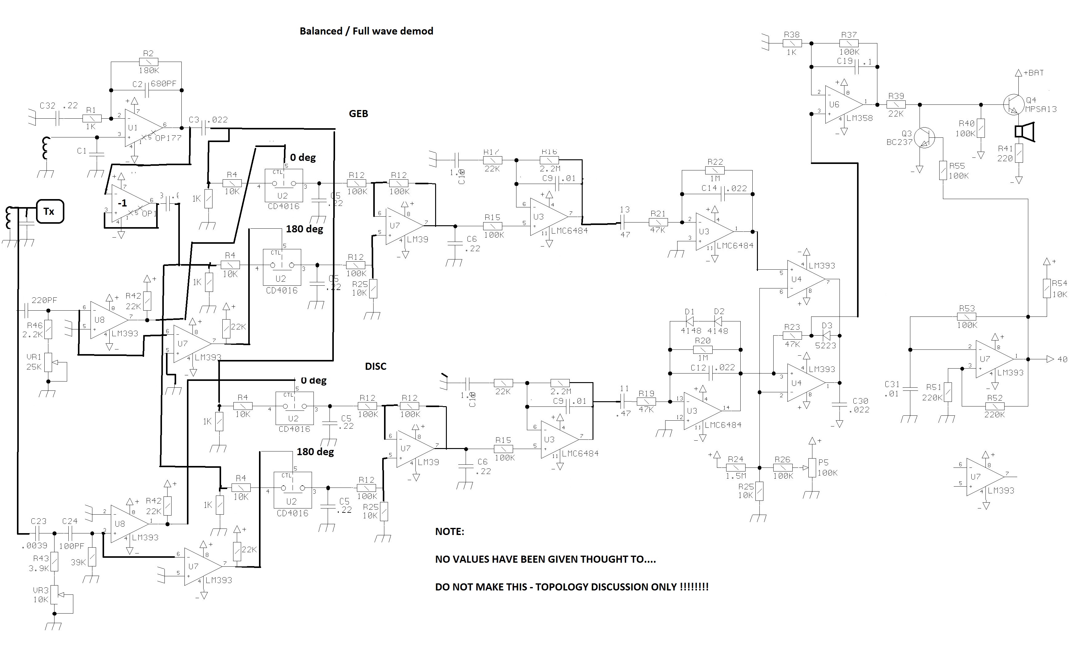

I wish to build a full wave demod unit - based on IDX perhaps.
Using this as a starting point .. Would someone comment on the schematic.
The idea is to extract signal from both + and - halves of the Rx signal. I dont want to do a full quadrature beast - just jazz up an existing working format.
Take a look at my hammy drawing - shout feedback
