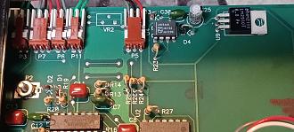

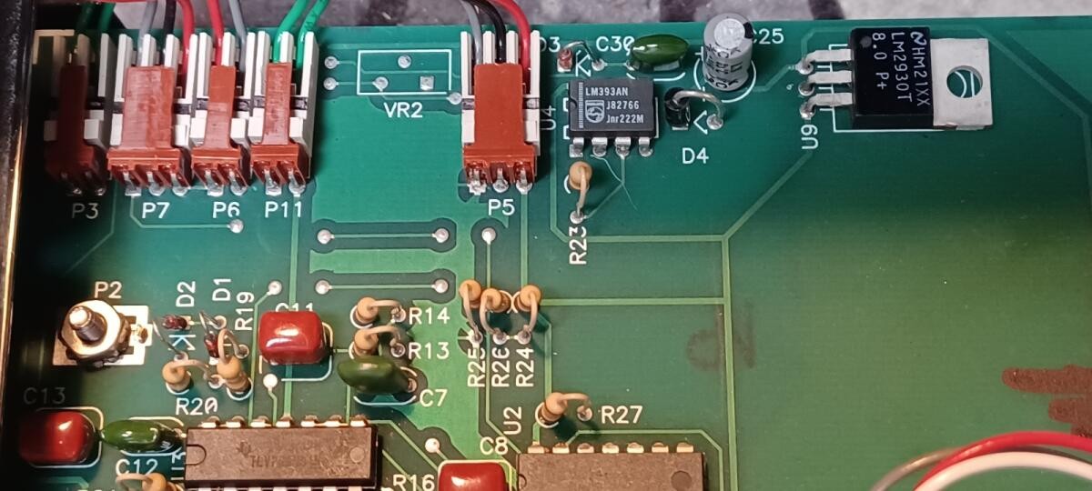

          I'm pushing forward on my first project.?
          Converting a whites classic 5 ID into a water proof beach / water machine.
          I'm in the process of tracking down and sourcing the needed parts for what i want to do to it which will also include the Mr Bill modes and also a few of my own ideas.
          I am trying to find the wire connector plugs and socket which i think might be Molex brand as the only identifying Mark is an M in a circle molded in the plastic pitch is 2.45 by my measurements.
          I've looked at thousands and haven't found this exact one that whites used so I'm hoping someone knows the manufacturer ,part number , ect of the plug and socket.
          Yes i could solder the wires right to the board but i don't want to do it that way.
          There are plenty of other connector i could make work but then because of how i roll i would have to change out the other to match.
          The wire connectors I'm looking to source are in the upper right hand corner of the picture of the PCB.
          Thank you in advance .

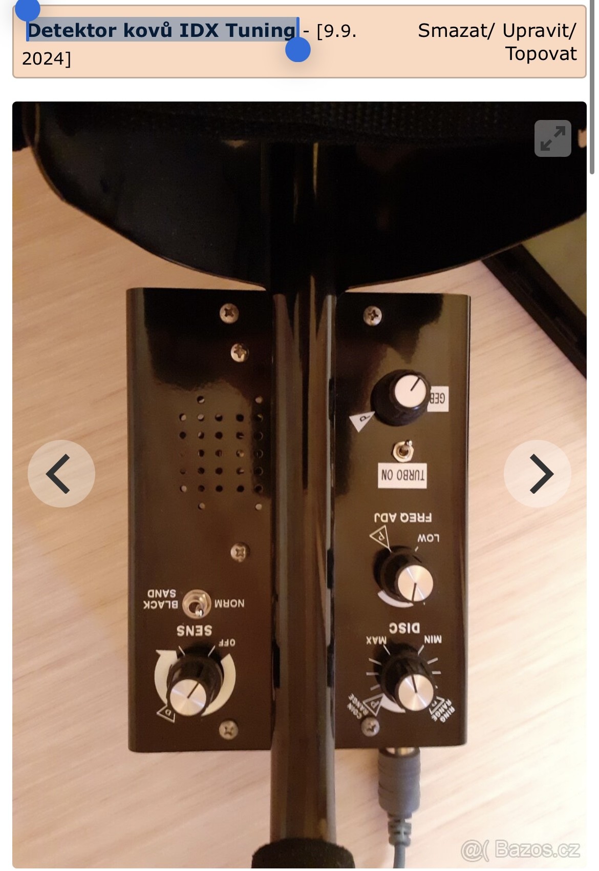

              • After Searching Intensitive in the Web I finally found a classic turbo
                the question is it a real turbo or just the sat switch
                other question how does the classic 4 and 5 made for Kellyco that run at 8khz work?
