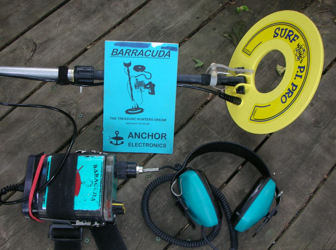

    Come on guys...Look at this as a simple audio amplifier, put a 10uF cap across the 100R emitter resistor (it's called a bypass capacitor)..Should give the result you're looking for (unless I'm teaching you to suck eggs in which case, just tell me to get lost) .
    Also, if the audio supply is connected to the cathode of D8 then WHAT is D8 doing? Nothing that I can see, unless it's the wrong way around??

          Go on put me out of my misery, did adding the cap work? I gotta know hehehe.....I would think you could probably go as high as 100uF.
          The capacitor helps to keep the quiesent point fixed. During its operation it bypasses the ac component. If the ac also flows through this emitter link then as we know by parameter equations emitter current and ce voltage changes hence varying q point.

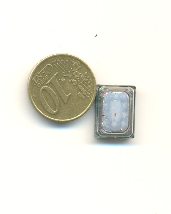

              I use a speaker of an old polifonic mobile phone,and the sound is very high and the size is small.
                caught me off guard there! ivconics right leave the diode alone left the audio as is the barra is not a serious machine for me anyway i realise that now!
                gonna try to sort the unknown parts as a project dont get me wrong the barracuda is a good starting platform but thats all it is afterall if it was anygood really
