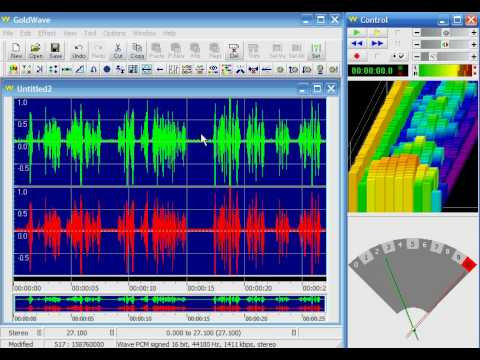

    For this project we will take:
    1-one detector
    1-laptop
    1-any extension audio cable with a jack 1/8 "(3.5mm)
    1-adapter (for input jack 3.5mm to 6.35mm) (can be Radio Shack)
    * 1-support for laptop
    Next you need to download a program from the internet:
    Gold Wave v5.67
    http://www.goldwave.com/release.php
    I downloaded, saved once we execute the program, open it to study something, as I put down to start recording in the search.
    * Support for laptop, to charge the laptop in the field, can be done, they just take some time to build,,, to hold onto the laptop with your body that is not going to fall. Or buy the support.
    connect the cable with 3.5mm standard output to the microphone input of the laptop, then connect the adapter to the detector.

    We're going to start, open Gold Wave.
    -We on the detector,,,
    Uploaded with ImageShack.us
    We're in the middle part and we record.
    Once you've recorded some time, we STOP and turn off the detector and give a moment to play, to see if the recording was saved search.
    we can give back to listen detection, and if we liked the beeps that indicate something buried, we can save ... have fun and "surprise" in their searches.
    (I download the program is temporary, it would have to buy the program)
    the idea was that the program goldwave, worked for an oscilloscope;http://www.ledametrix.com/oscope/index.html
