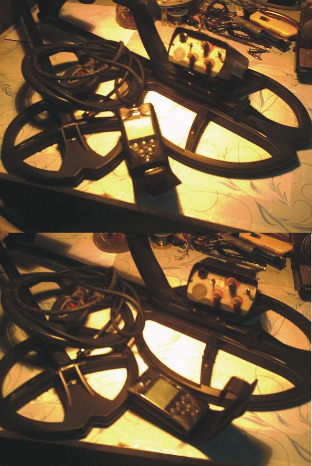

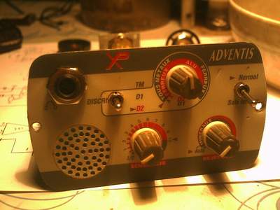

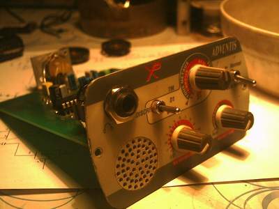

    Today i got XP Adventis "boitier alu" (Aluminum enclosure).
    Interesting machine. I took occasion to pick inside it.
    But there is something else i wanted to ask people here;
    i tested it in air and air "depths" are poor!?
    2cm coin barely detected at 15-17cm in air in both Disc modes and later i All metal mode too.
    Must admit that i expected better from it.
    Is it ok? Is it the way supposed to be? Maybe this one is broken somehow?
    Is anybody from you here having this machine to tell me about this?
    Btw Disc modes are working excellent, All metal mode too.
    All commands are operational.
    No visible signs of any damage, failure etc.
    So i am not sure is it something wrong with it, showing such poor air depths or it is the way supposed to be?
    Will appreciate any help on this!
    Cheers!

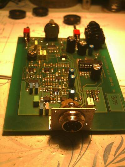

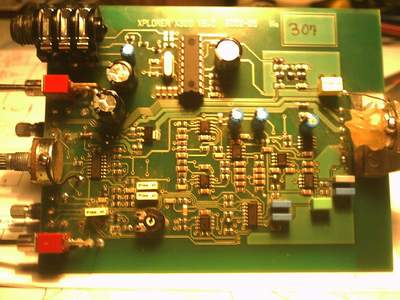

        Anyway, i spent whole night last night trying to dig out what's wrong with this detector.
        My hair fallen from thinking... so now i am balled. Must wait new hair!
        Yet... I DISCOVERED!
        Damn! Handful of parts were burned!!!
        So it took me whole night to replace them with new ones.
        Than i tested it... WOWWW!
        It is KILLER!
        40cm in air on same coin from the other day!
        Disc is perfect, GEB is perfect. Sound response is perfect.
        Only one tone. D1 is adjustable Disc mode, D2 is pretty exclusive Disc mode, do like them both.
        Comparing to Deus with smaller coil this Adventis is showing me almost the same air depths!
        I am impressed! Certainly Adventis is BEST BUY in lower price range, no doubts about that.
        Pity they discontinued it. This device is not mine, guy gave it to me to try to fix it.
        So, soon i will return it to that lucky bust.... ! I feel almost sorry to give it away now!
        Will wait chance to obtain one for me in future!
        Don't know if Adventis 2 is same or similar, never seen it so far.
        But i heard rumors that ADX150 is not perfect machine, can suffer from masking.
        Checked masking with Adventis and i am satisfied, very very good! Coin is partially masked with larger iron, not completely as at ADX150.
        Again NO disappointment from XP! Congratulations!

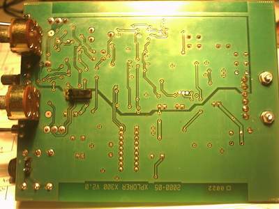

        btw... i took this occasion to trace Adventis and now i do have it's schematic!
        Because of huge respect towards XP i will never post it in public nor share!
        Cheers!

              My benefits from this are clear; i learned something new now; analyzing Adventis's circuitry.
              Although i said i will not share schematic, would be no harm if i mention that i met pretty interesting oscillator design in it!
              I admit; this is the first time in my "career" that i am seeing such setup.
              Actually it can be understood as conventional oscillator circuitry but used on uncommon way... at least for my experience.
              Maybe i will try it someday in some of my hand made. Looking promising.

                        BTW, I am interested in seeing the Adventis schematic. PCB looks very promising. Too bad you are not in your sharing mood.
