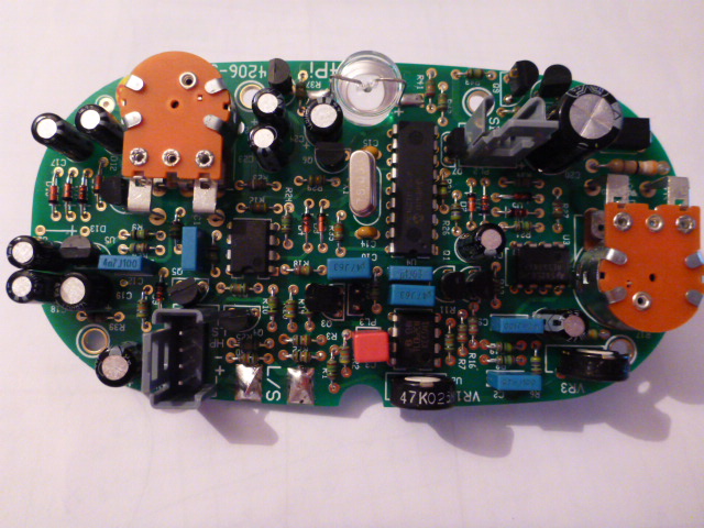

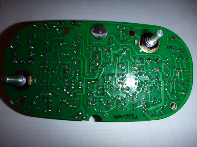

    I want to increase the sensitivity of CS4PI to detect small gold nuggets in highly mineralized ground.
    A coil smaller than 6.5 inches (154mm) with 0.5 mm wire gives better results than the original coil.
    j'ai augmenté
    I increased the original 4 Mz quartz frequency with a 6 Mz, with the original coil the results are very good in the air but very disappointing on the ground, we must excessive reduce the power to find correct ground effects management .
    What's happening, why this problem with the original coil? Is it an capacitor effect?
    So I will make a faster coil.

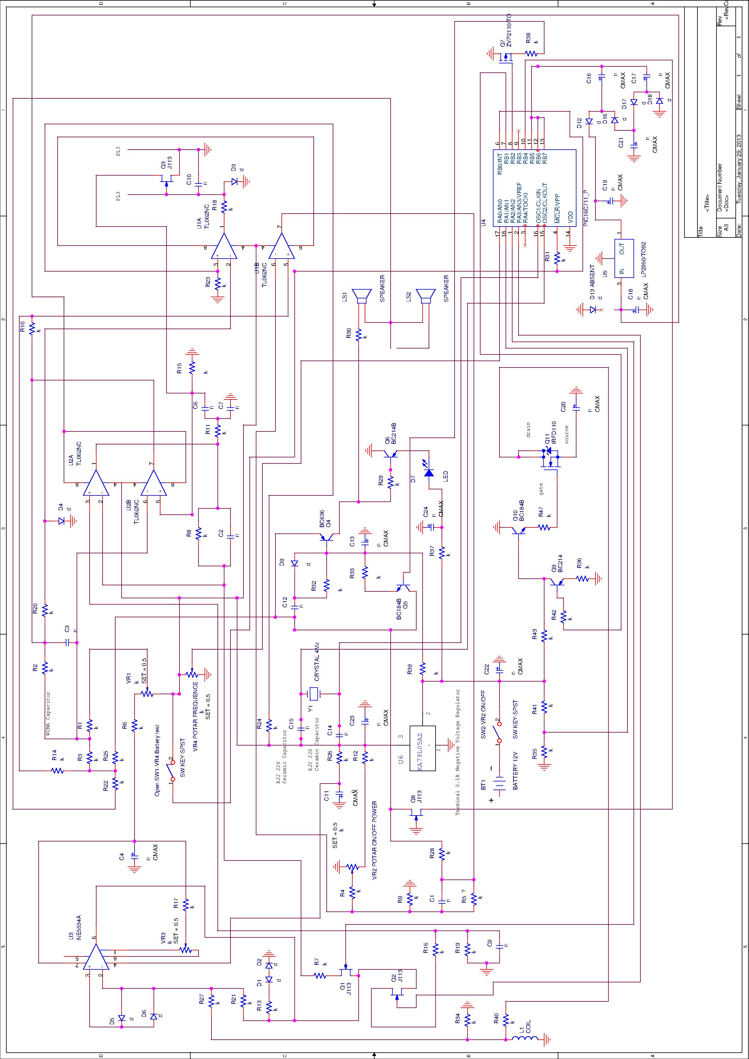

    To understand this detector, I drew the 4pi schematic, there may be some minor errors, it remains to put the components value, but you can see the principle of operation.
    Eagerly awaiting for your schematic.
      SC4PI Schematic

          Great work, geroms. Thanks.
          I have one CS4PI in past.
          Hard to get stable working frequency but excellent depth.
            The diode D13 is not installed on my cscope.
            In some pictures I saw that this diode was added, can you tell me if you have this diode or not and if your CS4PI stable?

                        Check your connections on U5

                          I need to know the ranges of your tx PPS and PW for a simulation on your tx circuit or else I can't do much more for you. It would also be good to have some numbers on the coil you intend to use. I would recommend something in the range of 300uH~500uH as a start.
                            I'm more worried about all those R values that are left "?", but yessir that regulator is reversed.
