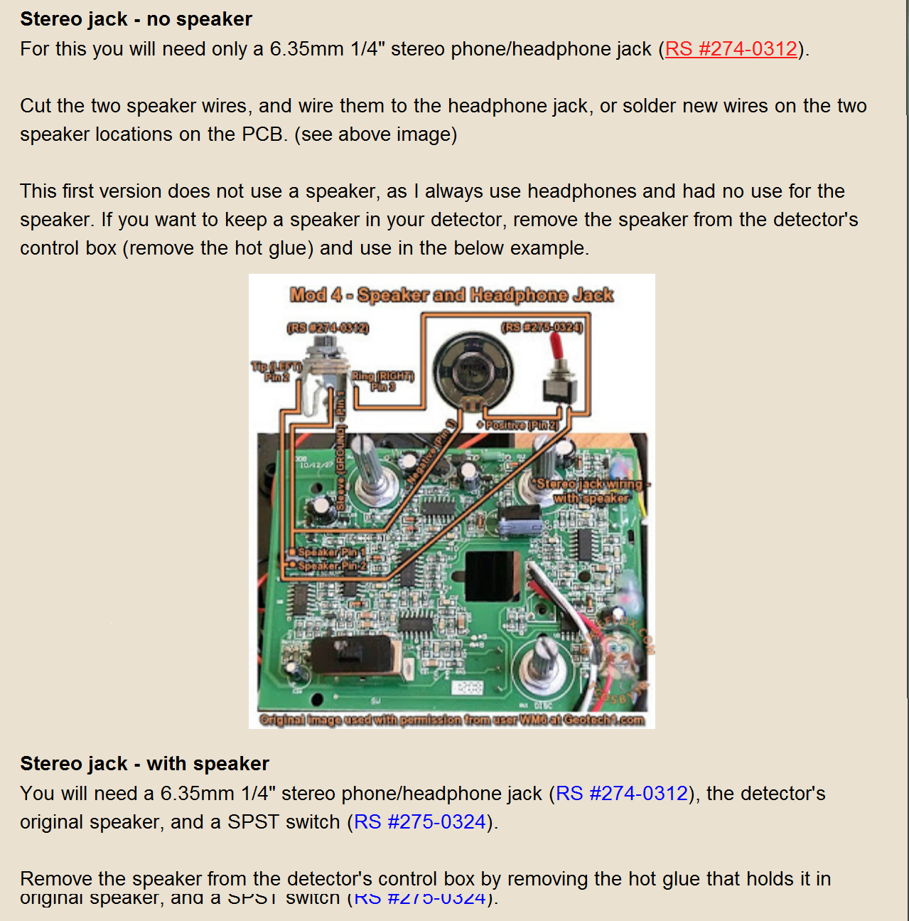

    I recently purchased a metal detector through Harbor Freight, item #67378, listed as a 9 function metal detector. I bought it new for only $45.99 (including sales tax, and shipping costs) - as I had a 20% off coupon.

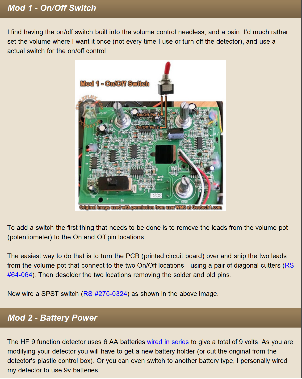

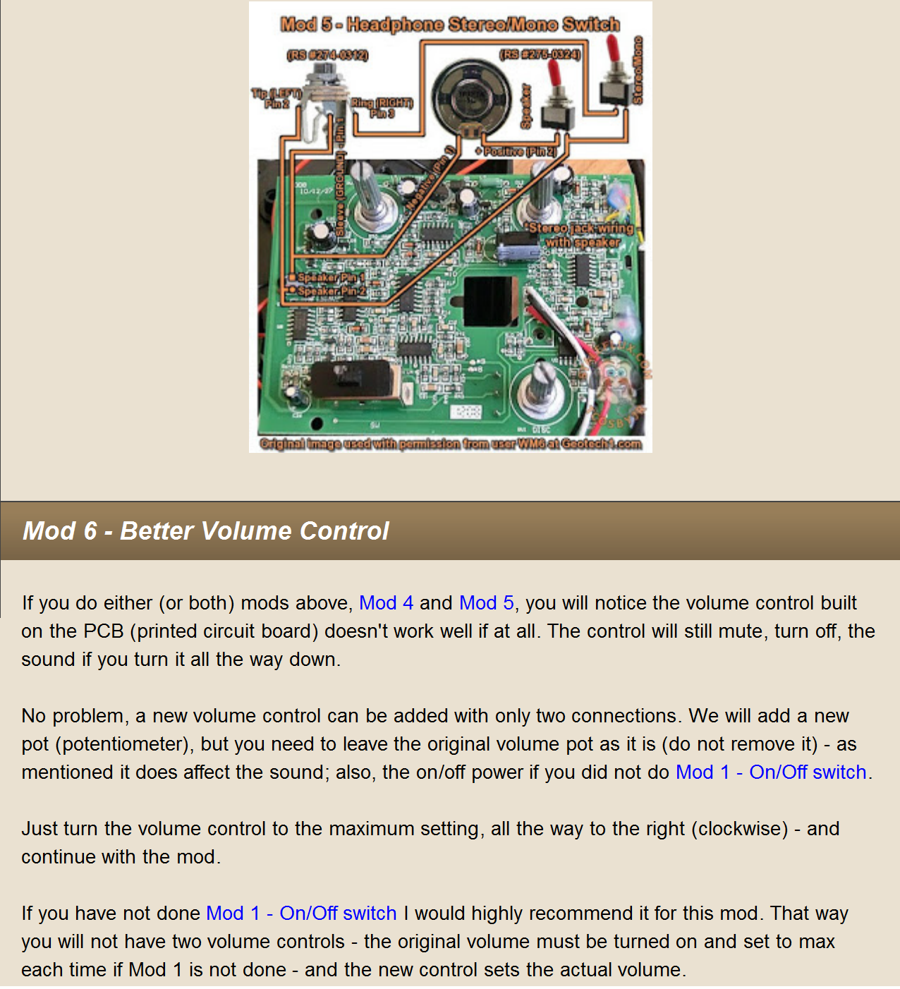

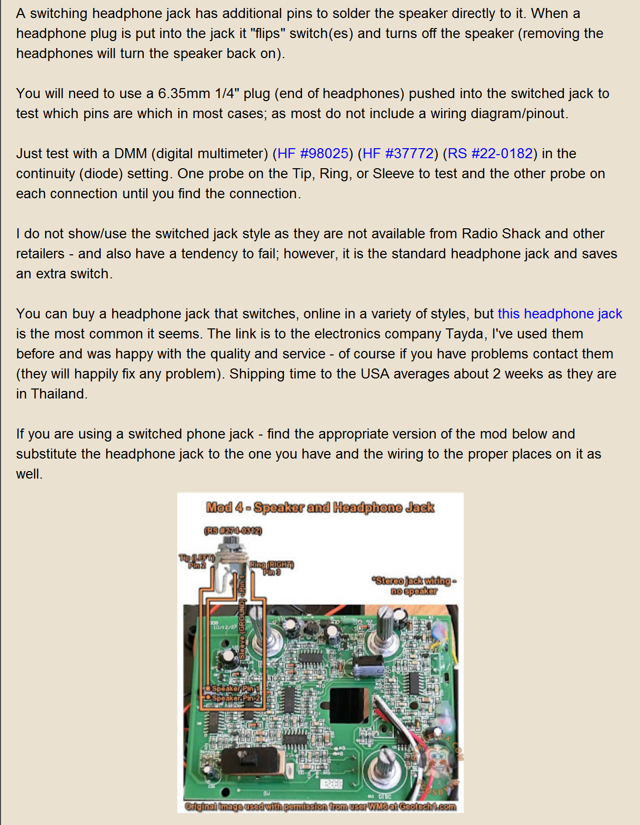

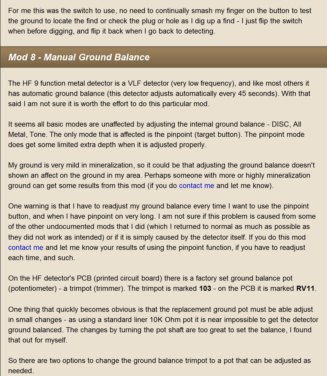

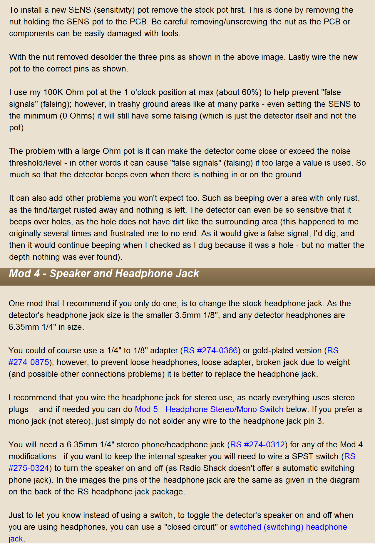

    Here is a list of changes and modifications I did to the detector - as it is rather extensive I plan to release detailed instructions/how-to's on the different mods. I have plenty of images and full details saved, and I will release the instructions later on as I have the time.
    • Custom straight shaft that is weight balanced to the handle, with most of the weight under the arm/elbow to make it feel lighter and easier to swing
    • Shaft uses a locking spring clip with 10 adjustment holes (stock shaft is plastic cam-lock only)
    • A metal twist cam-lock for the lower rod
    • Custom detector stand - keeps it out of the dirt and makes it near impossible to knock/roll over
    • Search coil no longer hard-wired and uses a standard detector screw-on connector
    • Search coil was sealed with pure silicone (aquarium grade) to prevent water damage
    • Padded armrest added with a armrest strap

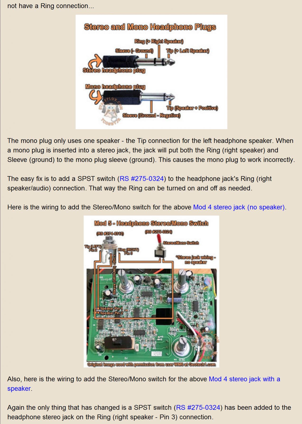

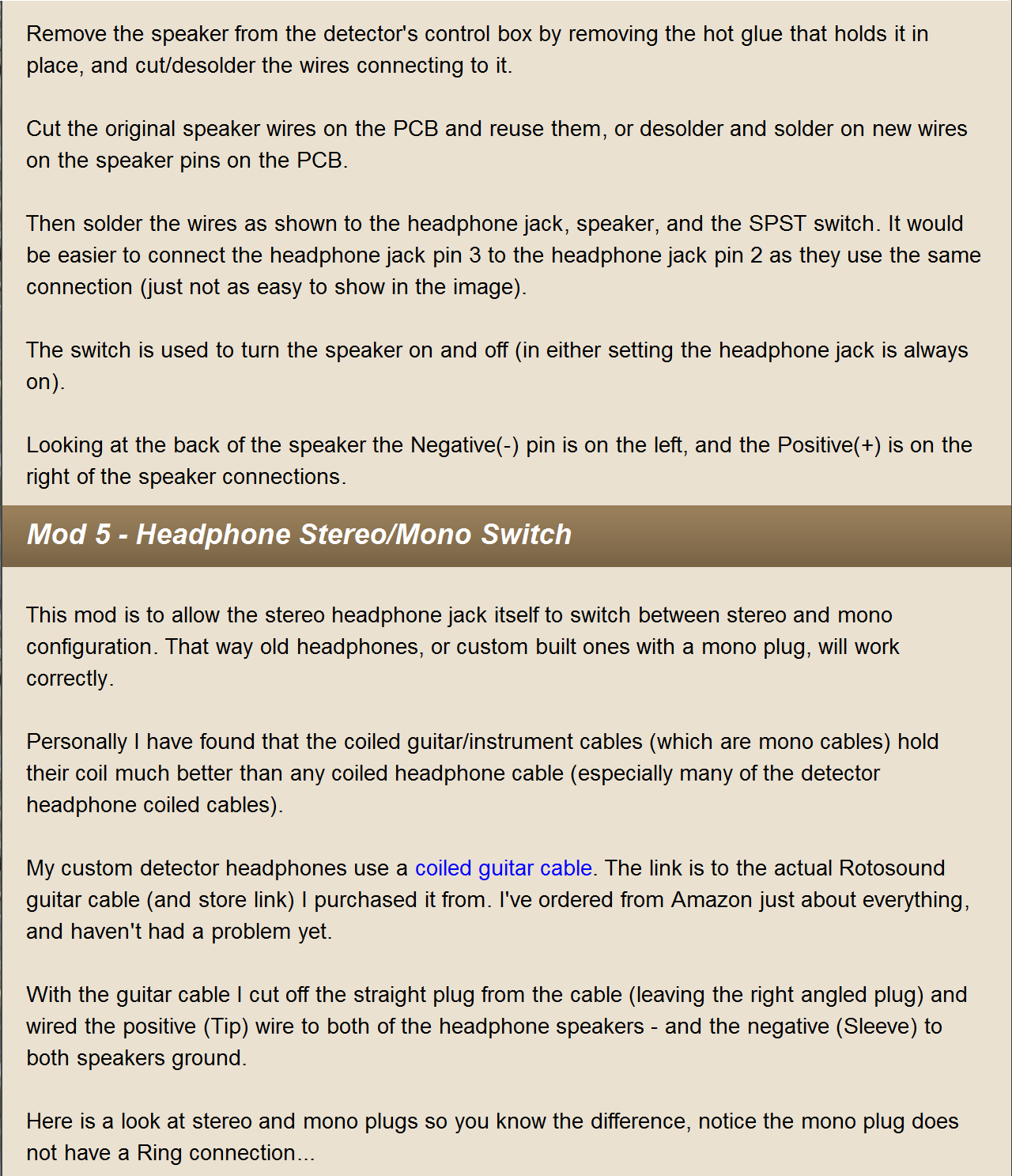

    • Headphone jack changed to standard metal detector 1/4" size (6mm) and added to the end to prevent tangles/problems
    • Added headphone switch for Mono or Stereo headphone cables
    • On/Off switch wired separate to prevent having to change the volume each time

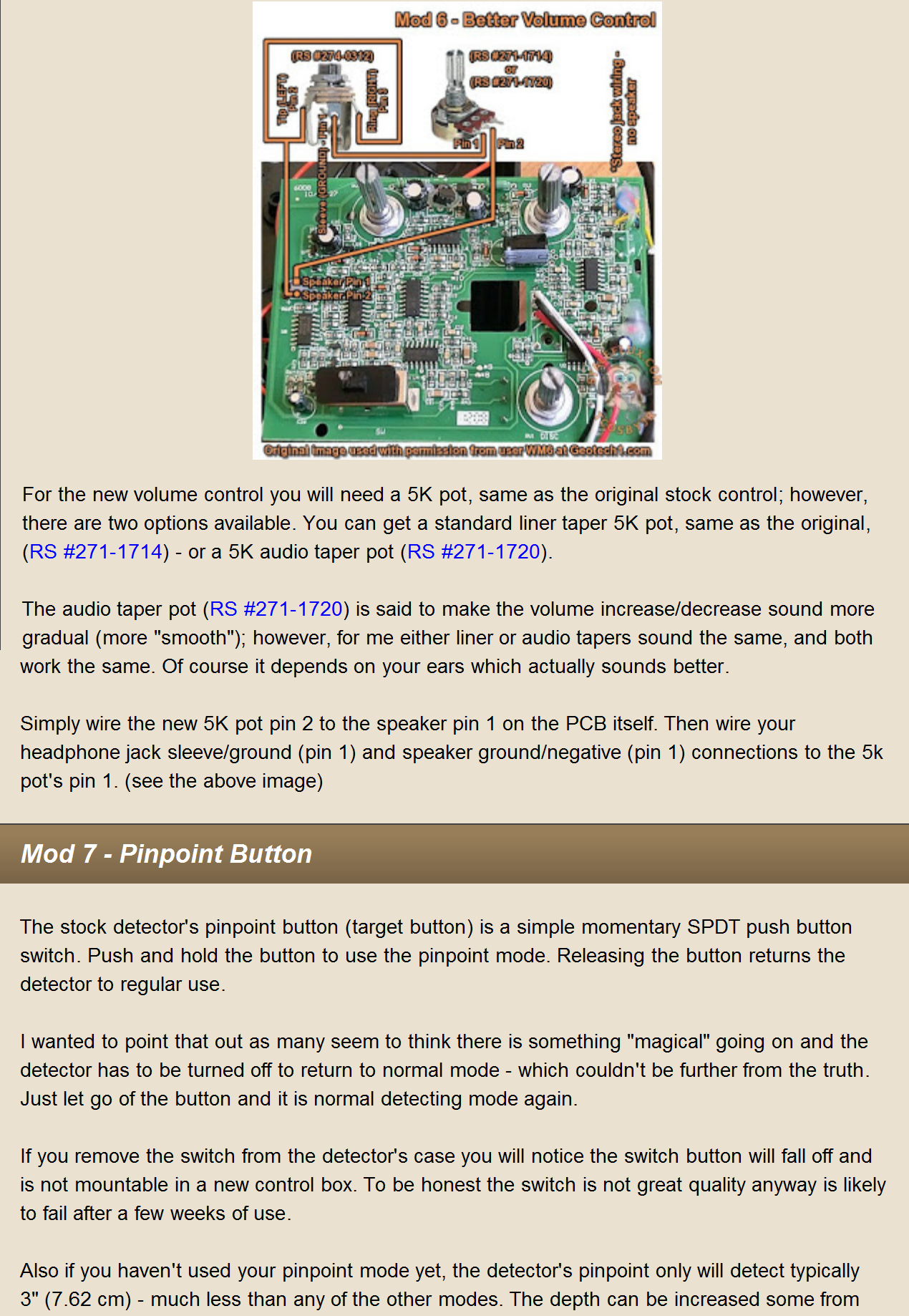

    • Volume control works with mono or stereo headphones, and has smoother increase/decrease

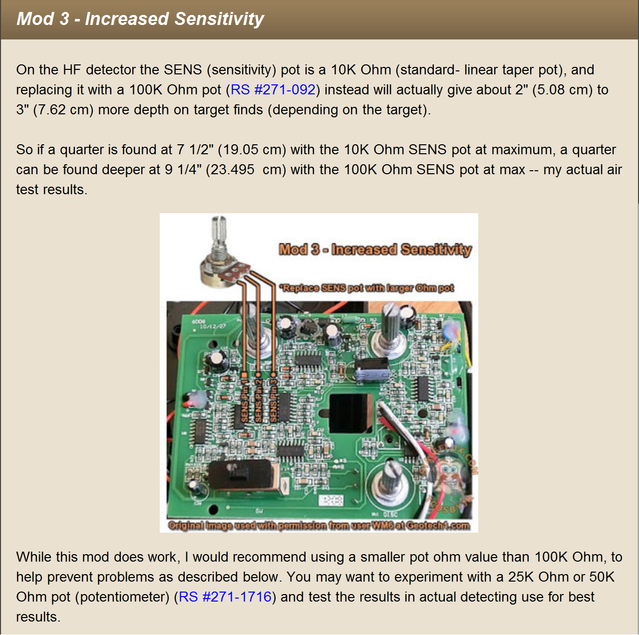

    • Sensitivity potentiometer changed to 100K to allow more power/greater depth

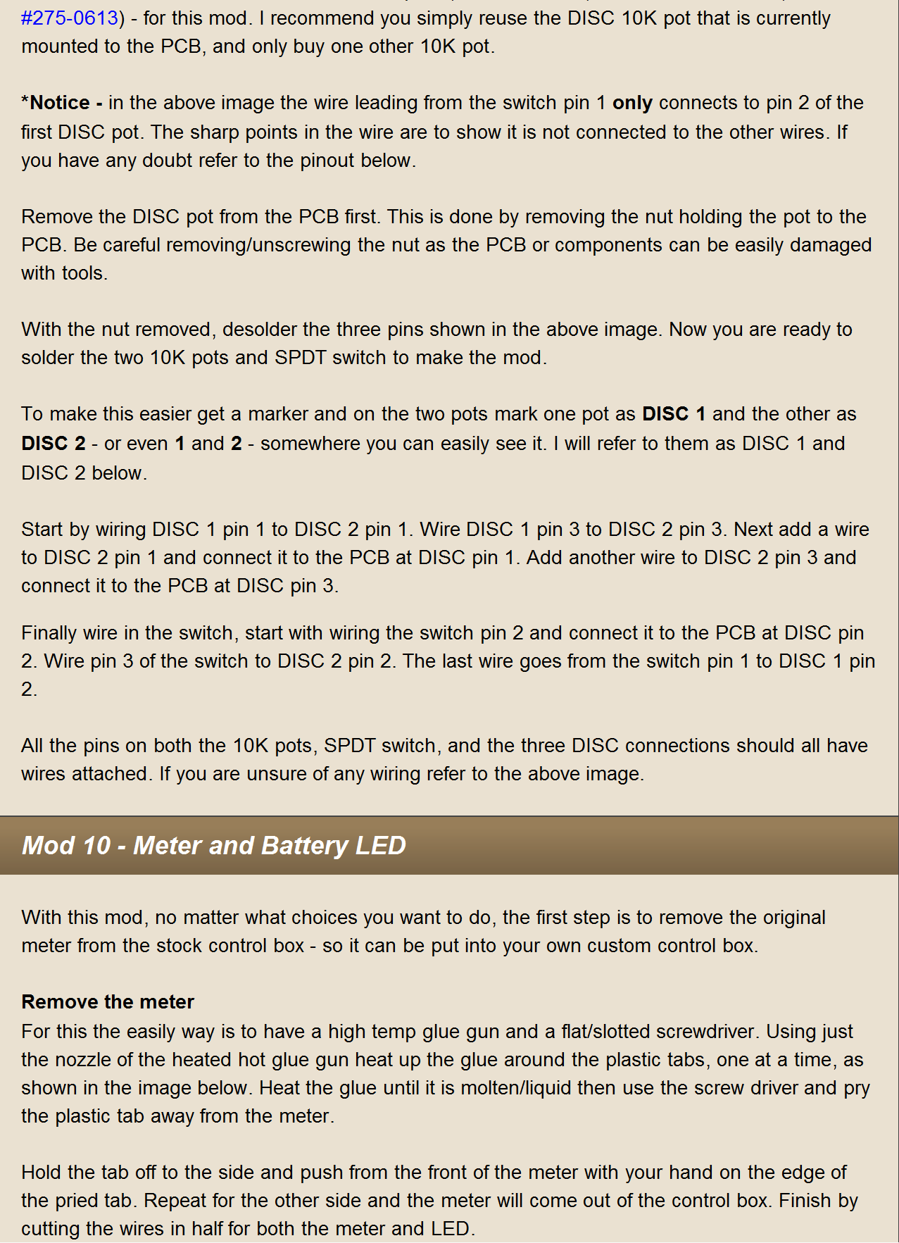

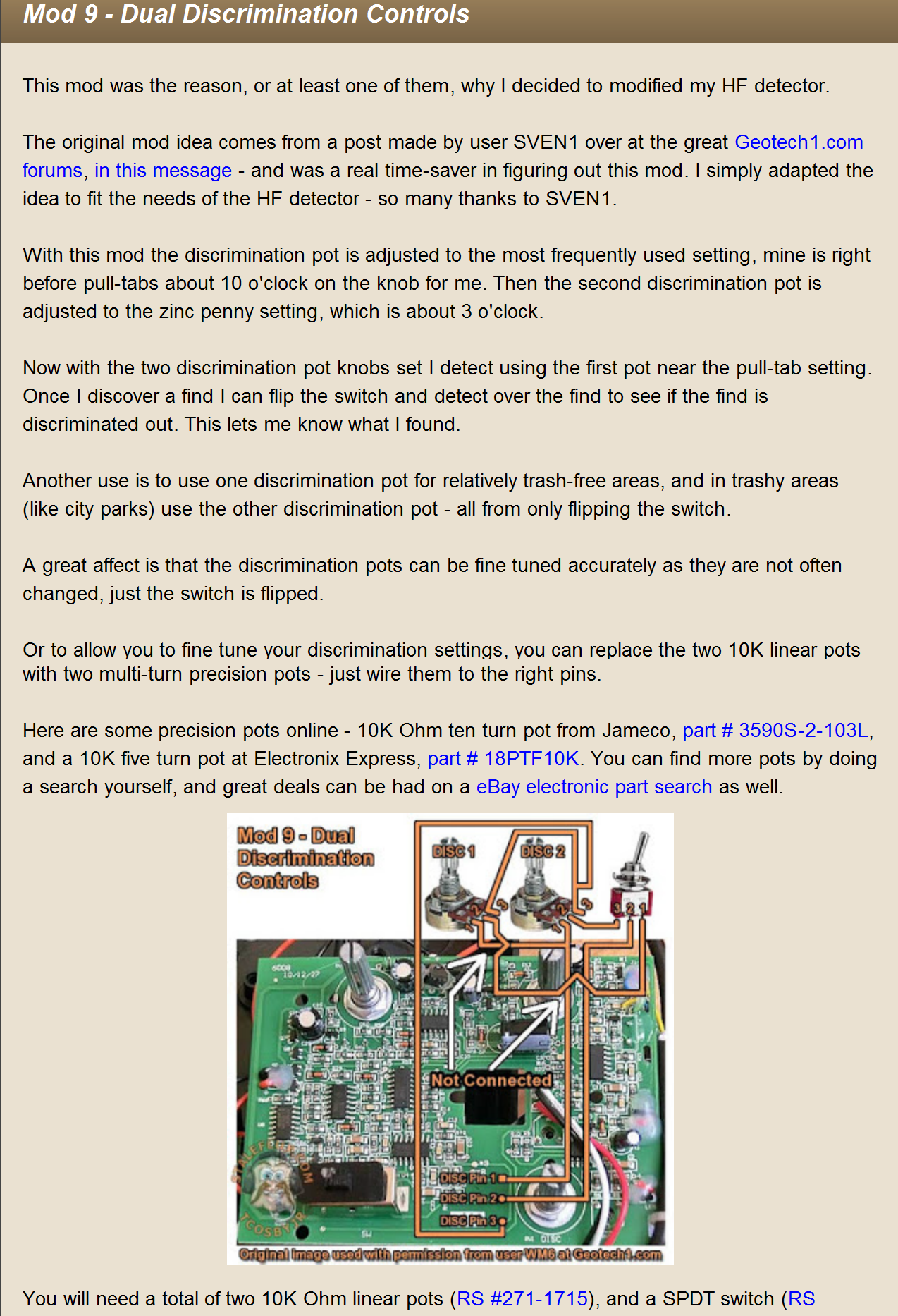

    • Dual DISC/TONE knobs added to make changing detecting targets easy - also aids in easier identification of object in the ground by switching the DISC back and forth as needed

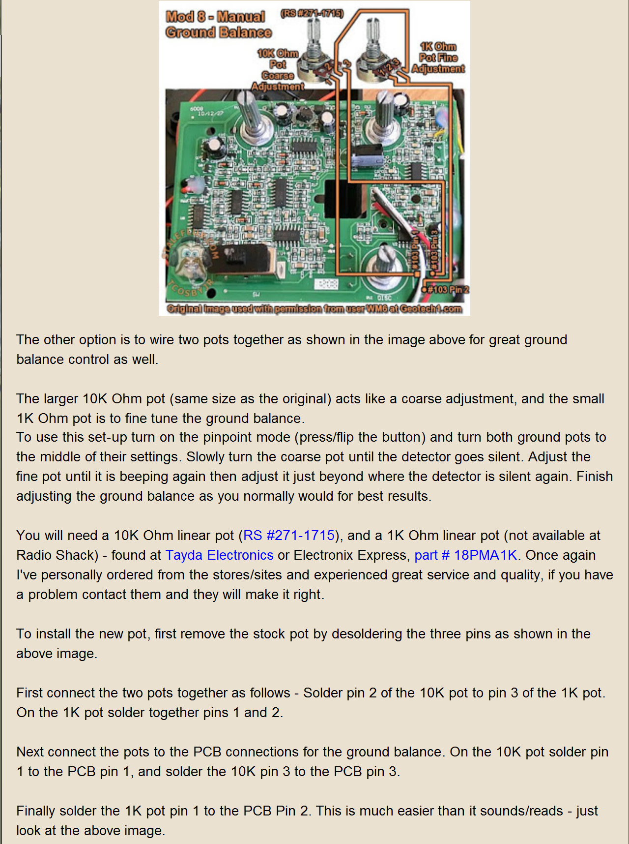

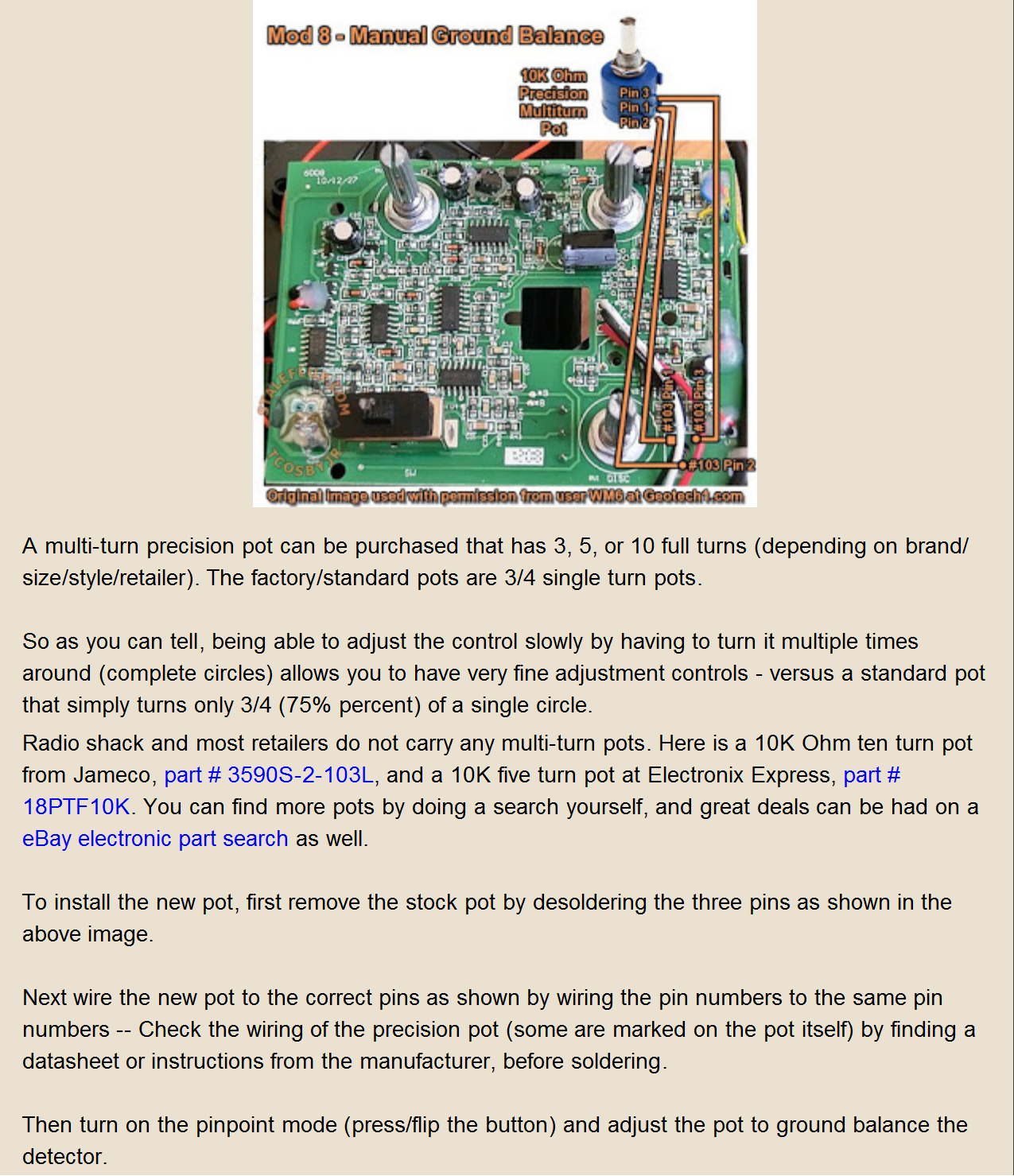

    • Ground control added - and I included a course and fine knobs to allow accurate control/set-up

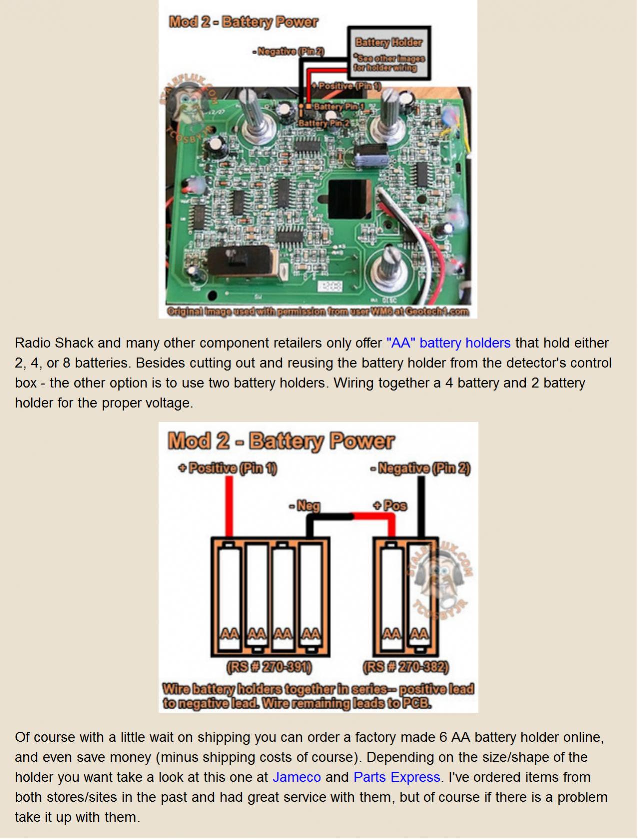

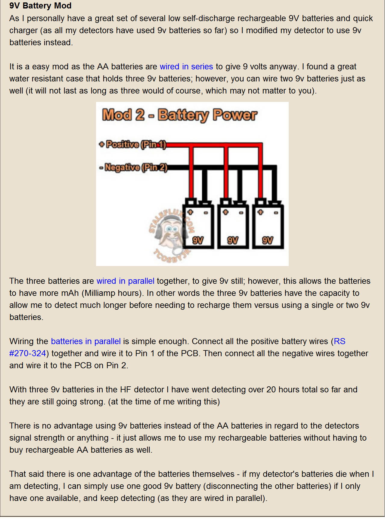

    • Battery type switched to 9V batteries - as I have many great 9V rechargeable's I wanted to use from my other detectors; however, it can easily be switched to 6 AA batteries again if I prefer.
    • Battery tray is water resistant, has a simple latch to allow easy battery changes when detecting, and holds three 9V batteries for longer detecting time. Also this allows me to continue detecting even if I only have a single 9V battery as only one is required to power the detector.

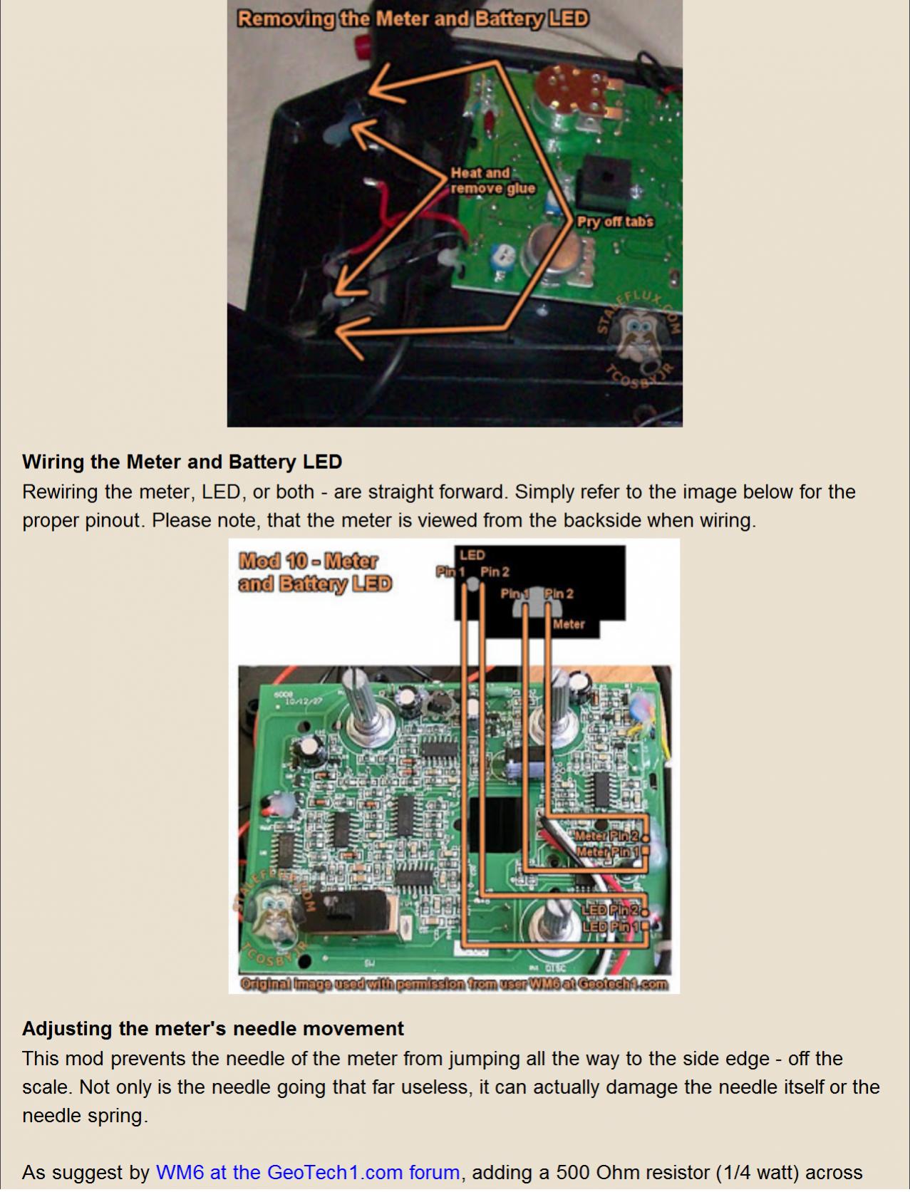

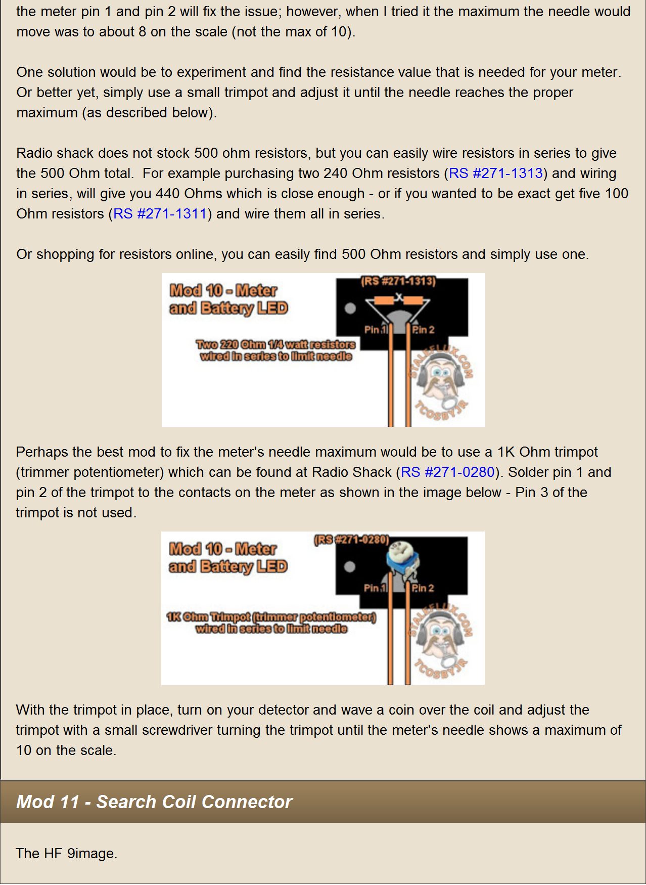

    • A custom control box was created above the handle to house the meter (which does work to display strength/depth of a found target), On/Off switch, DISC 1/DISC 2 switch to change discrimination settings, and toggle pinpoint switch so I do not have to hold the button -- all within easy thumb reach while detecting
    • ...And many other things "under the hood"

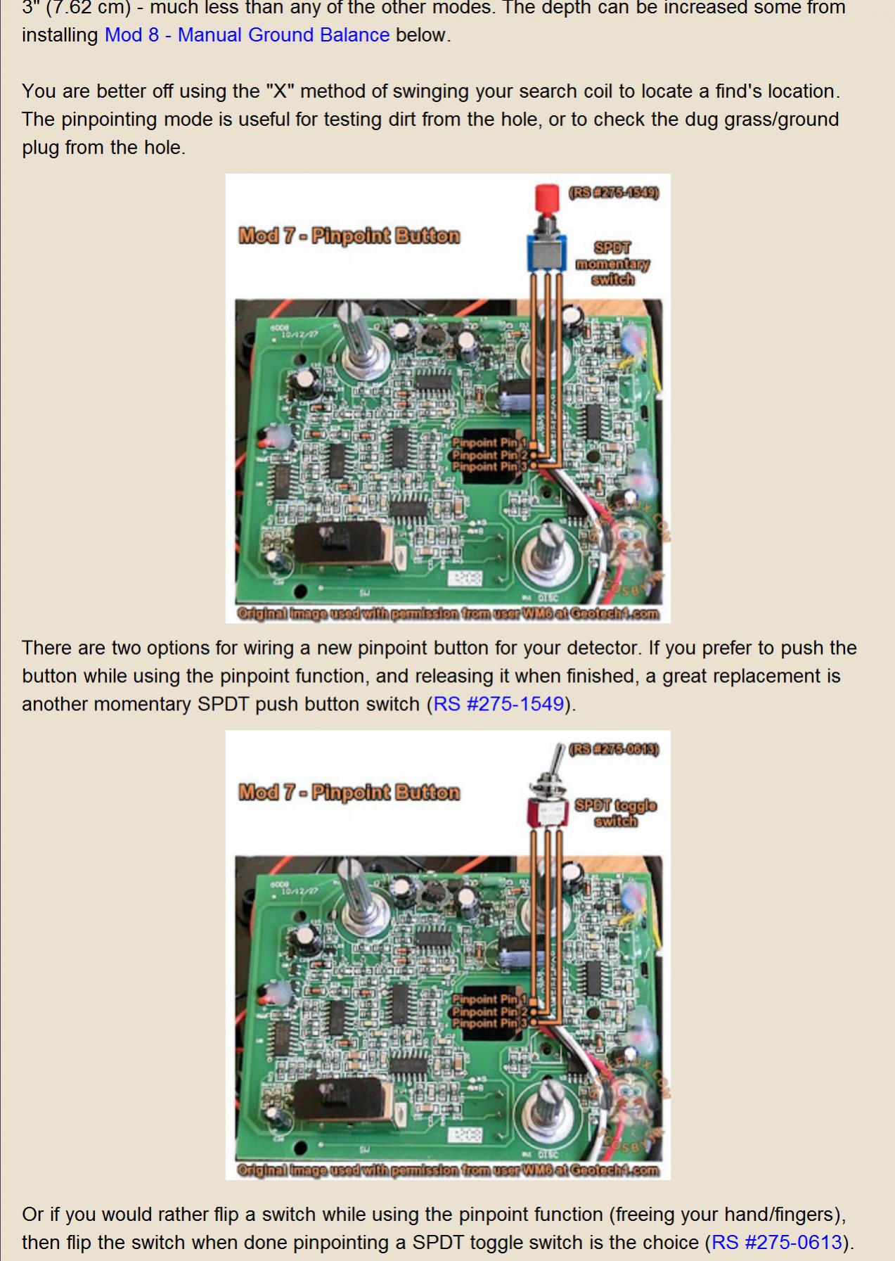

        How does perform pinpoint mode in test? On mine 6008 (still unmoded, but I am plannin at least to put GEB on outside) only half of motion mode depth. Not very usable and probably I will withdrawn pinpoint function in favour (of place) of GEB pot. I prefer to pinpoint by X-ing and use pinpoint button on detectors very rare.
          The pinpoint performs like yours, about half the depth compared to regular motion detecting. I thought it still may come in handy, perhaps using it around metal fences and children playgrounds, but I'm not sure.
          If placing items is a issue it would be better to use something else like the GEB pot. Indeed the typical X-ing of the coil is the best for actual pinpointing use in any detector.

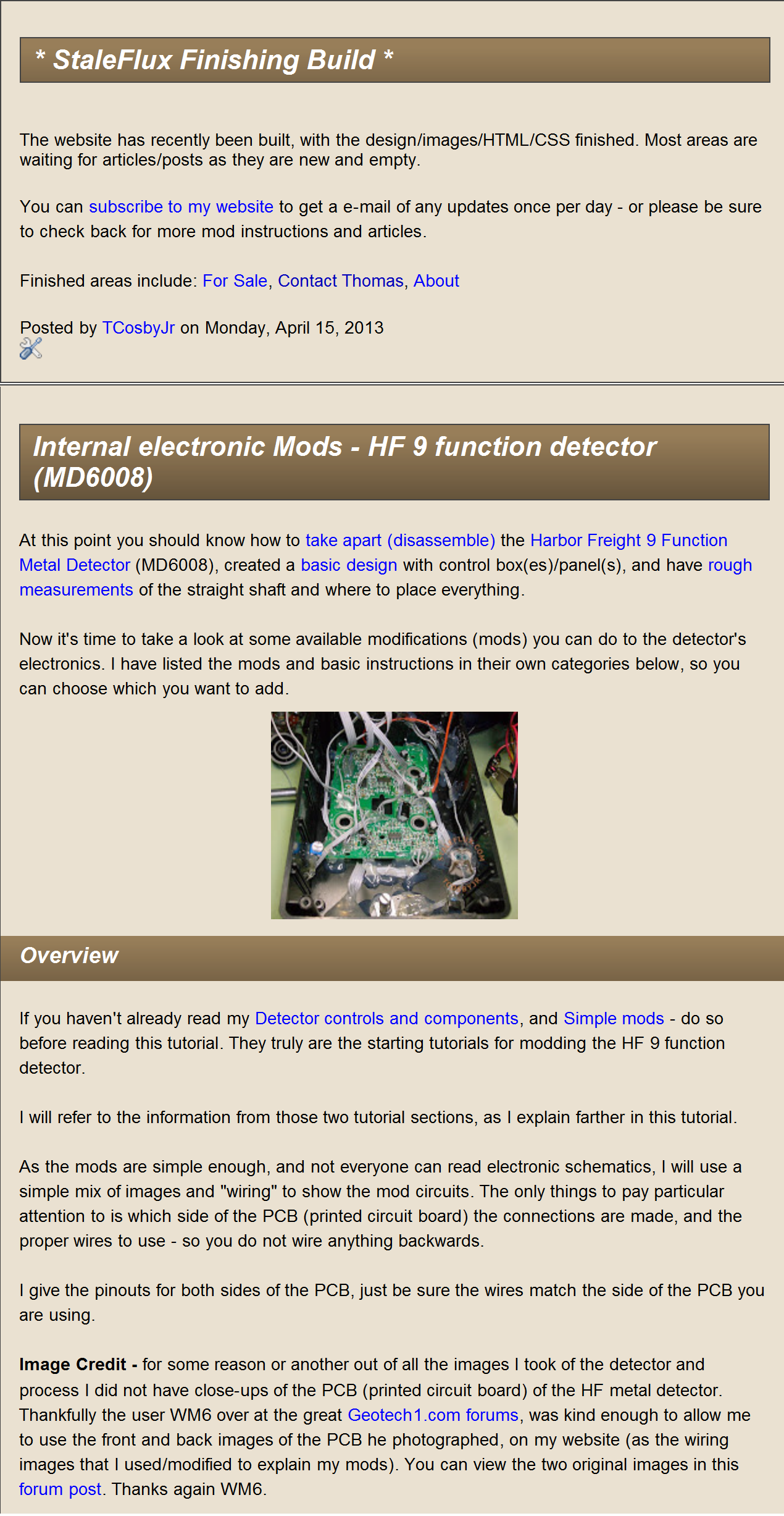

              I completed most of the detailed instructions and build info with multiple images - nearly all the mod information, electronics (with part numbers and supplier links), and such are completed at my website. The only real thing missing are the final test results, some custom rod build details, and small other details; however, with a bit of looking around at the images and the details I did write you can create one like mine or better already.
              I must admit my website is in limbo, and hasn't been updated in a month. I have other related projects, and to finish the HF detector info, but working 6 days a week I find little time for anything. Although I will eventually get it all up and running when I find the time.
              You can find my website at staleflux.com and here is a direct link to the mod information. If you have any specific questions after reading my articles feel free to contact me here or through my website and I'll try to help.

                Very well documented, clear documentation TCosbyJr. Thanks.
