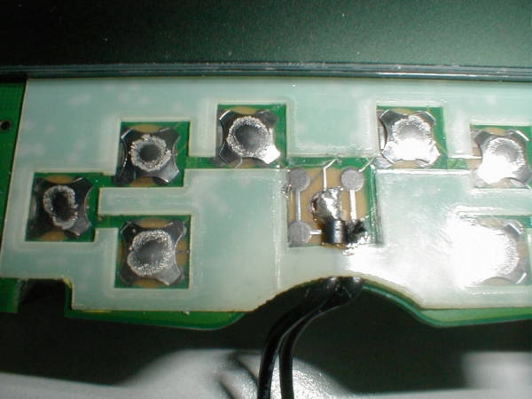

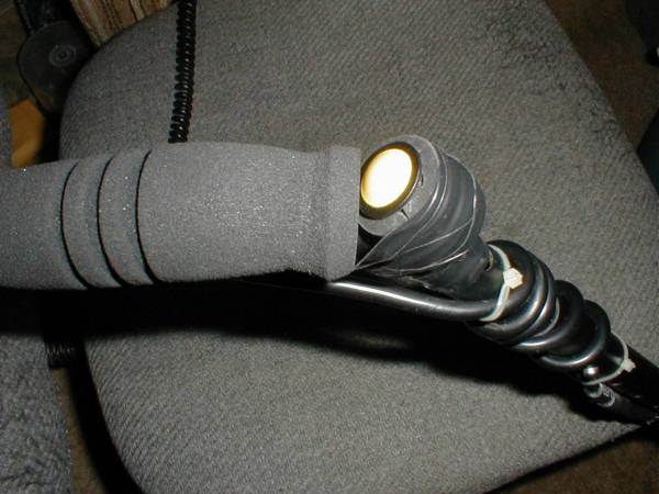

ID:	337382 Take the box apart and take the face plate out and be careful, i sent a picture and you'll see were i soldered the wires to, you have to take that little piece off the top very careful and pry up were the wires have to go, but be careful you don't want to break nothing and run two long wires up to you handle and mount a pushbutton switch too it and you can tape it right their, then when you need pinpoint just push the button and you got it. and were your going to solder you have to be careful and scrape were your going to solder. Harold
                    here's where i put my switch, HaroldClick image for larger version
                      Interesting work but this is the 250, Euroace or 350 - the 150 has only 3 buttons and the middle one is for sensitivity - see here:
                      http://www.treasurefinders.net/Garret%20Ace%20150.htm
                      btw. that way you must locate the housing closer to the coil which gives higher weight.
                      Pretty useless modification if you ask me but thanks for the pix - if one of those press-button contacts is "broken"
                      we know now how it looks there and it should be no problem to fix those thin pcb connections by soldering.
                        well i forgot that it was a 150, i did this to mine because i made it waterproof for freshwater hunting, Harold
