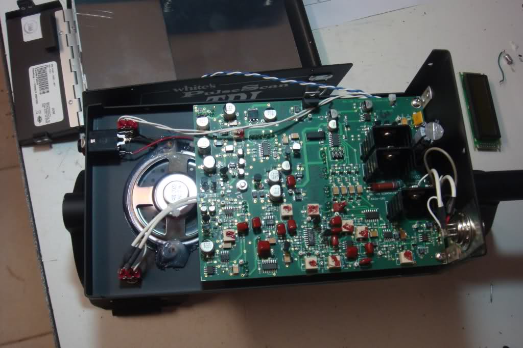

      What i meant was: if you look at the GS4 schem, Currently the signal from the pre-amp goes into both channels. what i'm proposing is leaving the signal from pre-amp to the gold channel as is, then , interupt the signal to the iron channel and add a Variable delay (not sample delay), This variable delay effectively stores the signal for 25-500 milliseconds and then releases it into the iron channel.
      The GB won't work if the 2 channels are skewed, as Reg suggested.

        Also , the resistors on this TDI pic look like foil types... is this right?Click image for larger version

        If not the vishay catalogue will be my friend
        Will see how i go on design , any suggestions would help... particularly on the signal strength after the integrators/ first tl0722....
