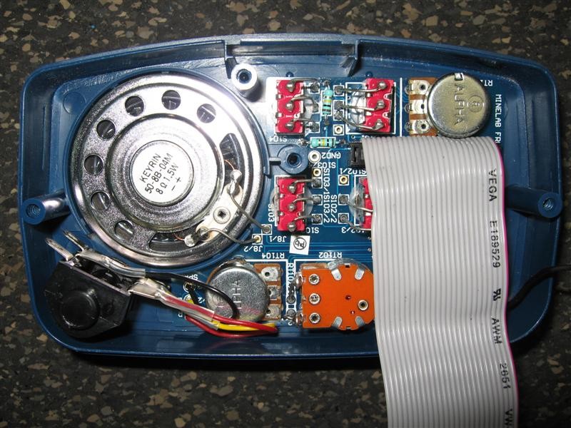

    Hi there Peeps can anyone shed some light on this matter I have a GT and wish to replace the the DISC controller which is part number RT103 on the circuit board. This is the pot controller, what I need to know is the circuit board a multi layer board where I can not remove the pot or is it a straight solder and replace job. Also can anyone tell me the values of the POT for me to buy a replacement thank all best wishes from peter ([email protected])
    27 kOhm measured. though do not know a real value, do not see a marking at it.
      Easy to change, if you can handle a soldering iron then no problem.
        Hi there Plumabob are you saying it just a quick soldering job in that it not a multi layer circuit board??????
          Pit, where are you from? if you are in UK Sean Goddard will fix up your problem speedy and well.
            Peter,
            Not sure what you mean about a multi layer board. There's a front and a back, nothing in between. 3 holes 3 pins..... simple job.
            Bob
              what for somebody is hard work for anyone is simple labour. panel board is two sided. not mine photo. disc pot at right top corner.

                Peter we can measure pot and order a replacement then replace. Happy to help but from what I've seen so far your skill with iron is well up to the job.

                      Okay if the board is a bog standard circuit board that changing the POT is no problem for me Woodbob if you know the resistance of the POT then I would buy one from you yet again thank you all for your help
                        Okay PEEPS lots of good help here but has anyone ever got the true ohms value of the disc pot as I want to make this change over a one step process to reduce possible damage to the board
                          true Ohms... 30-100 KILO OHMS = 30.000-100.000 = 30 000 - 100 000 Ohms.

                              Disc repair completed the POT was 100k ohm see photo below
