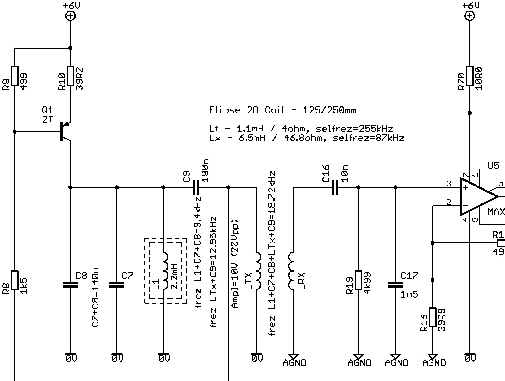

                          The White's MXT searchcoils might be adaptable but would probably require additional resonating capacitance in the transmit circuit.
                          no need require additional resonating capacitance in the transmit circuit, Dave. the TX in troy is specific... not ordinary and not standart, as you can see in another simple VLFs... may be there is a serial resonance. I do not know... but primary LC contour of parallel voltage resonance is set on PCB, secondary you can see a serial current resonance LC contour, THE coil itself, if there is yet this current resonance... so, from that, in my opinion, the topickiller has to find out coils with 1-1,2mH TX winding, connect and research its on depth.
                          this pic is of MRAND, I hope he will follow my speach by something he considers to be need...

                              no need require additional resonating capacitance in the transmit circuit, Dave. the TX in troy is specific... not ordinary and not standart, as you can see ...
