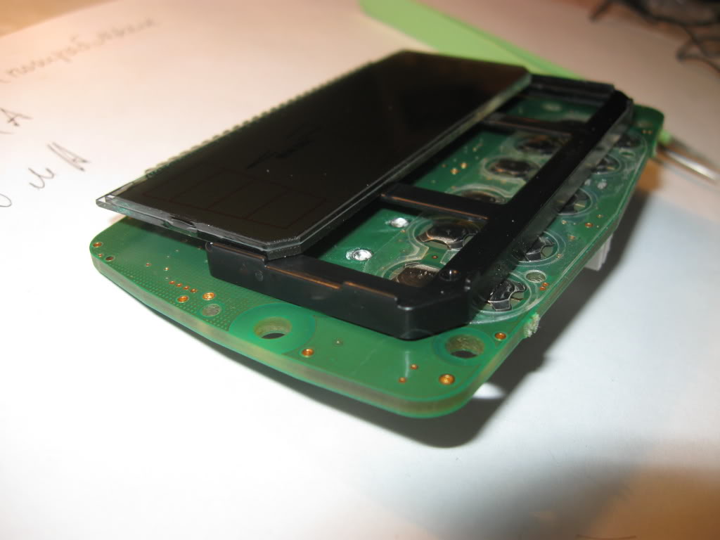

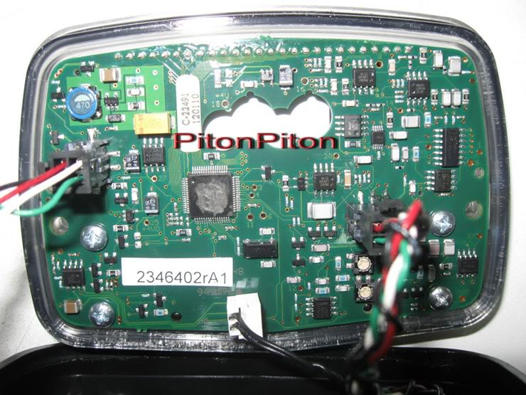

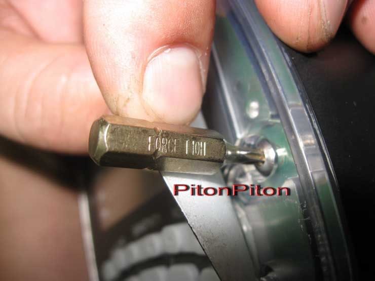

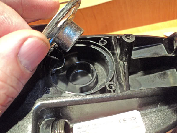

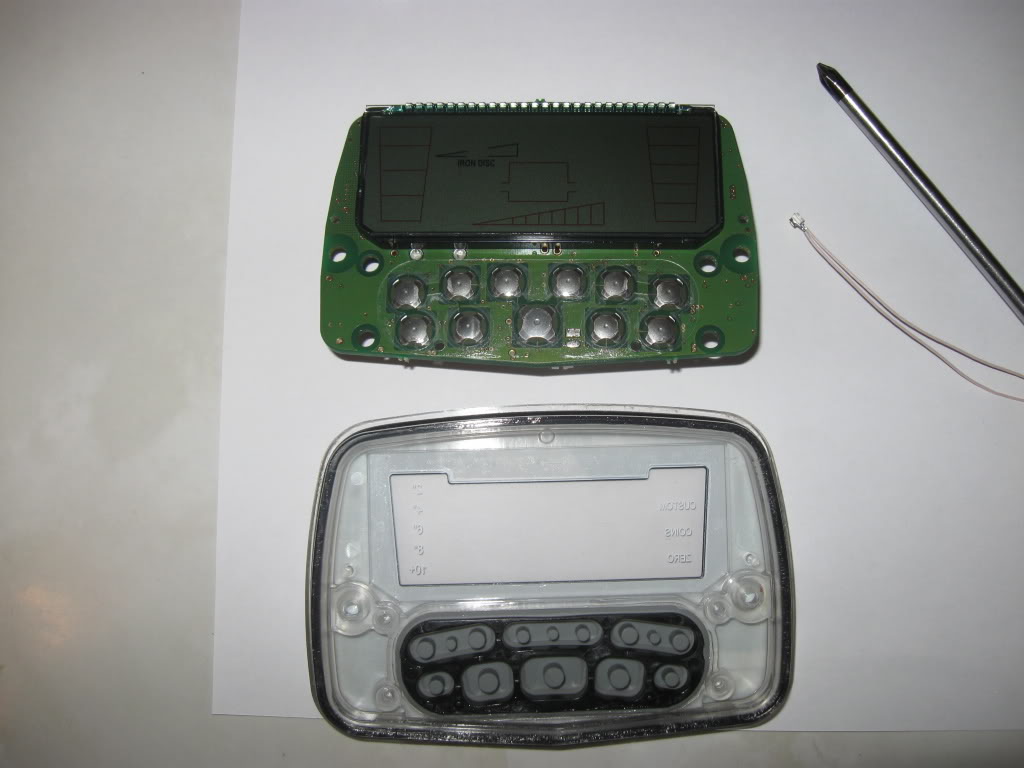

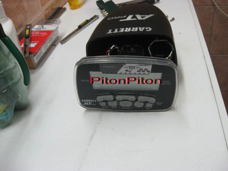

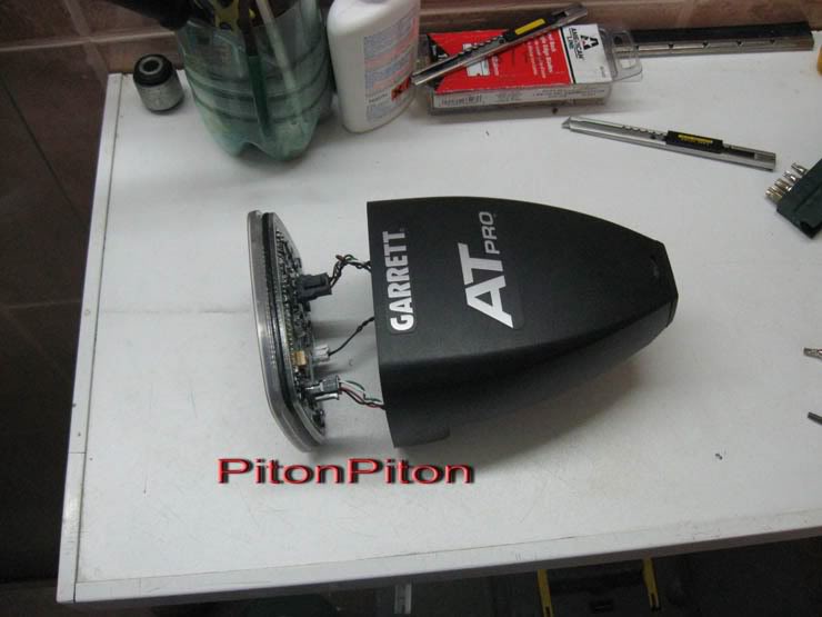

    Anyone knows how to take Garret AT Pro control box apart ?
    If its like a 250, use a wrench to undo the 5 pin lock nut and audio jack nut.
    Remove batt cover and remove the 2 Philips screws - it comes apart now

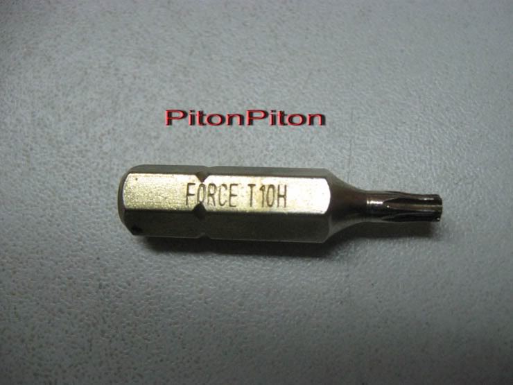

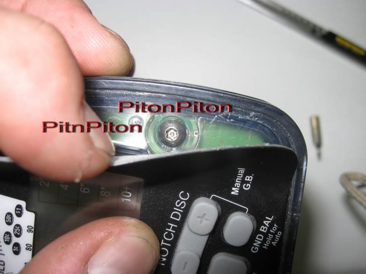

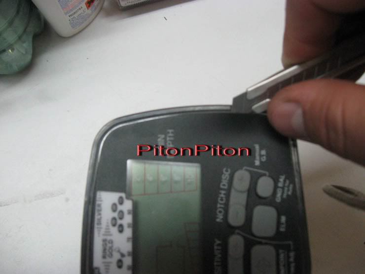

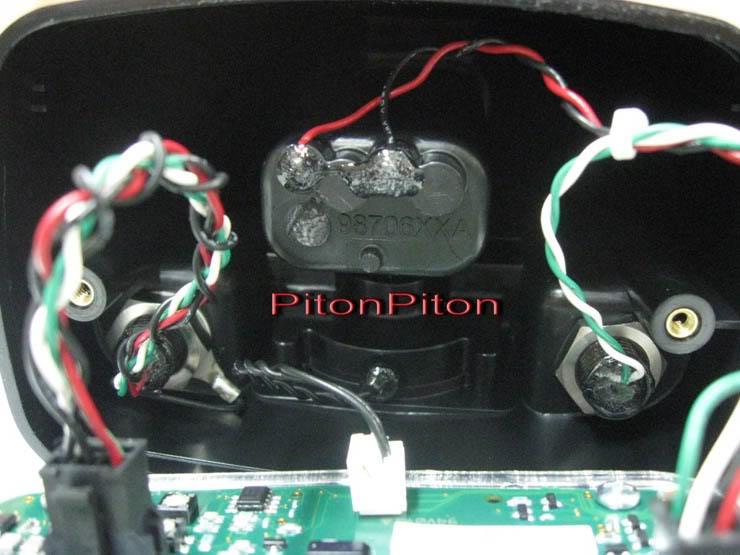

      Sorry but AT Pro is different I found out myself ( two torx screws holding face and box together, there is large oring that making it waterproof ) Ace is not waterproof AT Pro is
        The torx screws are under the faceplate decal. The best way to get them out is to press on the decal to locate the screws, then carefully cut clean circles around the screws with an X-Acto.

              ufff.. some abridgement on pics amount here...

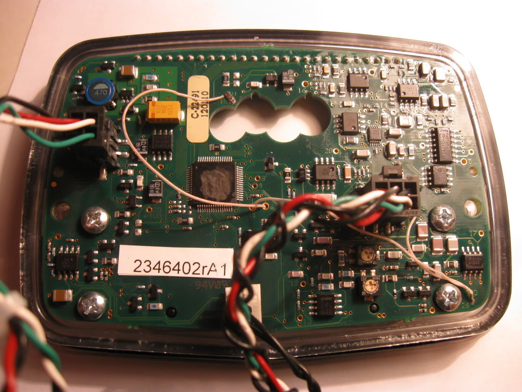

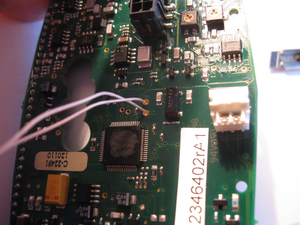

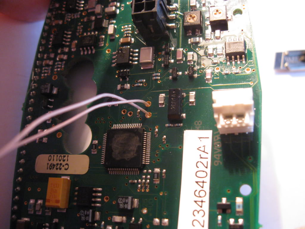

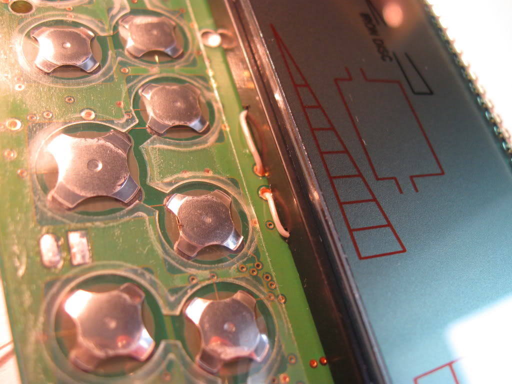

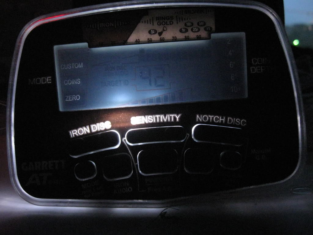

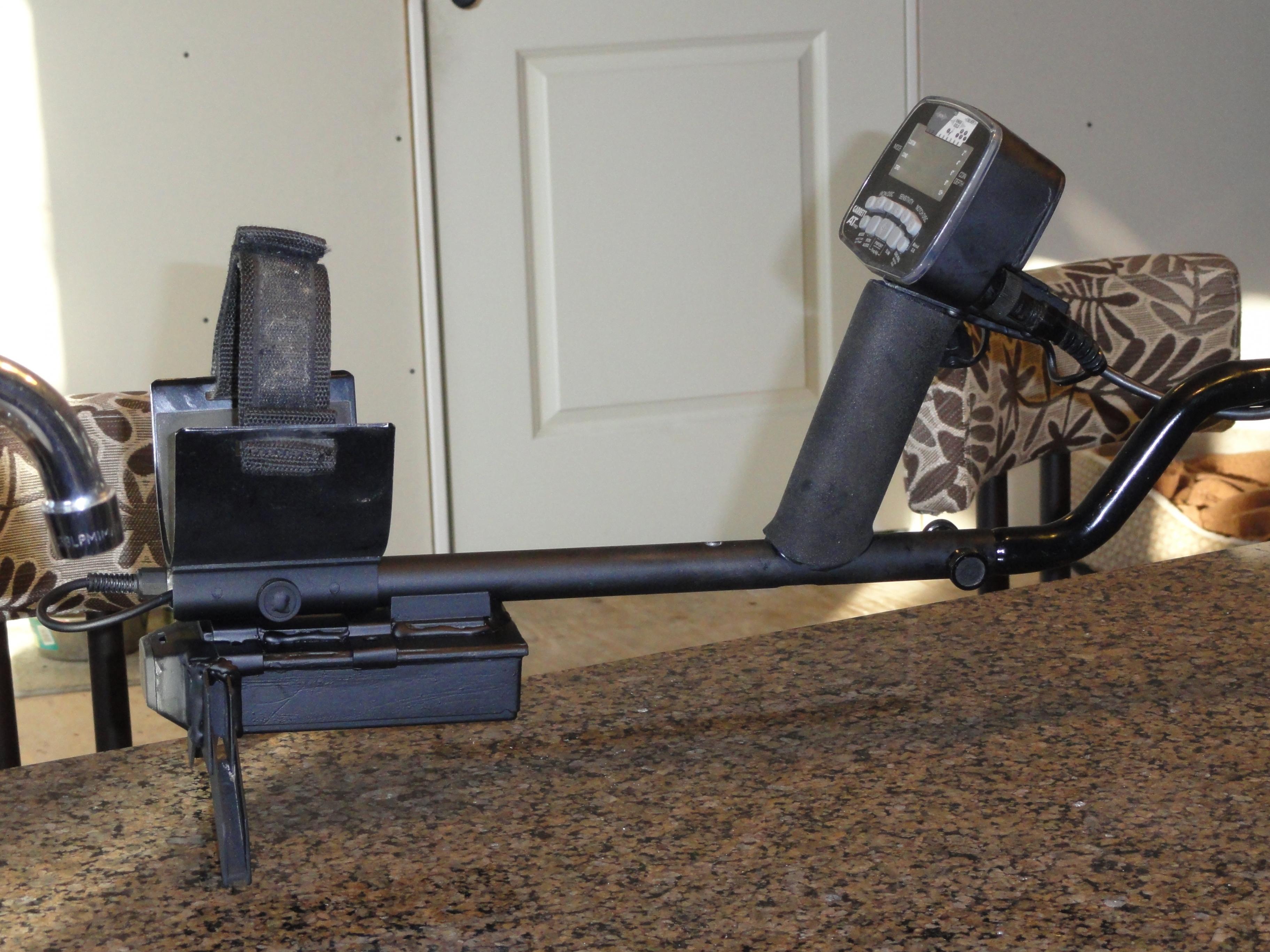

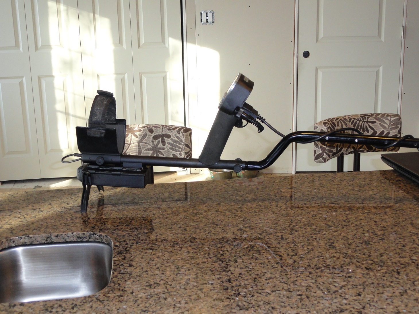

ID:	339270Here my modified AT ProClick image for larger version
