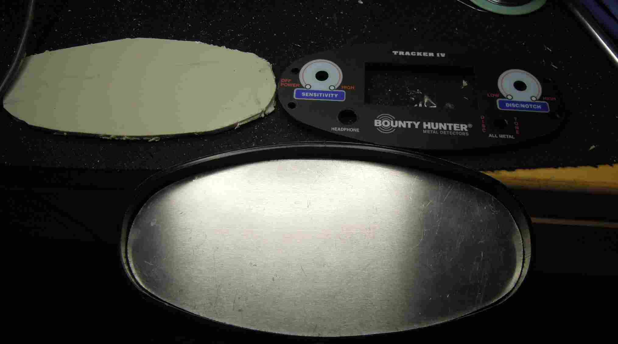

      Here's some new front panel's one metal one plastic;

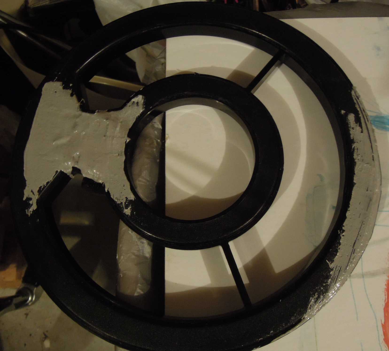

            Opened up the Tracker Coil today to get rid of the TX cap.
            Running it on the Bandito gives 15.2 khz and 9.2V P/P.
            The SMT Bandito will fit right in the Tracker case and
            use the same batteries. It gives an airtest of 9" on gold
            and silver and 7" - 9" on coins. It could be little better
            but certainly acceptable as it a bit better than I was
            getting with the original setup...

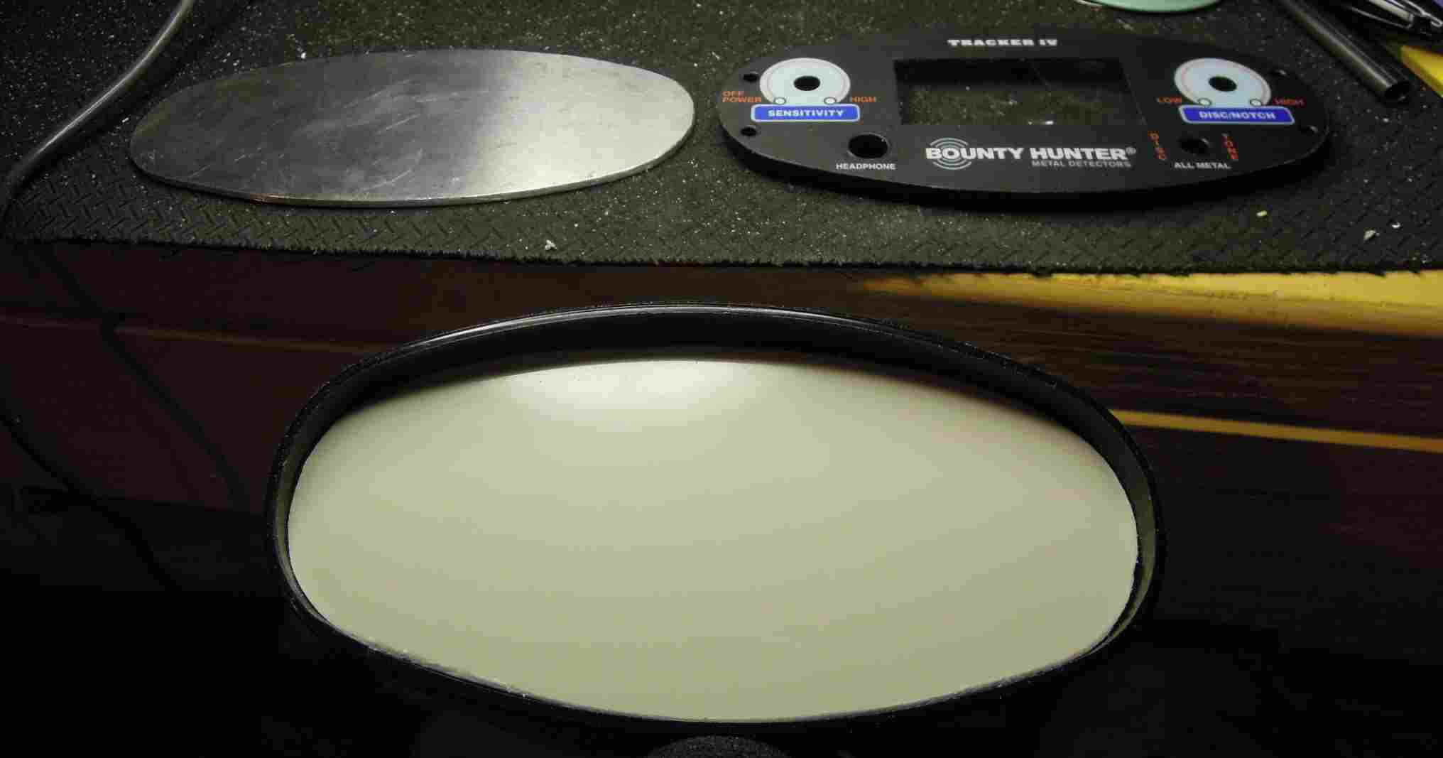

              Now to finish the new front panel and package it up!
              The threshold didn't seem to do much so I'll set it with a fixed resistor on the board. So we'll need Disc,
              GEB, Sens, PP Switch and headphone jack on the front panel. The machinest at work said if I sketch something
              up he'll make a panel and label for me!

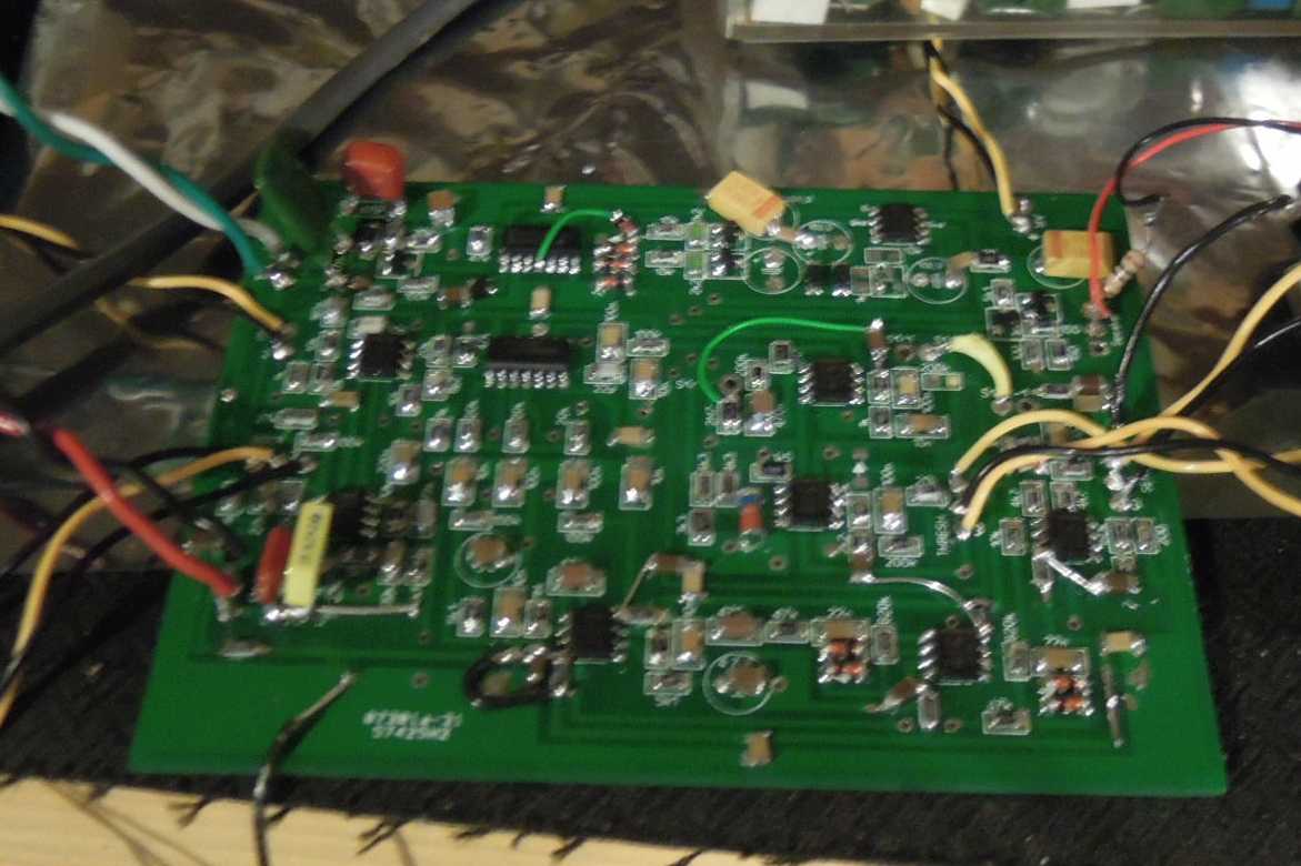

                I was ready before but cleaned the flux off the board and broke it! It will still
                oscillate if the sens is turned up too far but is a bit better. At some frequencies
                it would run on or continue to oscillate after the target is gone.
                I matched the resistors and caps in the filters but am not sure if that was a good idea?
                Mismatched ones might reduce oscillations. One TLC2262 died from being shorted so I
                am using a LM358 for the threshold op amp it seems to work fine...
                I still may try some fine tuning but have to be careful not to ruin anything. While
                messing around I changed one 1 meg resistor for the original 1 meg and gained 1"!
                Some seem to be 1003 and some 1010 even thought they are 1% so tiny changes can
                make big changes in this circuit.

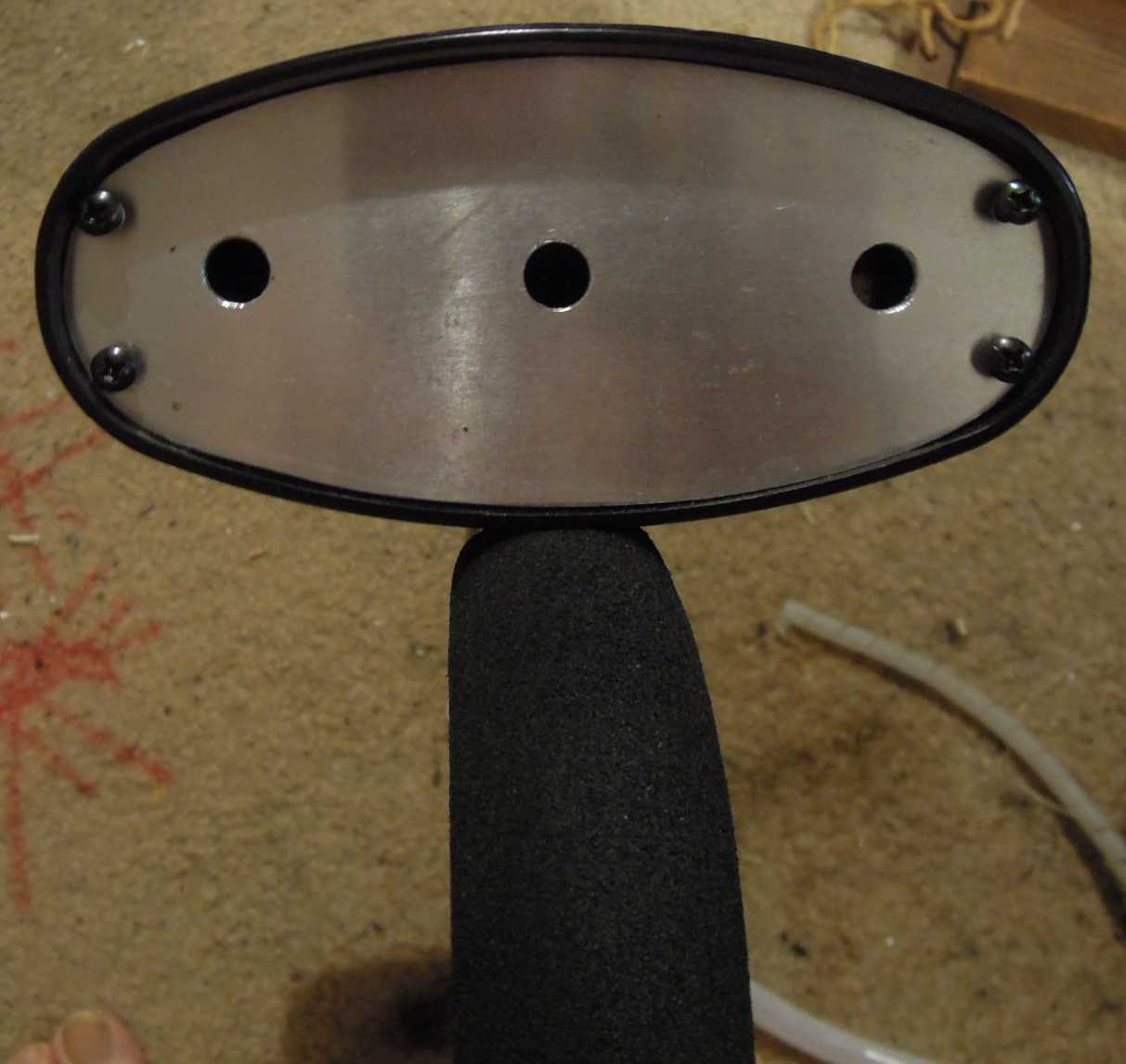

                        The SMT Bandito board is done and I'm working on putting it in the housing.
                        Using the Tracker Coil (with the TX cap removed) I am running at 12.5 Khz
                        with a 10.2 volt Peak to Peak TX. The residual RX is 280 mv. The board draws
                        15 ma when not sounding.

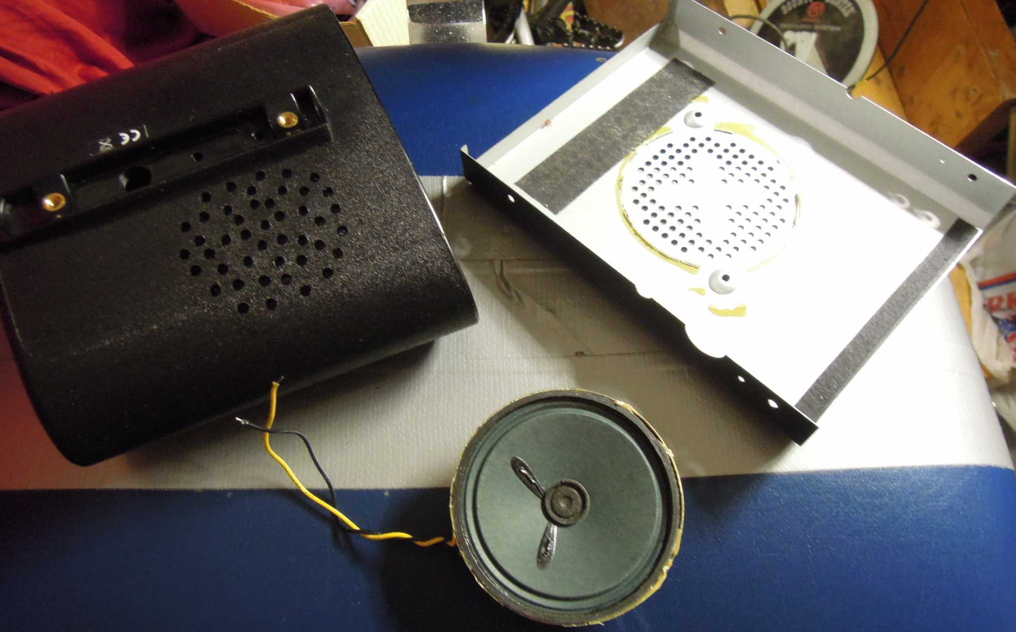

                        I gained another 1" by using a CB radio speaker. It allowed more sens.
                        So I get about 9" on coins 11" on a gold ring and 13" ona silver dollar in the air.
                        The original Bandito tested at the same time got 7" on coins, 8" on the gold ring and 9" on the silver dollar.
                        Here's some pictures;

                        It is loud with that CB speaker too! I need to figure a volume control...

                          thanks SD, the speaker idea may be usefull for other projects here, users here are allways asking for good loud speakers, and those are standard radio speakers, cheap as chips and easy to get hold of, excellent job.
