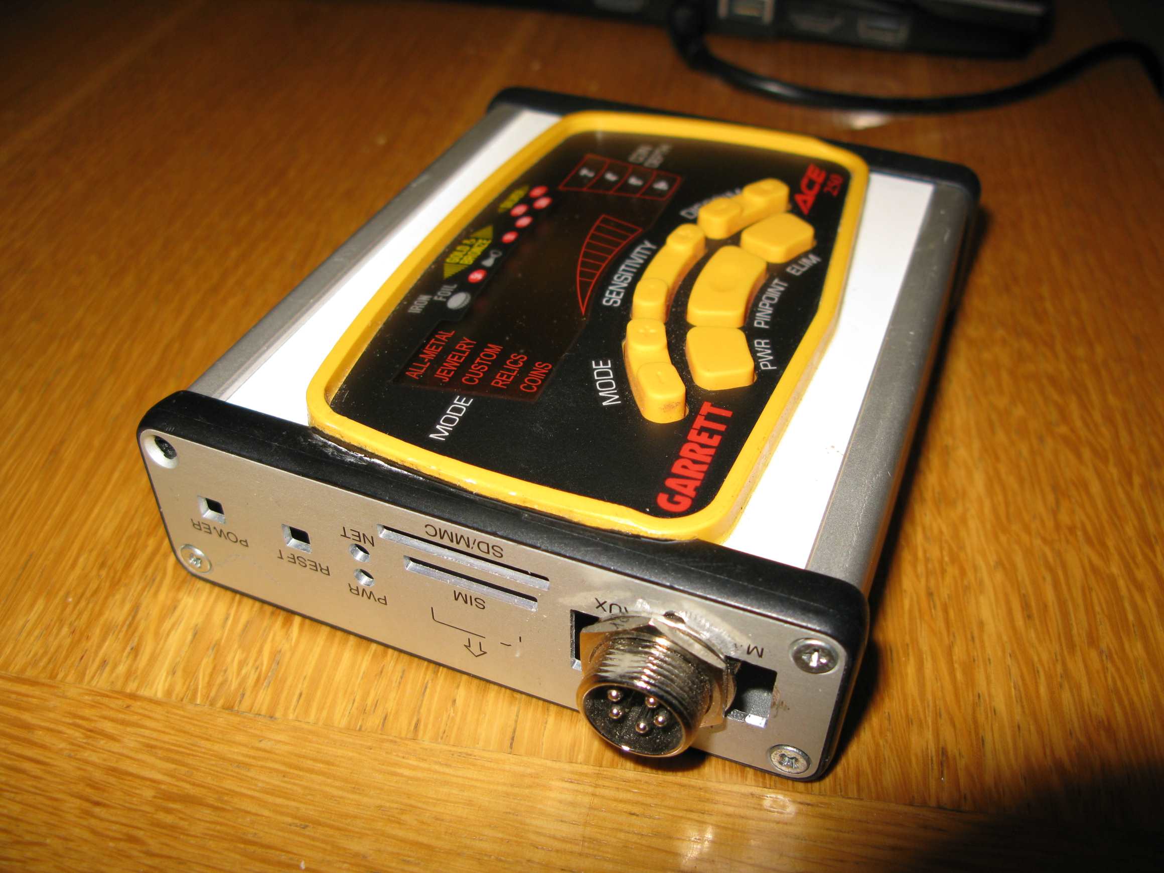

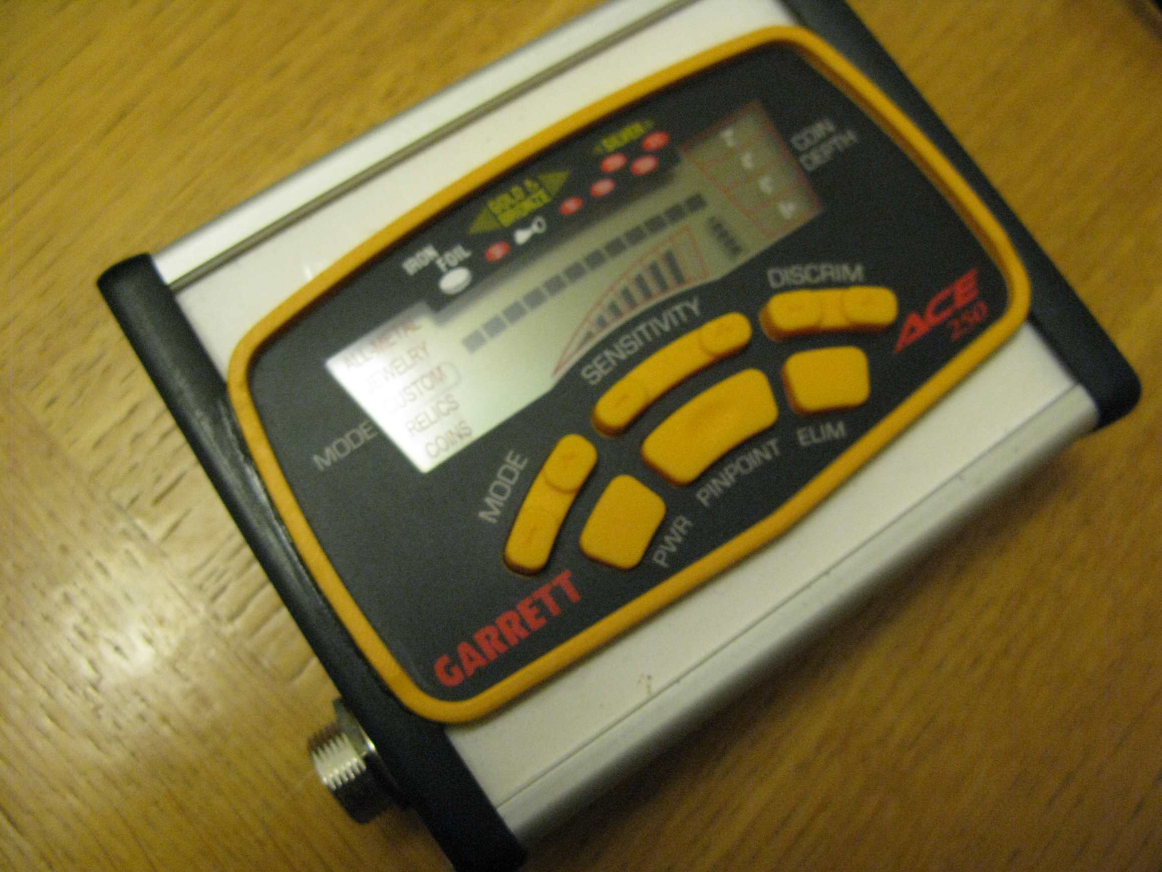

ID:	340392Boxed up the 250 into an old hammond case.
          16khz Tx
          Put 2 lipos in and had an hour out earlier.

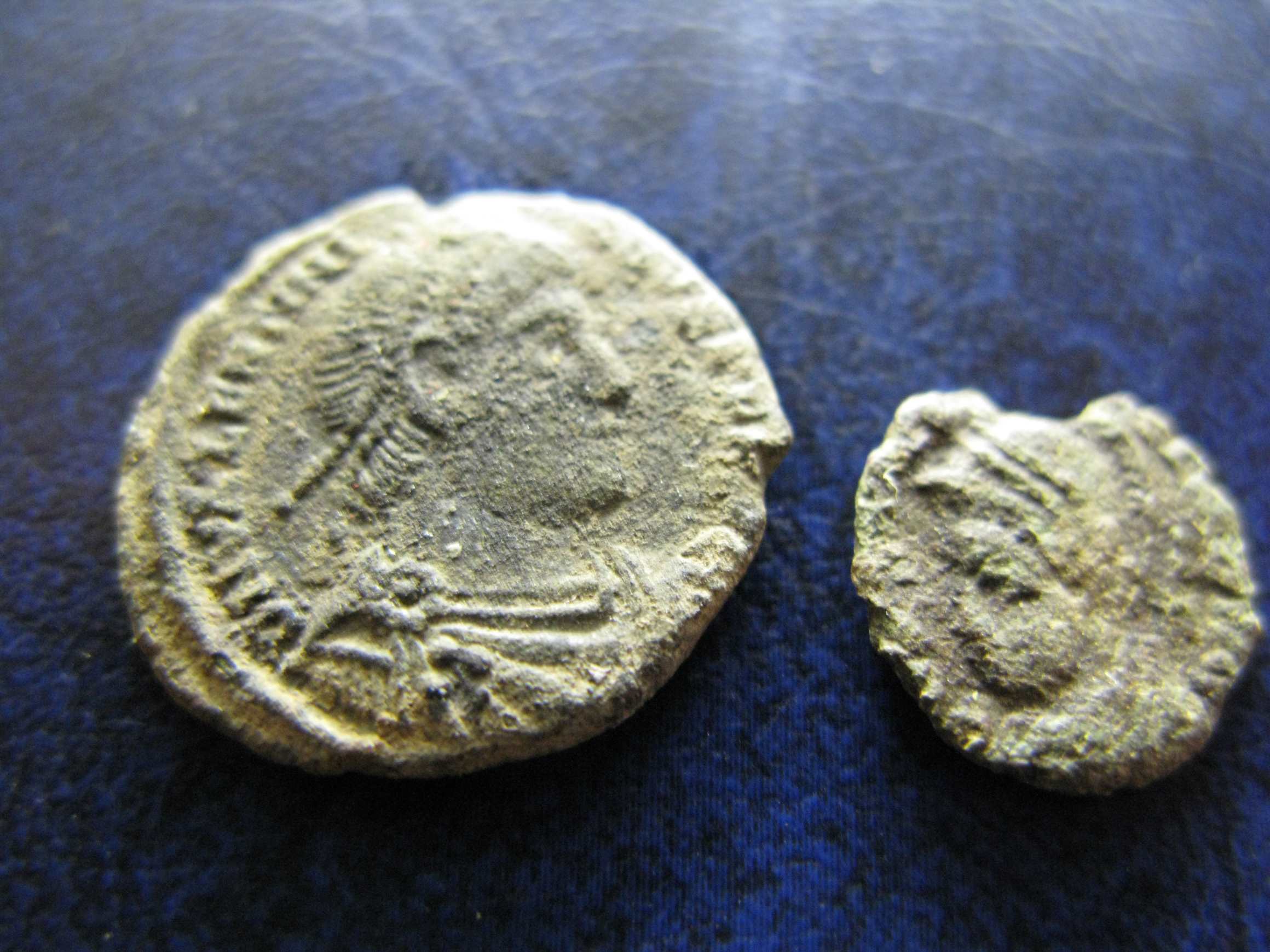

          Pulled a couple of roman, the small one is 11mm acros , few bits of lead, copper alloy etc encouraging.
