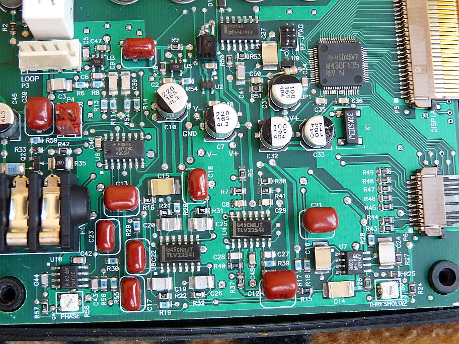

    It looks to be microprocessor controlled. You'd need access to the program to get the
    target data. It's probably locked to prevent copying/altering the code. You could try to
    piggyback off the display but it wouldn't be easy as the frequency of a pin tells if it's on
    or off. If you open it up and take some pictures we might be able to determine better
    what could be done...

      I will take photos of the inside. Is there any particular part to focus on specially?
        Just a nice clear photo of the board straight on.
          Just got to find out how to post the picture!
          I've reduced the resolution to cut the data load.
          Is there a max. picture size on this forum?
          If you need the picture in greater resolution, just ask.
          ThanksClick image for larger version

            The most worth while modification on the Prizim range is doing away with the preset threshold on the board and mounting external pot to give option of external threshold instead of just silence missing harder to locate targets.
              Hello satdaveuk,
              Thank you for your resonance. I will be changing both pots R58 & R23 to external multiturn ones as specified in the following forum link:
              I will be measuring both pots once unsoldered and before twiddling around with them,
              just so I have a baseline in case something somehow goes strangely wrong ...
              I will post when I've done this, probably by mid next week.
                I think the only way to get multi-tone out of this is to redo the firmware to msp430 micro in the upper right of Polymer's photo. If there are better pictures of the board, is there someone around that can derive a schematic? It might be worth it on this detector, as the msp430 is a pretty capable mcu.
                  Satdaveuk:
                  It works! I'm thrilled! The value of the installed tiny pot was 920 to 120 Ohms. So not many turns on the new pot to reach the end.
                  The threshold does become very audible and the detecting distance in air in pinpoint mode is clearly better
                  Getting the pot externally installed with a knob to fit will be more of a challenge I think. Haven't completed that yet.

                  I am racking my brains to somehow use the 8 icons signalling to get multitone.
                  If you would like hi-res pics, I will post them.
                    Thanks All.
                    I bought a Prizm V sold as defective and fixed it. My pardner loves the multitone. I would rather spend my time building & perfecting the Baracuda and Nupi pinpointer instead of possibly never figuring this one out.
                    Technos: You're right. The Prizm V looks the same inside (as the II) and just the firmware is different. Well, the faceplate/display has a few more options...
