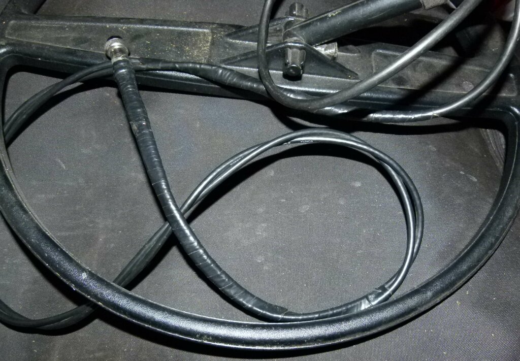

      For chest-mount or hang around the neck units the usual Garrett coil-cable is not really the best choice!
      Too unstable, too thin.
      I have modified my Garrett GTI 1500 into "super light-weight" version while using a 45cm Detech coil.
      For the cable you just can use the coax radio-antenna RU-58 or something with 1-2mm less diameter:
      http://en.wikipedia.org/wiki/Coaxial_cable
      At least the Garrett GT 1500 (and I guess all other Garretts, too) has absolutly no problems
      because of some wave-disturbances caused by even 1 meter longer and different thick cables.
      (usually antenna cables have to be adjusted at their connectors so the signal remains good -
      this is the Ohm's wave-value antenna-cables have, but its more a topic for TV & Radio stuff)
      Anyway, in our case it must have steel-wires and steelwire-shielding otherwise while sweeping
      if its copper it will break too fast. And you should improve neuralgic points with alot tape.
      Finally the situation should be that the usual "weak" Garrett coil cable only is winded around the
      pole without bending or moving if the search coil is in use while the stronger and thicker steelwire
      coax etc. cables receive (and absorb) all the movement-energy.
      btw. this single (non-coax) 5. Garrett coil-wire mostly is for pinpointing and find-screening only.
      The Garrett GTI 1500 orig. coil has it also connected while the 45cm Detech doesn't has it at all.
      Perhaps this is the same with other models.
      However - for such mods always take care that the movable cable-part is NOT made of copper!
      Copperwires will break very fast with all these draging, tearing and moving around.
      The thinner it is, the faster you could get problems.
      Especially important also is the region of the coil-cable connector - alot of tape
      has to be used to reduce the more concentrated bending and weight energies there!
      Close to the connector the bendable plastic-tape has to be winded thick while it gets
      the next 15-25cm always thinner and thinner - for best possible flexiblity!

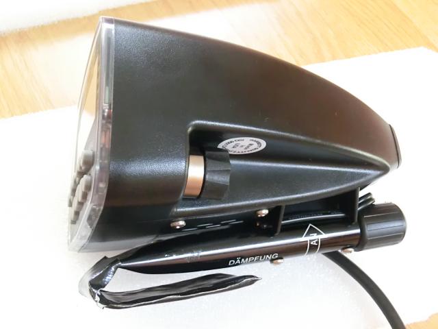

      @ WM6
      The new Garrett Euro Ace also uses the same DD coil as shown on your picture.
      For mountain hiking your solution is perfect and this coil also is very lightweight.
      Ive been already 2300m above sealevel with the Euro Ace, close to an old mine.
      Is this pole you are using for the coil some telescopical glass fiber hiking stock?
