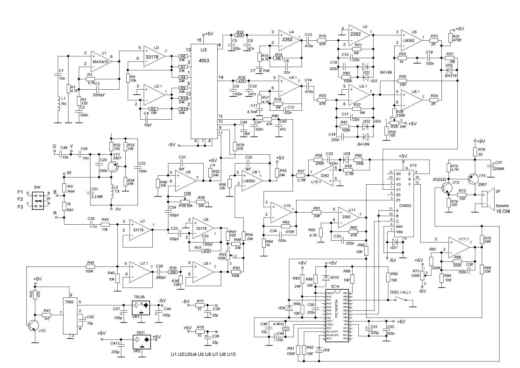

    Has anybody experimented with ferrite material on their coils? I'm aware that placing ferrite material near or in the middle of a coil will raise the inductance. If i were to place a piece of ferrite material on or above a metal detector coil could i raise the frequency of the coil/detector? I'm also aware that brass material placed on or near a coil will lower the inductance.
    Short answer: No, avoid sticking lumps of metal anywhere near a coil, except for a few specific reasons.
    It might help if you told us more info. VLF machine, I presume? Any specific model? Concentric coil? DD coil? BFO maybe?
      Using a tesoro cebola with a concentric coil. For experimental purposes i want to raise the frequency about 2 khz.
        Definitely NO then. I thought you might be wanting less than 1% change ( eg. to avoid a frequency clash with another identical machine). Changing the operating freq of a machine is a major project.
          Ferrite is a bad idea as it increases your null residual signal.
          You could use a smaller cap for C20 in this schematic then switch
          back to the same value for stock frequency.

          The original has a freq tweaker switch which could be reconfigured to
          change the frequency further away.
          The RX is series resonant so I don't think you need to change anything there...

                    Ham, you won't see a bit of difference with the Compadre at 16.5k instead of 12k, and even less difference with the Cibola at 16.5k instead of 14.5k. If you really want to prove it to yourself, I think the transmitter on the Compadre is free-running (I don't recall if it is on the Cibola) so you can easily increase the frequency by reducing the tank cap. Don't ask me which cap or by how much, you'll have to trace out the TX circuit and figure it out cause I don't know.
                    Edit: I see Silver Dollar provided you with the right info above.

                              Skippy's right... 50kHz for small thin chains, 5kHz for large fat rings, and everything in between. And no one has mentioned the effects of ground mineralization vs frequency. Again, if you want to find out for yourself, play with C20.
