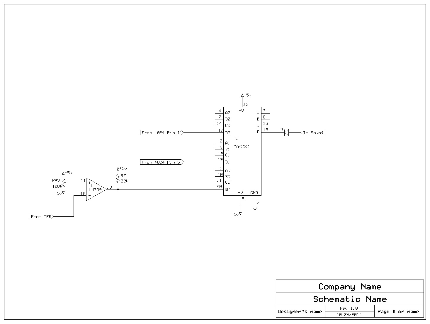

    Well here's 2 tone mod I was planning on using in my Bandito.
    You may have to change the MAX333 I was using it as it has
    4 switches and you only need 1 (but it has to be DPDT).

        Well a 4066 is single pole single throw. A 4053 is a double pole. The idea is to use one of
        the clock outputs from the 4024 when the GEB channel is positive and a different one
        when negative. So that switch chooses the tone.

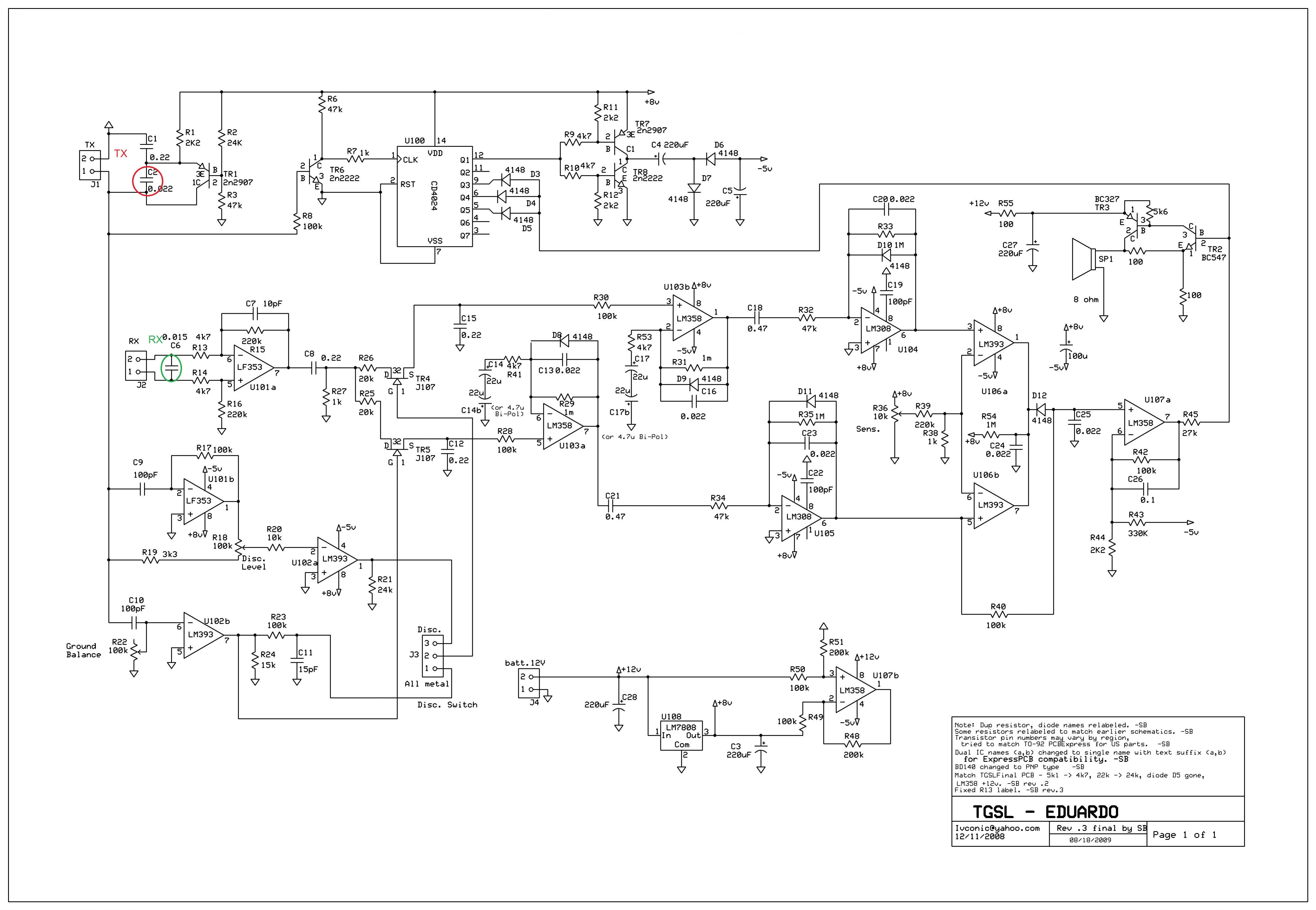

          Ok, I will go pick one up and give it a try. After looking at your schematic I decided that I am not as smart as I thought I was. Just making sure GEB is the output of the disc pot, and the pot R47 is where I would adjust the break point? Thanks
            You would adjust it on R49 on the add in pcb and the GEB line would go to u105 pin 6 or u106b pin 5 on this schematic;

            I don't think the Compadre schematic was ever shown so you have to figure out where that point is on your machine.
            The circuit should be pretty similar to this schematic.

                  Why is the diode there. Isn't this an output, and won't a diode completely block the output to the sound? I would understand this, if it was pointing the other way...
                  I'm not an electronics guru just a firmware guru with some electronic knowlege.
                    Well you have to look at the rest of the circuit. The "output" is an envelope that is chopped
                    by the signal on the cathode side of the diode.

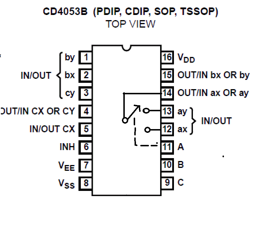

                      I am having trouble understanding which pinouts to use on the 4053. http://www.ti.com/lit/ds/symlink/cd4051b.pdf It looks like it has multipull switches I dont know which I need? I lack the knowledge about how this works. If someone tells me where to connect I can solder it up nicely. But I cant really addlib. I can follow a schematic if I dont have to change anything. Thanks
                        Here's a picture to help you understand. The 4053 has 3 switches. Each has a common and two switched contacts.
                        The single letter pin is the control pin.

                          Thanks, I am starting to understand this a little better. Where do I connect the out to sound? Does it go direct to the speaker or do I tie into the circuit?

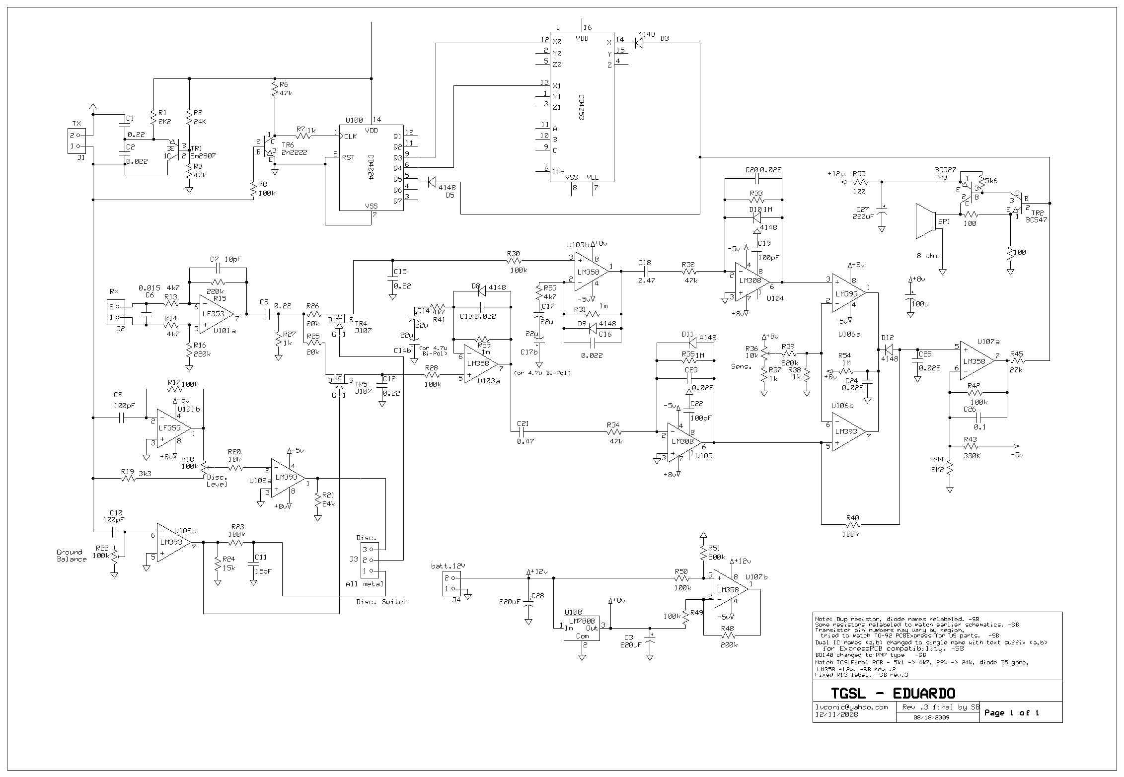

                            Well here is the EDU schematic with the 4053 added in you would still need the other chip to control it...

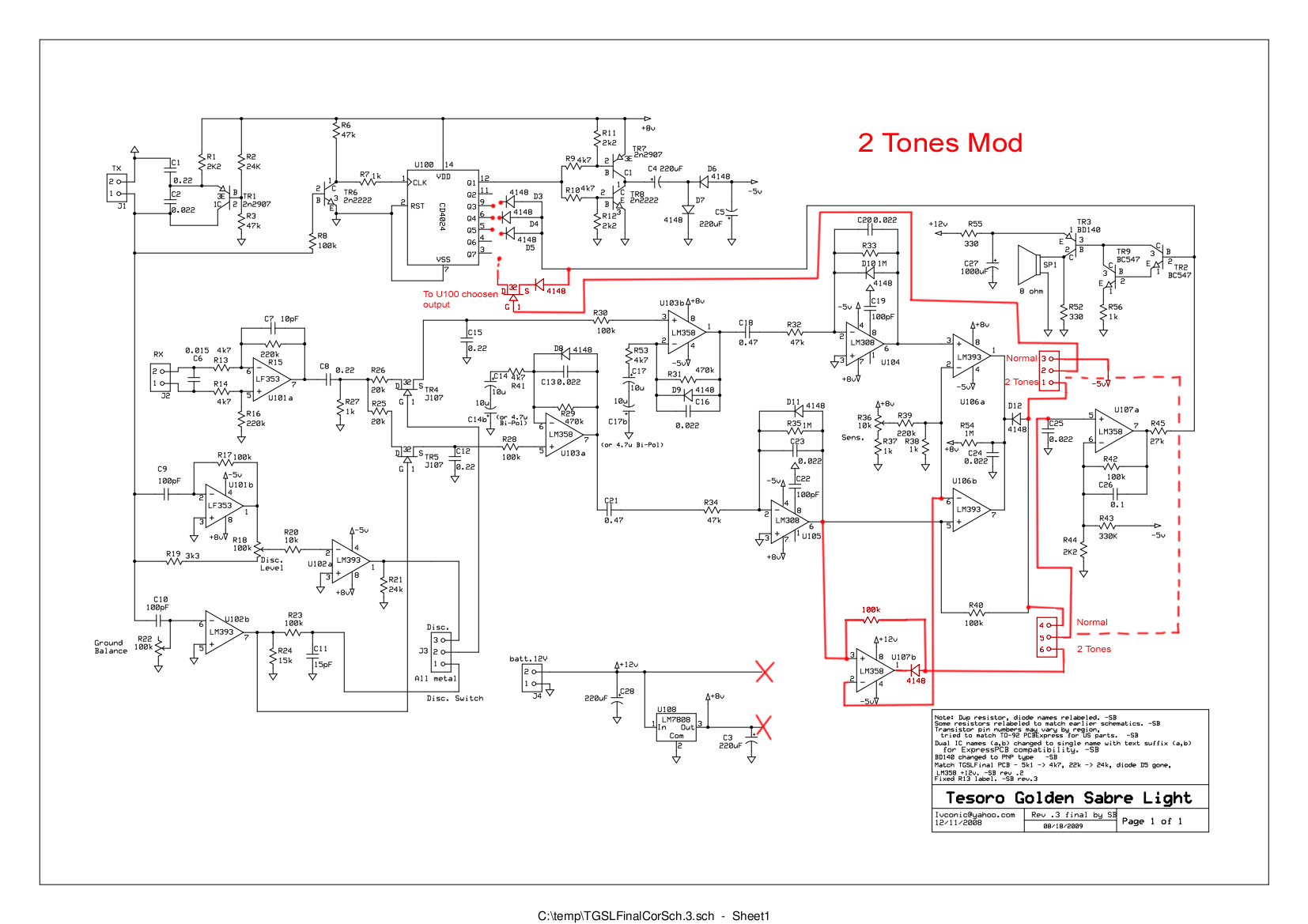

                            There also was some info on 2 tones in the TGSL thread. There is a pcb available form silverdog;

                            And a modified schematic;

                              Thanks, all the voltages appear to be +5v or -5v. Are these required or can I use other voltages. Specifically, I found a 4.55v free contact for the positive and ground for the -. Sorry I keep asking so many questions, I dont want to fry my detector.
