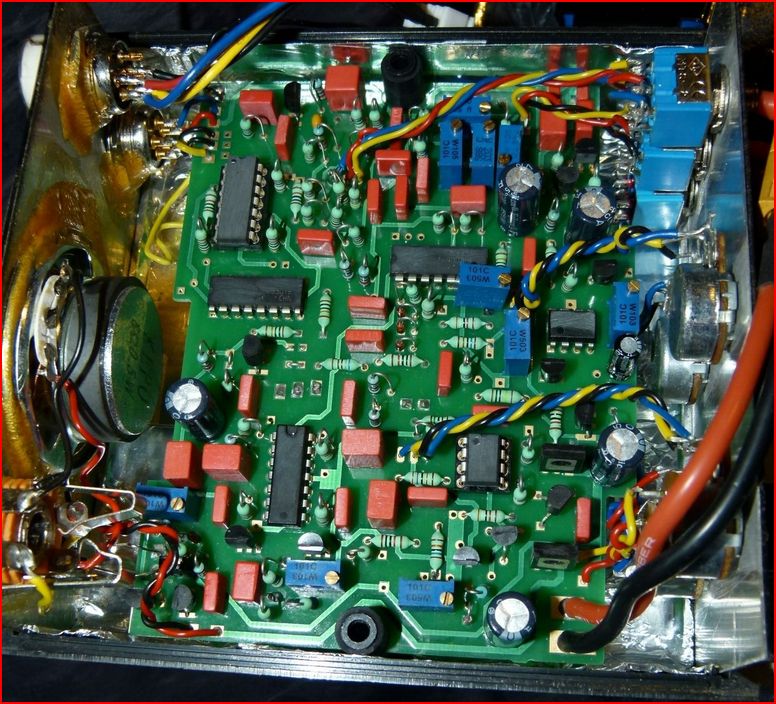

    I found the thread about adding the 2 tone mod to the Tesoro Golden Sabre very interesting but I was wondering if it is possible to attach the mod to different analogue detectors other than Tesoros, as was hinted at in the thread at one point, unless I misunderstood that. The Blisstool V3 that I have would be much easier to use if a 2 tone mod would work on it but it is powered by a 12 volt Lithiam-ion battery so would it "fry" the mod? The picture of the inside of the Blisstool is copied from one already posted on this forum by Henrikras. I don't think he'll mind me pinching his picture.

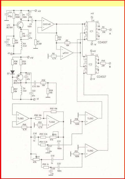

            I've read elsewhere on this forum that the Blisstool is based on the 1980 "Magnum," the English name for which is the "Enigma". It ran at 16.8 kHz, I believe. Then there are the "Wave" detectors also from Bulgaria. One model of this brand (Terminator) runs at 8kHz (as does the Bliss) and looks very similar indeed to it externally, but has two tone ID fitted. This is what gave me the idea that I could maybe mod my Bliss with two tone ID as there is a schematic for the Terminator available. It would make identifying iron a lot easier.

              I made a two tone 1 1/2 year ago
              Heya Muddyfingers..
              Two tones at the Blisstool isn't easy. You know I made one attempt 1,5 years ago.
              I had no scematic so I was made by measureing at the board where there were a different when the signal broke up.
              I found that at the 8 pin Audio IC... At that IC the clear signal and the scartzy signal from the Disc. IC meet and with ampl. like LM 341 I could get that little high impedance signal usefull. Then It was only to find the place where the tone change and calibrate my new signal into a DC and lower it down so the Tone changed when the signal was Breaking up.
              The problem is... The Bliss got 3 disc. adjustments and to find the excact adjustment was impossible...
              The system I made overloaded at target close to the coil! So a nice Roman coin at 1" sounded like a rusty iron...
              I gave up, allso because my Blisstool never was stable. One day perfect next day ****.
              The Best adwise I can give you is to forget any modification at your Bliss, and enjoy those day its running smooth....

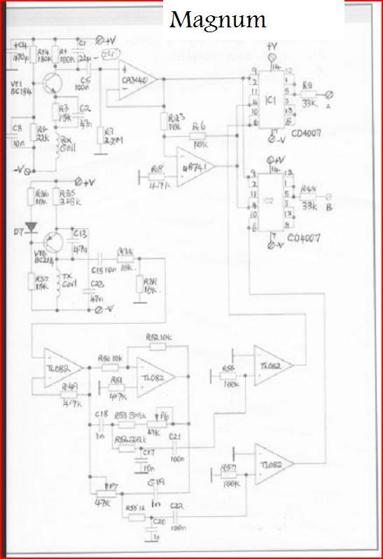

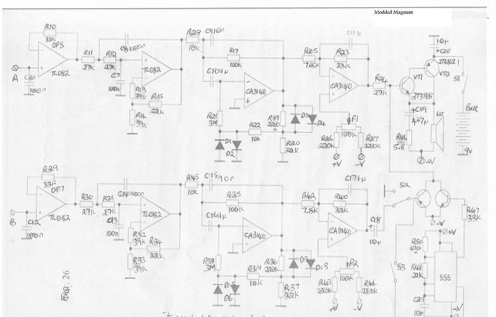

                    What I wanted to do though was use a low tone to identify iron and a high tone to identify good metals. I may try to put a meter in the circuit instead- needle left for iron and right for good metals. I've been studying a circuit diagram of the 1980s Magnum and also the Bulgarian mods that were made to it a couple of years ago. If I find that the circuit is similar to the Blisstool in any way once I've traced out that circuit, then it should help me to find out where to connect a meter like the original Magnum had or help me to work out how to fit a two tone ID mod as I originally intended- whichever is the easier. I'm hoping that the Magnum circuit will identify all the ICs as their identification numbers have been sanded out inside the Blisstools.

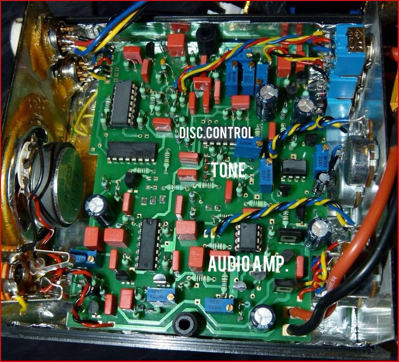

                      If its any help. The Blisstool got a power supply runing 5.50 volt and 11.00 volt, made at the 8 pin IC in the middle of the Board close to all the pot. If that allso can be found at your scematic, it could be (allmust) the same.
                      If you want a meter at your Blisstool, it could be made... But its a signal and not DC when tone breaks up (iron). Your therefore need a LM 741 or similar IC to amplifirer up the signal and then you can work with a meter.. Remember I made a VU meter a my Blisstool and that was made like this.

                        Thanks again Henrik, I do remember that you made a meter for the Blisstool but the video of it no longer exists. Also, I couldn't find any details about what you did and you said the VDU was difficult to see in the sunshine anyway. I intend using one of the big old meters out of an old C-Scope for my project. You were disappointed that your VDU didn't respond to deep "iffy" targets but this happens with nearly all detectors doesn't it- the discrimination circuit being weaker than the all metal circuit. On the Magnum, Andy Flind's article in the Electronics Magazine of 1981 which I've been reading on the web, gives further details about how to make the meter more sensitive by up to three times, so that should also help me.
